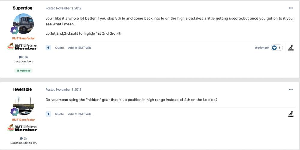

Ok I really don't mean to beat a dead horse here but I found this thread here: https://www.bigmacktrucks.com/topic/28092-t2090/
specifically this part: C1D89F5B-6525-4A8A-B54A-8CCE8B1E61DB.thumb.jpeg.044285a98eef289eaf9d5d29db88283a.jpeg
I know it's probably up to the whoever's paying for the transmission rebuild but it still makes me wonder which pattern is better for the transmission in the long run. If the old pattern transmission and the new pattern transmission are mechanically and internally the same than I'd say shift it in the new pattern If it goes smoother, 4th low always sucked to get into anyways.
