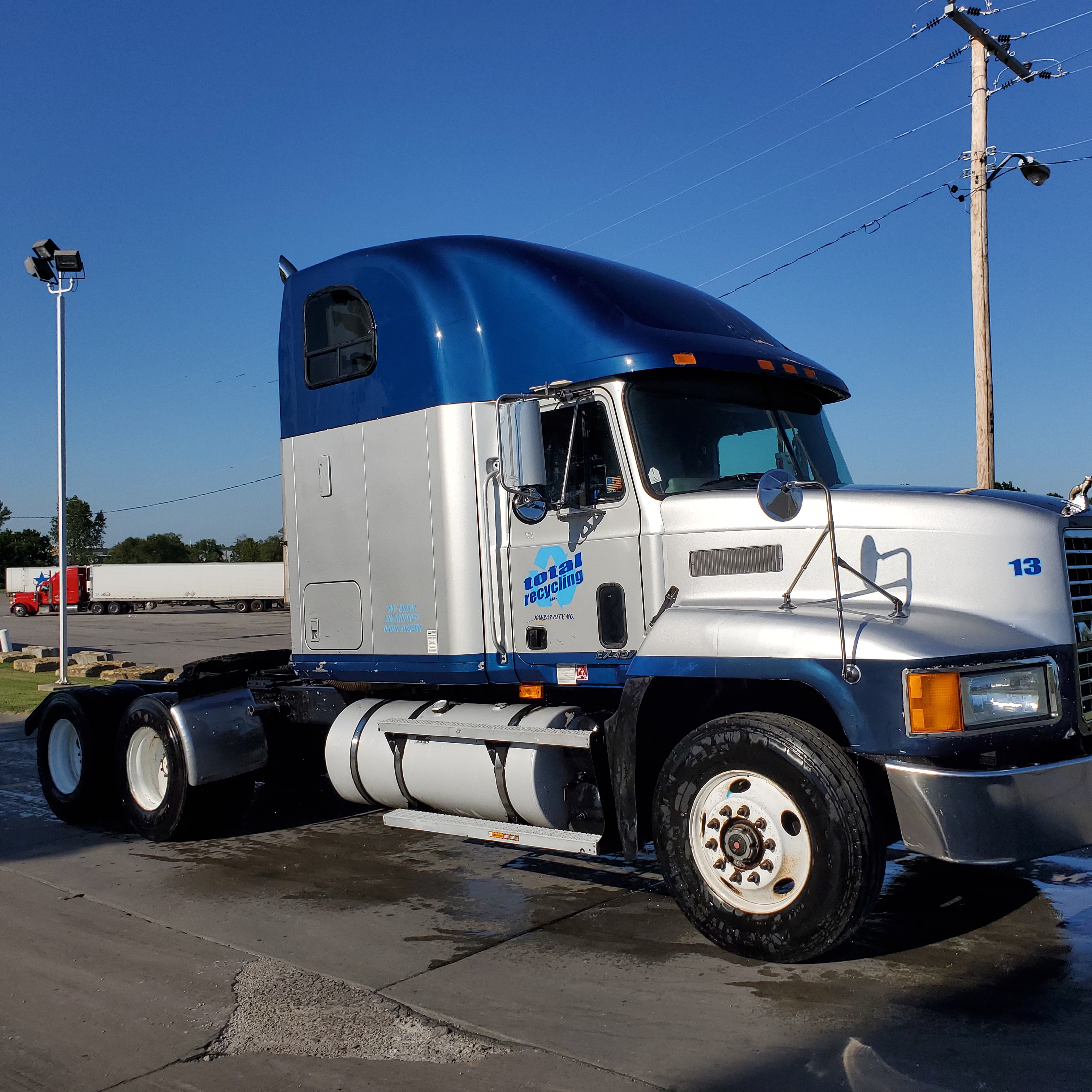

I have a 1997 mack ch613 e427 with a 18 speed and 3.86 gears
Vin 070097
I have had this truck for almost 3 years and it gets the job done but just has lack of power I'm used to I have to shift alot
We have just did a head job,head gasket, water pump,oil cooler ,all new fuel lines, new exhaust. I was hoping it would of helped but it did not.
Any help would be appreciated
Thanks wayne

WELCOME TO THE  ELECTRONIC E7..  they just lack power and are sleepy. you will need injector upgrades and possibly a ECM tune to get them to wake up and run like they should. I have only driven one E7 that performed well in stock form and I dont know why it was better than the other 10 I have driven
