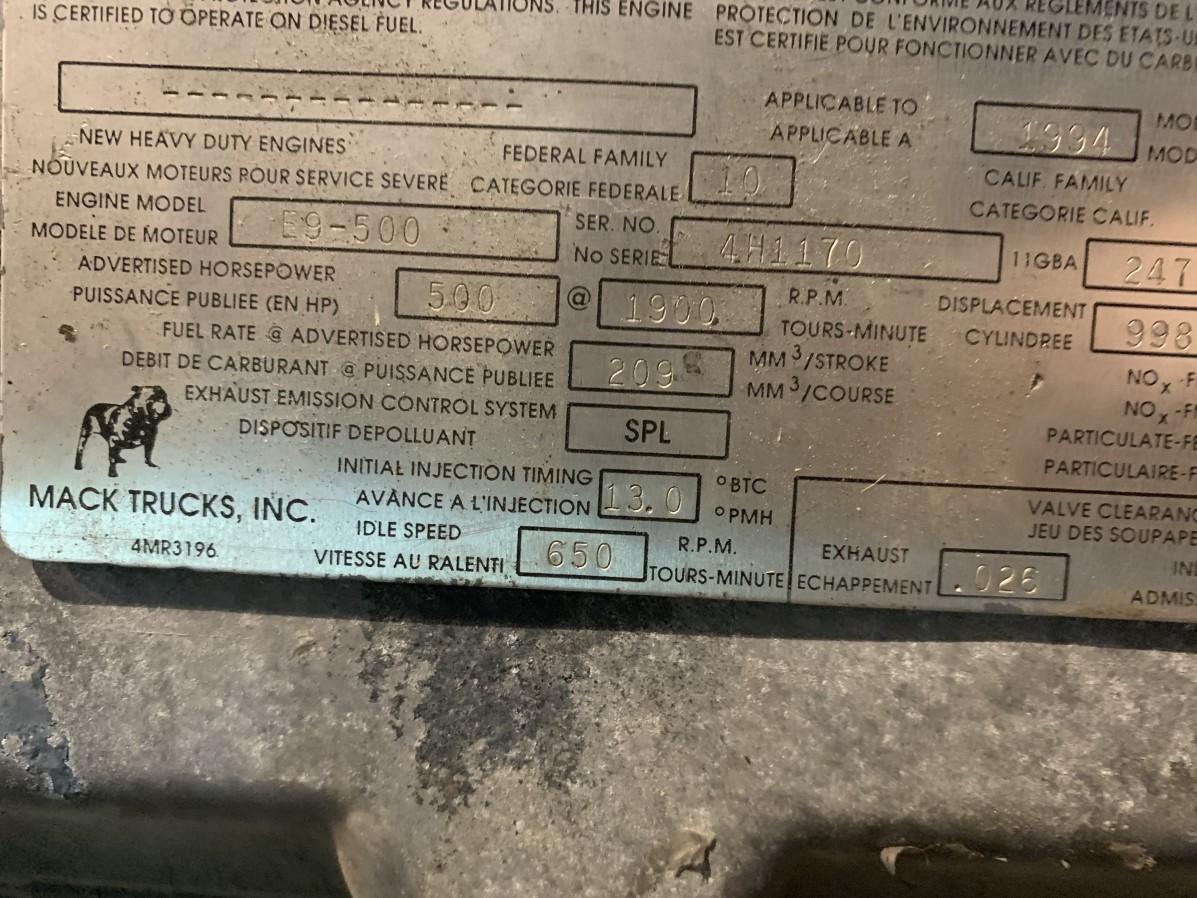

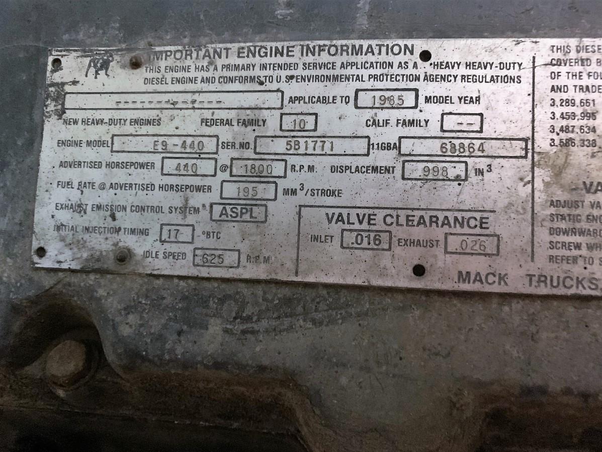

You are right on with the RPM's there is a difference which I did not realize until now. These are the tags of the two different pump engines. Timing is different by 5 degrees as well. I do run the inline pump with a few more degrees timing than tagged and it does run stronger.
Optimized-Vpump.thumb.JPG.4d934f80f628f65d5f8cd6ee621f6348.JPGOptimized-Inline.thumb.JPG.8dd5c40bd504ddad4d0dbea02131a1f5.JPG
