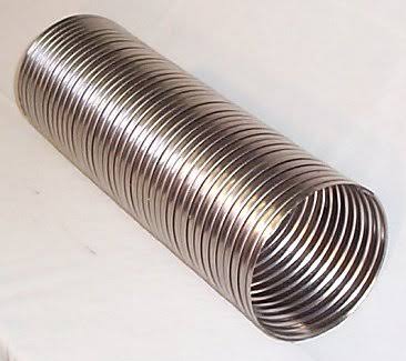

Right now however I have an issue. The same truck in the title, the flexpipe seems to have expanded from heat, and gotten damaged. I have the parts to fix damage... what is causing this??

If the flex pipe looks "expanded" or pushed out, it is most likely cause by excessive back pressure. Either the dpf is plugged or the cataylist is plugged or both.  You need to find out why this happened. A face plugged cataylist is usually caused by a poor flowing 7th injector.

Being a CXU chassis and a 2008 model, this chassis is equipped with a dpf unit. The service bulletin addresses alignment issues of the flex pipe and proper repair. The customer complaint is expansion of the flex pipe. The only thing that comes to mind, for me, is excessive back pressure. Not meaning any disrespect, just saying.
