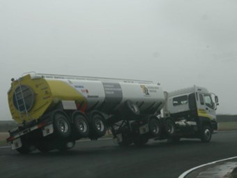

Smart truck and dumb trailers
The truck might have stability control, and the trailer might have TEBS (trailer electronic braking system) with roll stability, which would give the combination the top rating for both braking and roll stability.
But if the operator doesn’t plug in the power, it’s a dumb trailer.
Loose adds that with longer combinations you have to make sure the power goes right down to the back end -- at least 9 or 10 volts at the last control unit. "Without electrical grunt it’s (also) a dumb trailer."
And don’t try to stick a 24 volt lead into a 12 volt ABS system: "That will blow it up."
The tables apply equally to trailers attached by both fifth wheels or drawbars. However truck and dogs are inherently more unstable than semitrailers or B doubles.
Semis are connected by the fifth wheel, and are therefore roll-coupled. "A truck and trailer will tend to roll together," says Loose. "There is a link, so stability system on one of those units will help understand what’s going on with the other unit.
"With drawbar units though, between a dog trailer and a rigid or another trailer, they’re not roll-coupled, so one can roll independently of the other."
Loose adds that there are lots of different warning signs that there’s a brake compatibility problem, for example uneven brake wear; different brake temperatures; and wear on the kingpin.

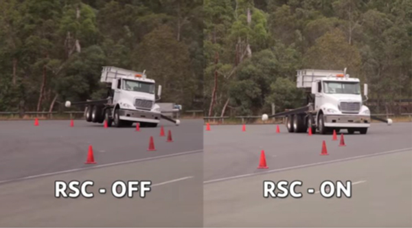

As far as the ATA is concerned, the jury is no longer out on electronic stability control (ESC): it’s a great and proven life-saving technology.
ESC automatically slows the vehicle down via both the throttle and brakes if it senses the risk of a rollover.
The ATA points to a Monash University Accident Research Centre study from a couple of years ago which concluded that mandated ESC in heavy vehicles could reduce fatal heavy vehicle crashes by 4 per cent.

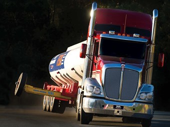

Ironically, there may be a safety problem with the latest technology, if there is incompatibility between truck and trailer braking systems.
If the truck has a "smart" brake system with ABS and better still EBS as well, and the trailer or trailers are "dumb", that can create a safety issue in itself.
The most obvious example is stamping on the brakes in an emergency: the trailers may not stop as well as the truck, thereby risking a jack-knife situation.
