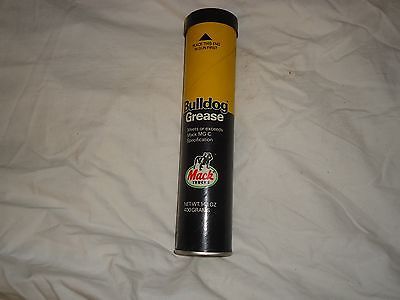

 I would ask your MACK guy for confirmation for your application, but the Gabrielli Mack parts dept said this is what is called out in the MACK TS-494 Service Bulletin,  MACK Bulldog Grease Part Number 9853 . $6 a tube.
