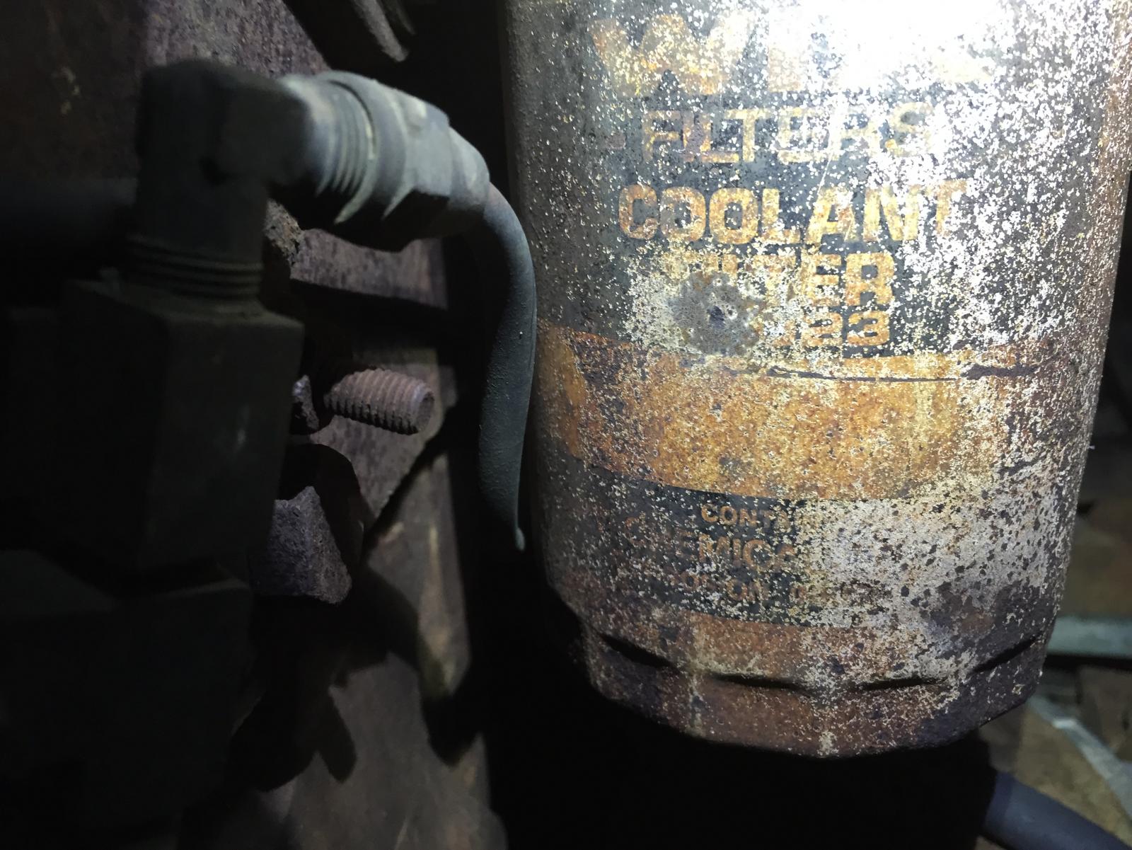

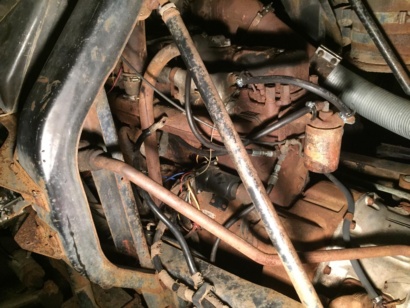

I am having issues finding a replacement coolant filter for my 237. The one that came off it is to rusted to see any part numbers. The issue is I tried the Mack 25MF435B (WIX 24428) which has smaller threads than the WIX 24429 yet the threaded hole is still to large.
Was there an even smaller threaded coolant filter for some of these engines? If so anyone have a part number?
Thanks

That is what I am working on but my parts stores are not the greatest.
