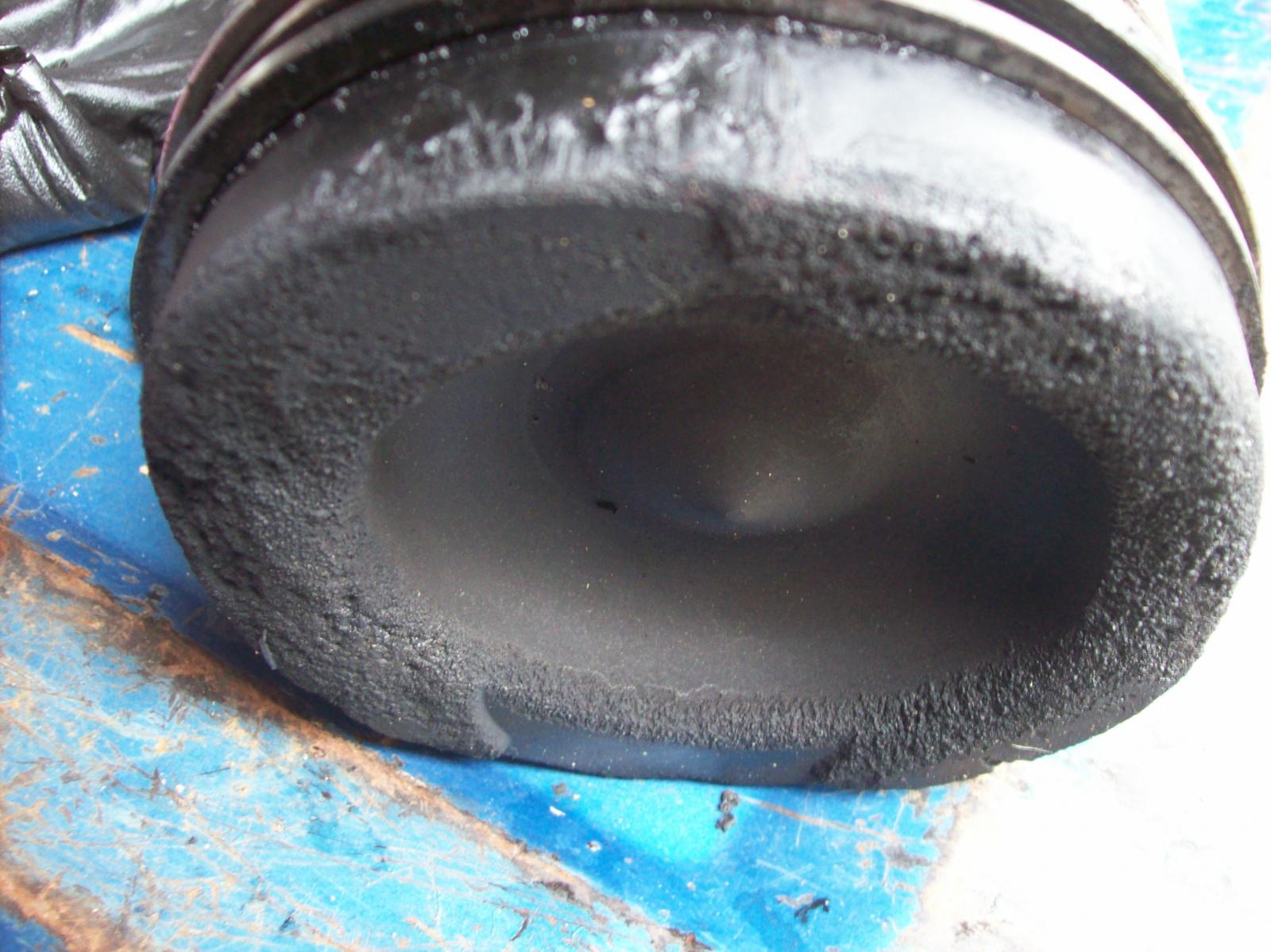

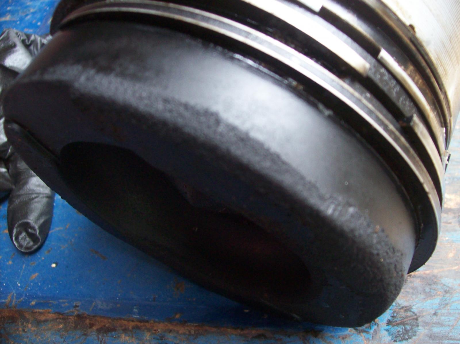

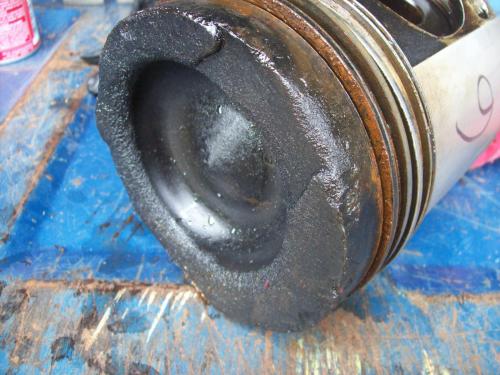

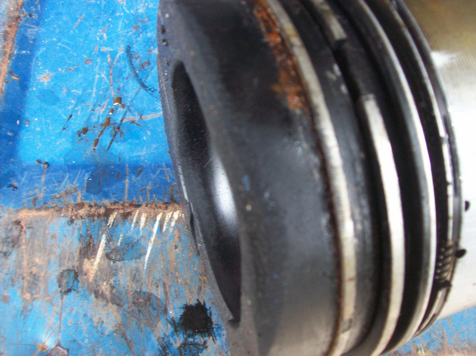

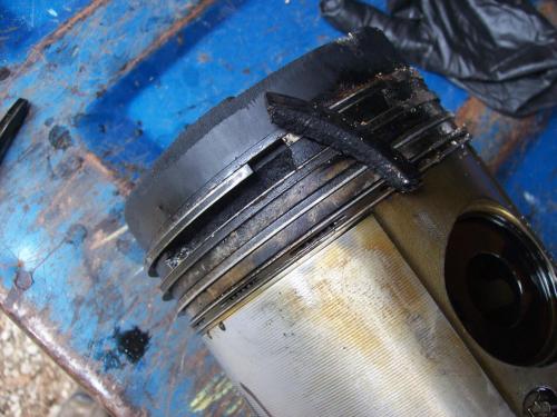

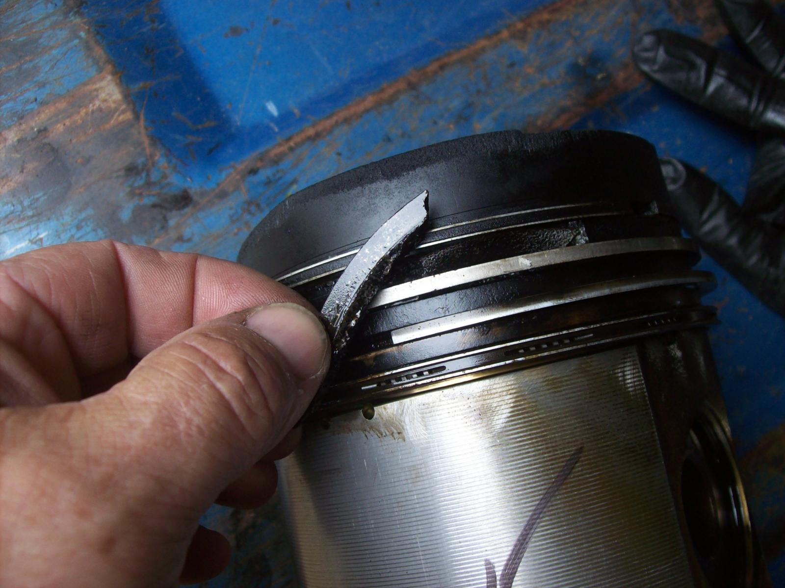

Had my friend come over from work yesterday he is our head mechanic at work and rebuilds all our mack engines said the engine needed new liners he has a liner puller so that's going to make things easier he says they are to scored to save. The pistons had a weird burn pattern on them he says the engine was way over fueled we are going to turn the pump down after the rebuild going to pull the rod bearing caps today hope better news comes from what I see there with the bearings.

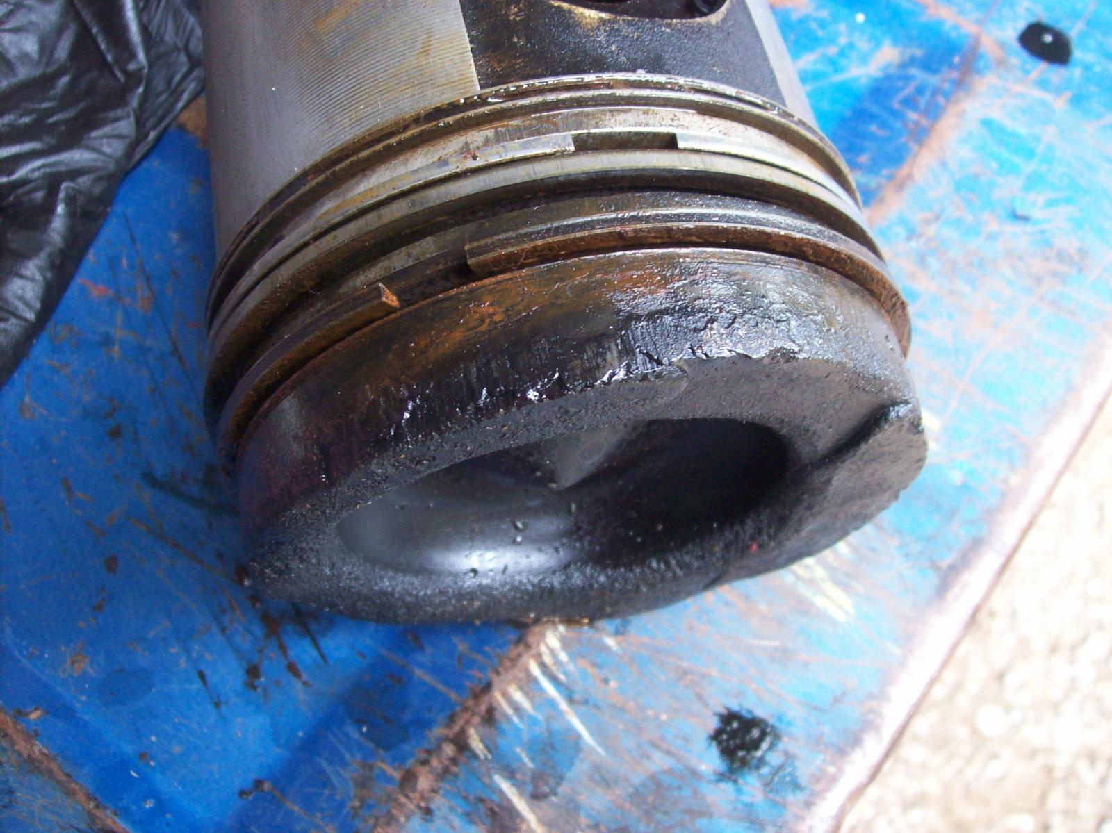

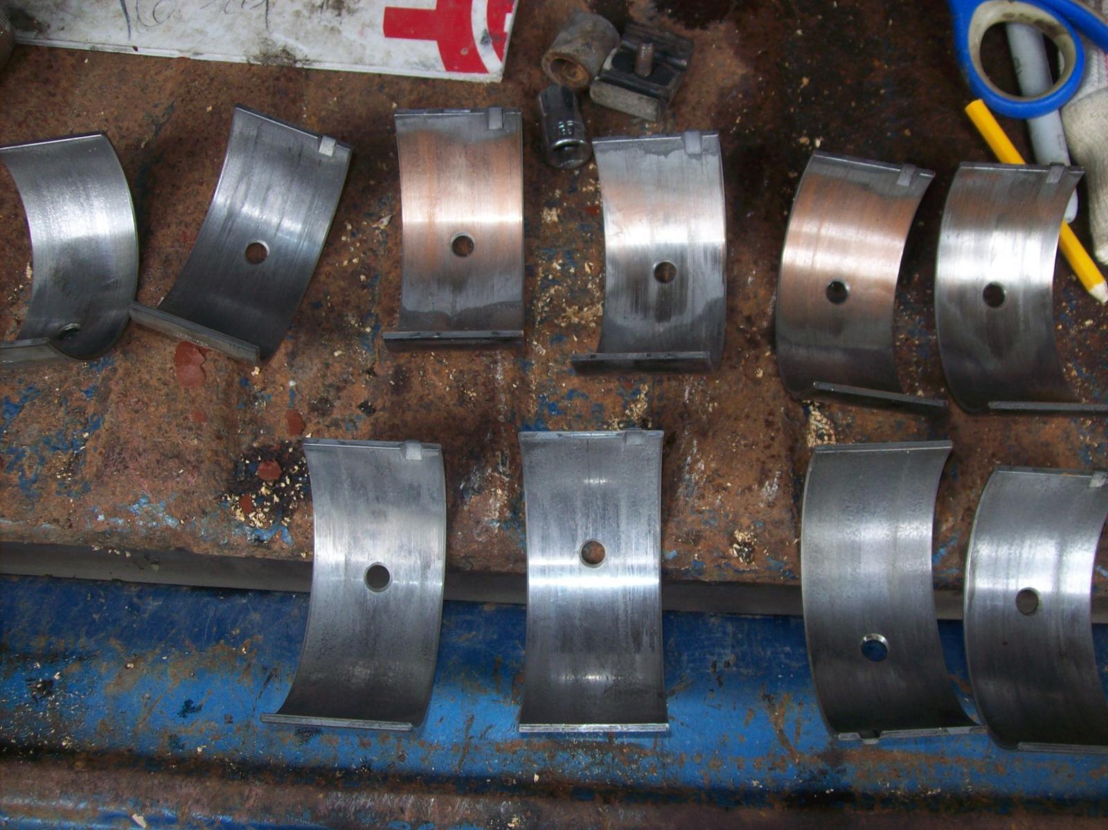

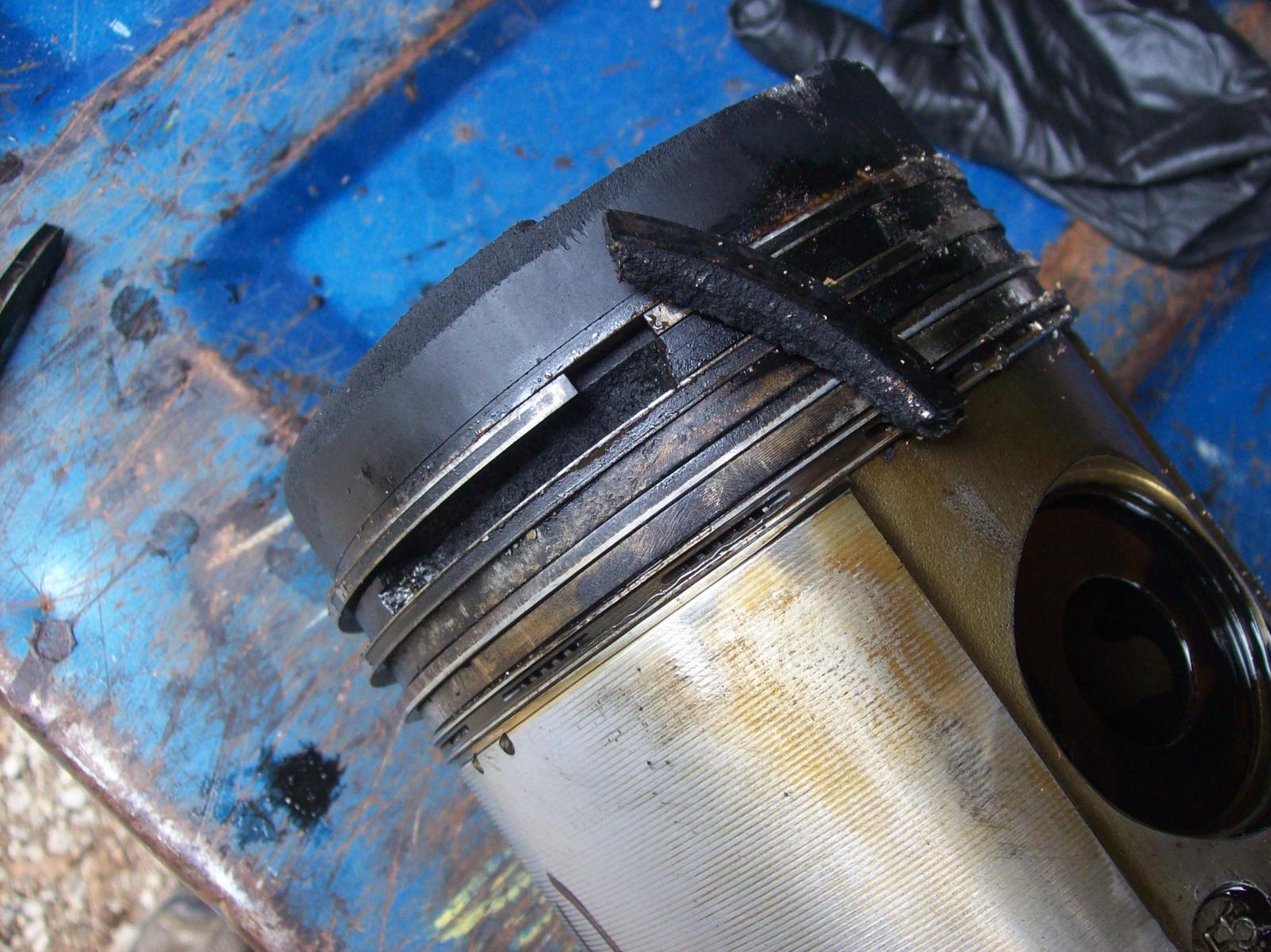

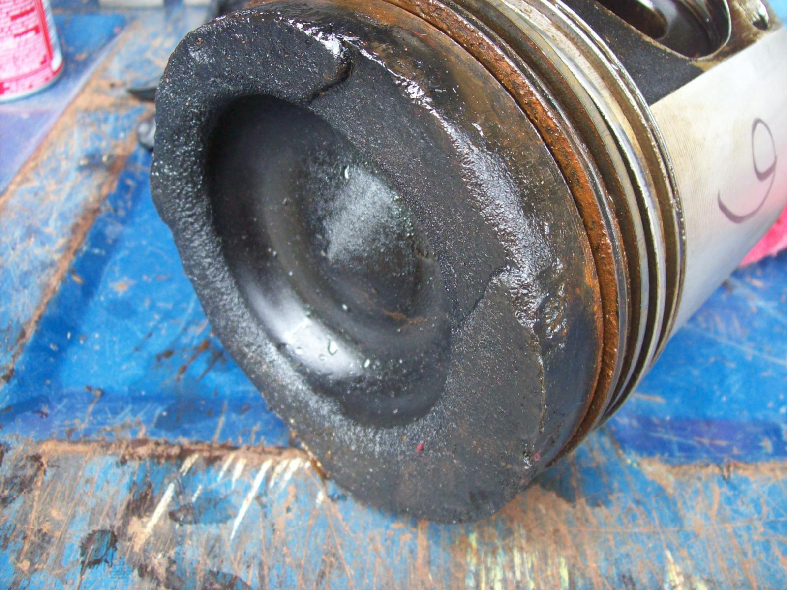

Heres pics of the carnage Im in for lunch now I have #3 piston to pull yet the rest are out and sitting in the garage they look like they have been sandblasted those broken pieces are the piston itself between the rings the #6 liner came out when I pushed the piston out. The bearings don't look too bad the ones showing copper are the #1 and #2 rod bearings tomorrow after work Im going to pull some of the main caps and see how the bearings are there.
