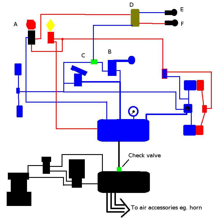

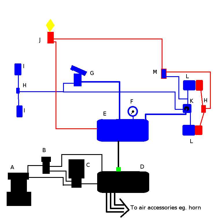

Ok diagram time!
This is a very basic single circuit air brake diagram for a 2 axle strait truck. The single circuit was replaced by a dual circuit system back around 1978-1980.
A) Air compressor
B ) Governor
C) Air dryer (may or may not be present on your truck or plumbed the same)
D) Wet tank. This is the primary air storage tank that supplies accessories (air wipers, suspension, seat, horn etc.) and the brake system.
E) Brake tank. stors air for the brake system. proteced from the wet tank by a check valve so a badly leaking accessory line wont drain the brake tank.
F) Pressure gauge in the cab to monitor system pressure.
G) Foot valve, single circuit type.
H) quick release valves are usually found mounted right to the axle and exhaust the air pressure close to the chambers to improve brake response.
I) front brake chambers
J) Parking dash valve
K) relay valve. This allows the rear brakes to respond quicker to the foot valve. The controll port just meters air pressure from the brake tank to the rear brake chambers.
L) Rear brake chambers. Blue is the normal service chamber and red is the spring emergency/parking chamber.
M) Inversion valve or anti compunding valve. Prevents the release of the spring chambers when your foot is on the brake pedal to avoid damage to the brake chambers.
Ok now to add a trailer you need to make the following connections:
A) Trailer air supply dash valve.
B ) Trolly Valve
C) Three way check valve. Prevents the trolly valve from applying the tractors brakes while allowing the tractor to controll both.
D) Tractor protection valve. A simple valve that uses the emergency supply pressure to hold the service line open. In the event of a leak or break away the tractos brakes are isolated to prevent loss of brakes.
E) Service line and glad hand for trailer
F) Emergency/supply line and glad hand for trailer
Now this is a very simple setup and your trucks system can vary but this is a good guideline. Find an open port on your brake tank, tap a line off the foot valve delivery port and a line off the delivery port off the parking dash valve and you are set. Then some simple plumbing and you have trailer air lines!
Like freightrain said use the plastic DOT rated tubing. You can get valves with quick connect ports that the tubing just slides and locks into. No hose barbs or clamps to futz with. You can buy it online from Mcmaster Carr and they also have tube to pipe adaptors so you can hook into your existing system. Just type DOT into the search.
Any further questions, let us know.
-Thad
What America needs is less bull and more Bulldog!
