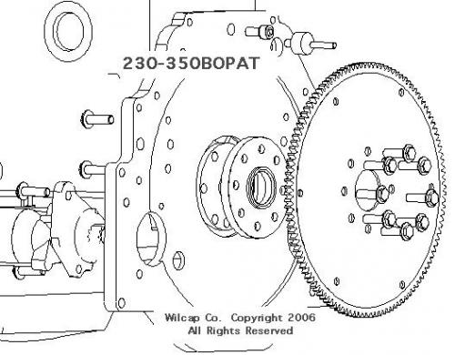

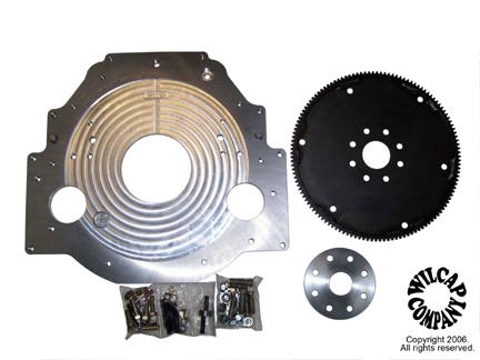

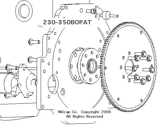

Chrysler, Dodge, Desoto & Plymouth Flathead 6 & 8 Cylinder Engine to Transmission Adapters
218, 230 ,250, CHRYSLER DODGE DESOTO TO CHEVROLET / GM AUTOMATIC TRANSMISSIONS, TH350, TH400, TH700R4 (over drive), L460 and L480 ( heavy duty overdrive light truck)
230-350AT to Chevrolet Auto Trans with Chevrolet Bolt Pattern
230-350BOPAT to GM Auto with Cherolet, BOP (buick, olds, pontiac), or Uni-Case Bolt Pattern
post-3242-0-13438300-1392513639_thumb.jp

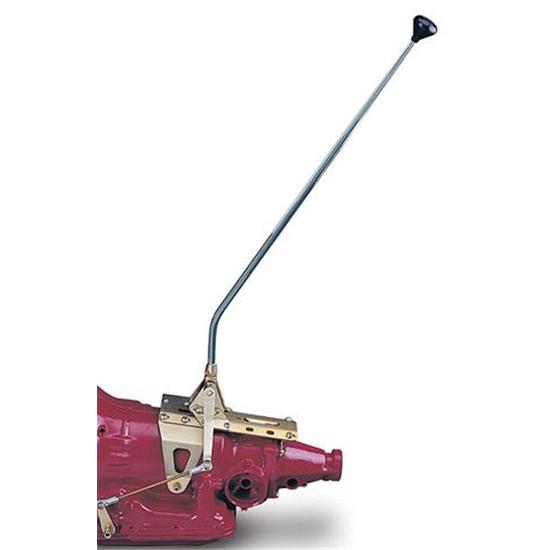

Forgot to add, TheTH400 (Turbo Hydromatic) is probably the most inexpensive way to go but limits highway usage. The L480 is the same in the GM family pick ups and such but a unit is in the $2000 plus price range and needs a stand alone control module for it. Lokar shifter similar to what the truck has about $200 to 300., Trans cross member $35 to $55. trans cooler $25 to $50.. Drive shaft modified to GM yoke depends on one piece or two piece shaft and what trans is chosen. Misc cooler lines and fitting probably under $100. rest it time and labor.
Here is an example of the LOKAR Shifter. Looks almost factory.
post-3242-0-34662800-1392522941_thumb.jp
