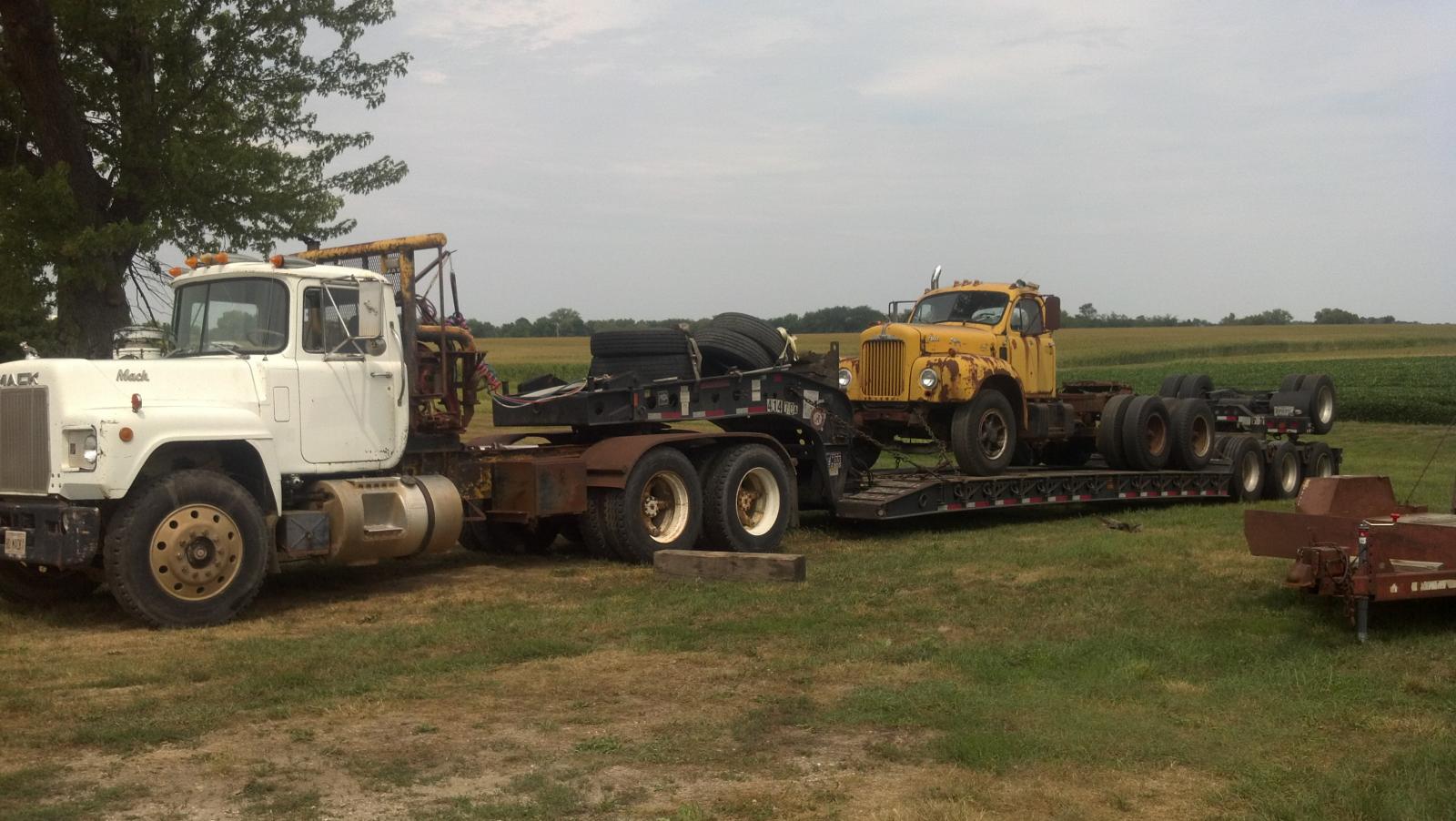

Nice buy now you just need a lowboy with an old B model on it and you can head to a show.
We have been cleaning, pinstriping, detailing and adding a few things the past 2 days. Dropped it off tonight to have the tanks, wheels and battery box polished. Decals will be in Tuesday and then we're ready to work. This truck is absolutely amazing and well cared for.
that trailer would do it now go find an M35 to haul around and you can have the Mack tri fecta.
