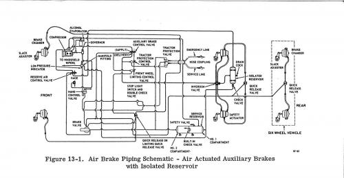

I am getting ready to run new air lines on my B753 which I ripped out to do a complete restoration. Now I need to figure out where to plumb all the air lines, including all the stuff under the dash, i.e. windshield wiper, front air brake, trailer brake, etc. Where can I find a good schematic diagram that will show me how to plumb these lines. I was really surprised that the windshield wiper motor had like 4 or 5 air lines going in and out of it.
Thanks, Dennis
Thanks for the help and the diagram, guys. It's a start. I should have made out a sketch when I was taking it all apart, but I thought there would have been a schematic out there. Live and learn, I guess.
I wish I had something like that for a Superliner. The diagram for the B Model has lots of differences compared to the one from Bendix - they differ by decades, and besides, Mack always likes to do things a little different!
