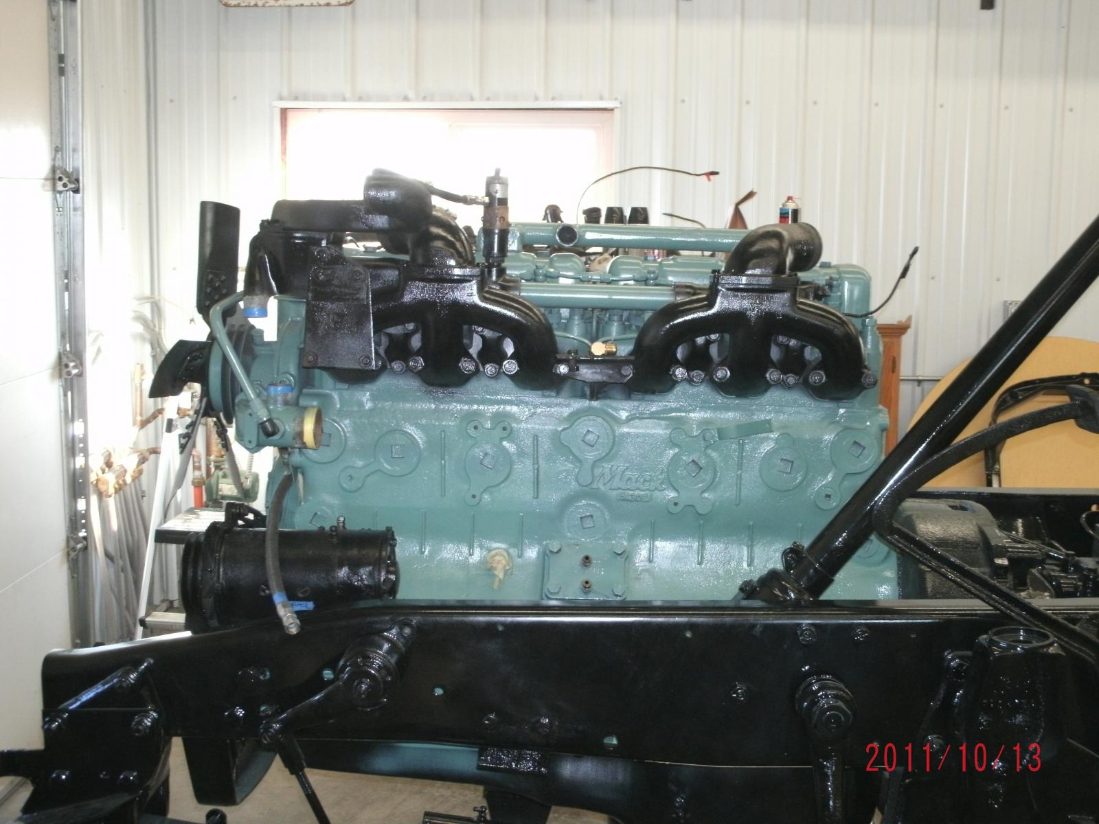

Nice looking motor. Wish mine didn't have the color "grudge" all over it LOL!
Get in contact with Phil and have him try to find another set up like I got. Mine didn't have the oil cooler either, as that makes a difference also. He found mine on an old R model with a 711 in it. If you do it, get the road draft tube that goes with that filter set up. I had to refab the mount on mine(down on the oil pan) to get it out of the way of the filters. No biggie, but I should have gotten the tube off the 711 and it likely would have made it fit correctly.
