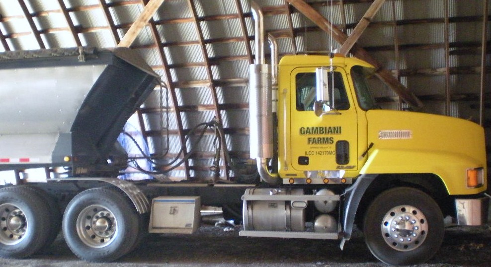

Is there a general rule of thumb for slack to allow on the hydraulic lines coming from the truck?
More is better than less, depending on how you have all your air lines set up and what not... Here's a picture of mine, but with a dump trailer. You should be able to see how it is and there's more than enough slack.
I appreciate it. Once I got my thoughts together, I realized it shouldn't be to bad. I just got to figure out what I need to add the two lines to the pump itself. Looks like I'm rained out tomorrow so I'm gona take a closer look.
