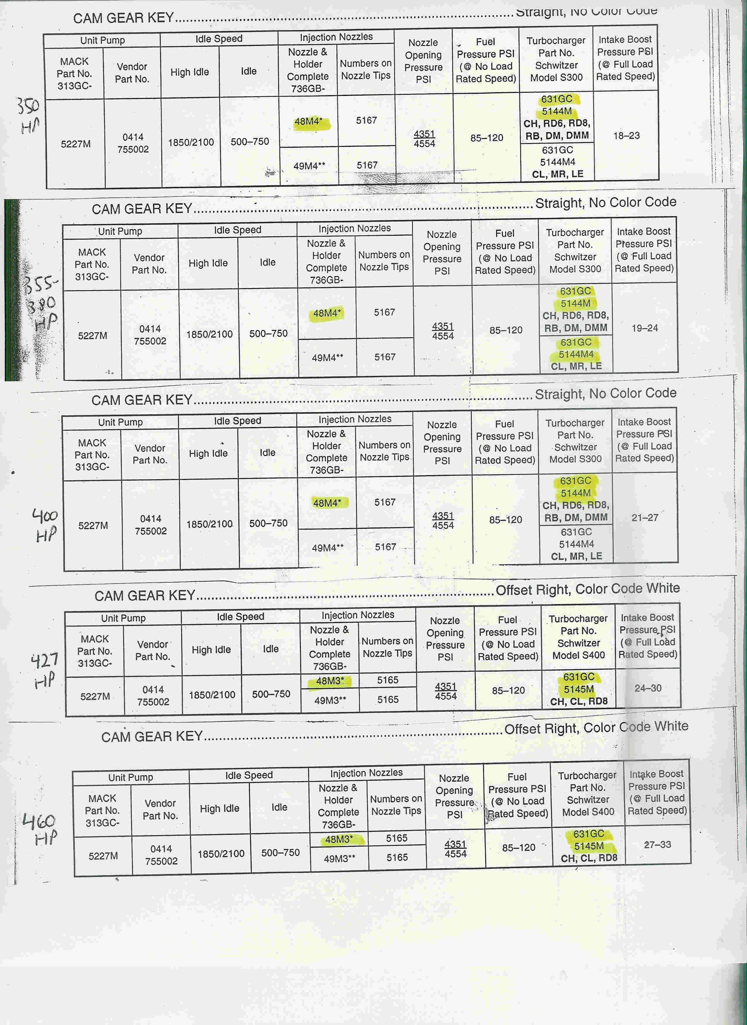

Your truck needs the turbo, injectors, download and the cam gear key way changed. Its ashame as you just had your cam out and they could have cahnged the key way and bumped the HP to 460. Here is a chart I made for the ETECH only engines showing the difference in engine parts per HP. I have different list for the CCRS style ETECH and the ASET-AC and AI versions.

When I pulled your truck up in the Mack parts system it said it had be converted to a 400 HP. I then went to the software/engine site and found it was still a 355/380. Which is good because the 355/380 puts out 1560 ft lbs of torque (same as a 427), the 400HP puts out 1460 ft lbs of torque. If I was going to change I would go to a 460 and get the 1660 ft lbs.

Yours was built on 1/16/2001 and is a regular ETECH engine , same as engine above, requring turbo, injectors and off set cam keyway. My hope was yours being built in 2001 was a CCRS style engine that requires no cam keyway change regardless of HP level. If it was a CCRS ETECH it would be cheaper to bump up due to no keyway change. As with all HP upgrades on ETECHs make sure you have the big vibration damper on, if not get one. You can tell if you got the big one by it almost touches the front motor mount horseshoe. On the small damper you can fit your fingers between the damper and mount.

A regular ETECH has a plastic fuel return hose coming off the front or back (mostly front) of the head going to the fuel pressure regulator on the passenger side of the block above the air compressor. The CCRS has no plastic line. The ASET AC and AI engines also dont have the line.

The injectors are $181 each and the Mack turbo is around $2100. I think a turbo shop could build one cheaper though. The labor to change the cam keyway is what is the killer. About 16+ hrs to change the keyway. If we were to do the whole conversion in our shop it would be over $5000.

Injector # 736GB415M2X (X means reman). Turbo # 631GC5173AMX (of course X means reman as well). The orignal 460 HP turbos were around $800-900 but the newer models have a super hard titanium impeller wheel. Most turbo shops can build the same thing with out the titanium wheel for a whole lot less. The camshaft has to come out and the cam gear pressed off and a off set keyway installed to retard the timing to prevent overheating in the summer. If you had a CL with the huge radiator you might get buy without the keyway change. We tried it with a RD and a CX and was ok in the winter but when the summer came they overheated.

Yes , there is a data file for the engine ECM that Mack turns on and the dealer programs it into the truck. Since your truck is a regular ETECH 355-380. I have some info for ya here in a bit.
One of my friends owns a early CV with a regular ETECH 400HP. His friend bought a CV as well with a 427HP. Now my buddy wants his 400 bumped up but like you he doesnt want to pull the cam and go through all that cost. So I called http://www.rochesterfuel.com/products/performance-mack-c-23_67.html and talked to them, they were very helpful and the guy I talked to really knew his stuff. (their injectors are alot cheaper than the Mack remans)I had my buddy give them a call but he hasn't decided what to do yet. Maybe a set of stage II injectors might be all you need. I also posted this, however it only applies to 427 CCRS engines, just in case anyone out there has a weak 427 CCRS. Here's a little tip for 427 CCRS engines with low power. We bought a fleet of 2002 CH's with this engine and all were low on boost pressure and power. We changed turbo and injectors, adjusted valves and did everything we could think of and still low turbo boost/ power. I called my buddy at our other Mack location and he said to replaced the injectors with 460P (736GB420M3X) ones and call Mack and have them turn on engine datafile 1MS5135. We did this and WOW what a difference, went from 22psi boost to 30 psi and this was after we put the old turbo back on. Just something I thought I would pass on to you guys. One of our customers bought one of these trucks and fixed it himself (I first put a 460HP datafile in it )but he had some bigger injectors buit and put on a 500HP Detroit Diesel 60 series turbo on and says it will scream, I have seen it in action and it seems to really get up and go.
