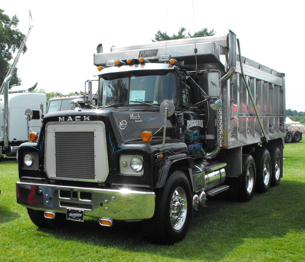

square headlights in R models?
krismoriah replied to krismoriah's topic in Exterior, Cab, Accessories and Detailing
No kits that i know of. The owner of the pics that I posted said that they are headlights from a T800 kenworth...but you can use freightliner or w900 or some western star setups. I just got two complete assemblys from a junkyard for $50, I have to fabricate a new metal piece for the background, probably going to use diamond plate. Should be easy to do, only a few hours or cutting and mounting. -
