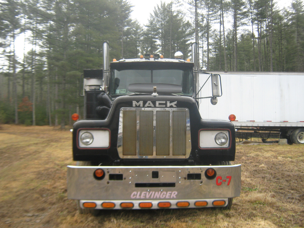

  4. just picked up an older r model and bringing it back to life. where to get a grille like this?
  5. anyone know who sells or where u can get a grille like this?

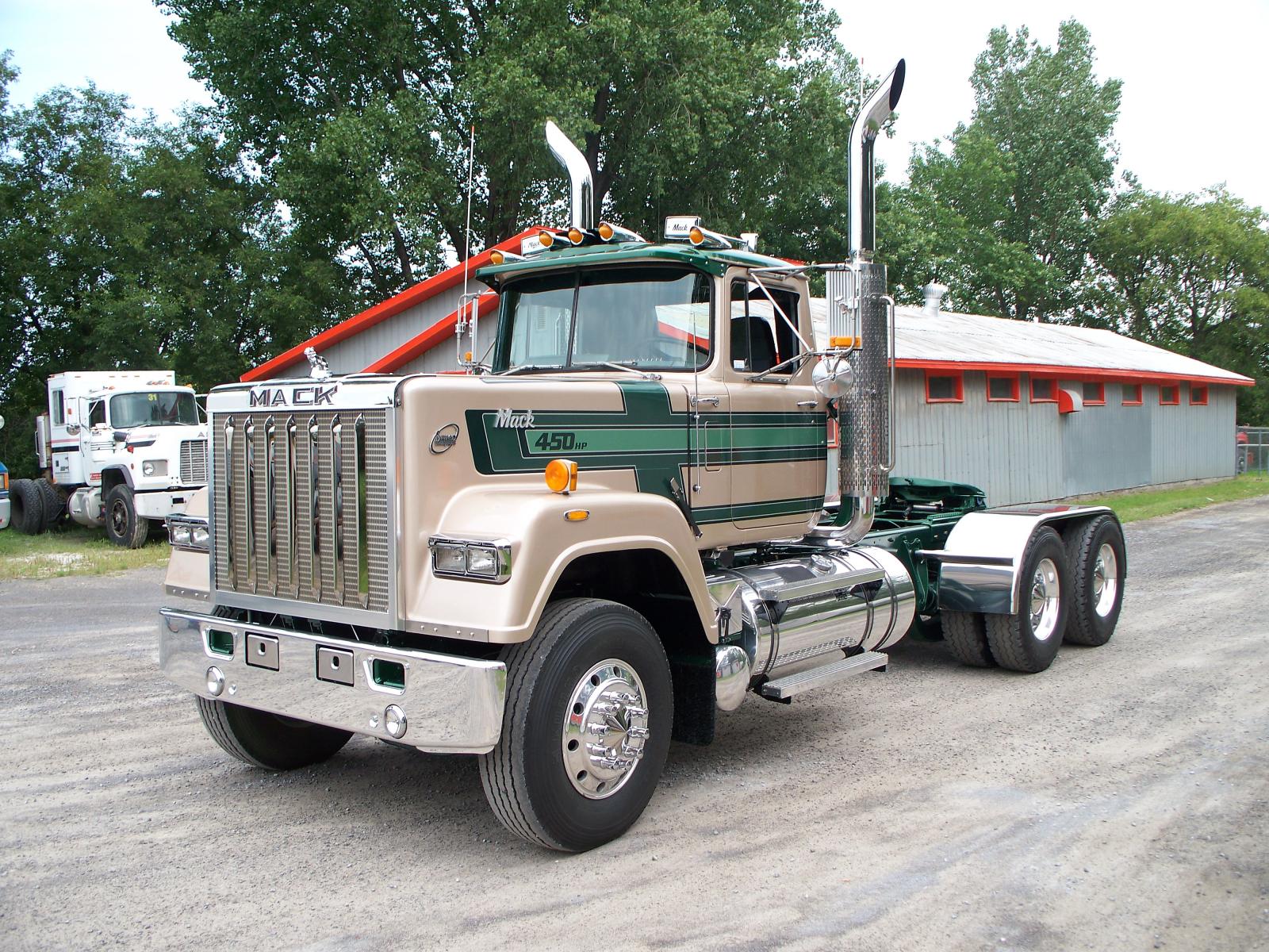

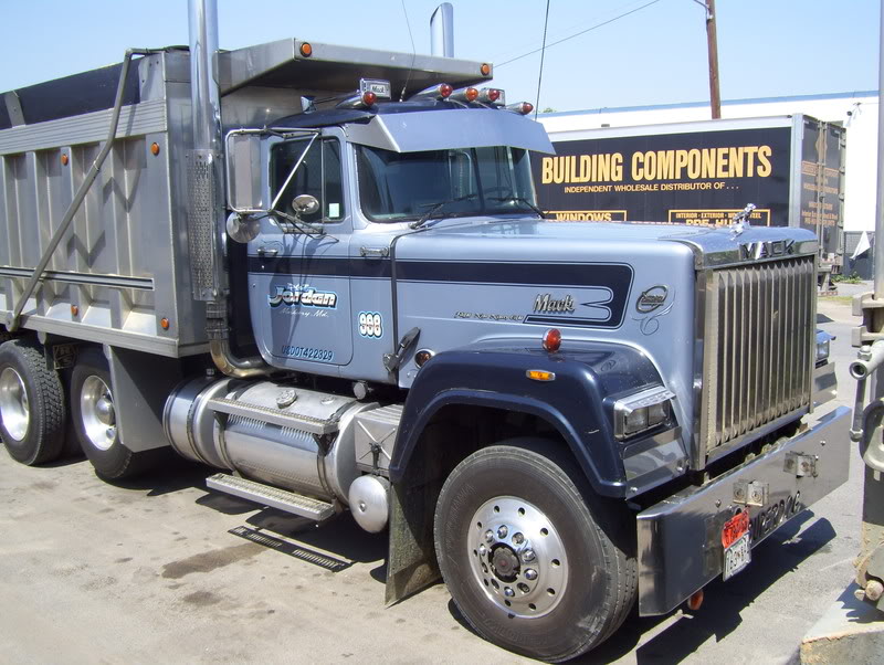

  11. definately R models..there are 4 that I have counted so far in my area 1 is a dump truck and 3 are hauling coal. I have a 1997 RD688 and know what those headlights look like..I see R models all the time with the single round bulb...but these look like the exact same hood except they have dual rectangular headlights like the superliner..so maybe the coal hauling guys upgraded to superliner headlights to make their trucks look cooler? They look great from the front...makes them not look as outdated I guess.
  12. I have noticed two older R model trucks here with square headlights they are twin headlights in place of the usual round one headlight..is this a particular model of truck that has this or is there a conversion kit? Looks like a r model with superliner headlights...but IDK..
