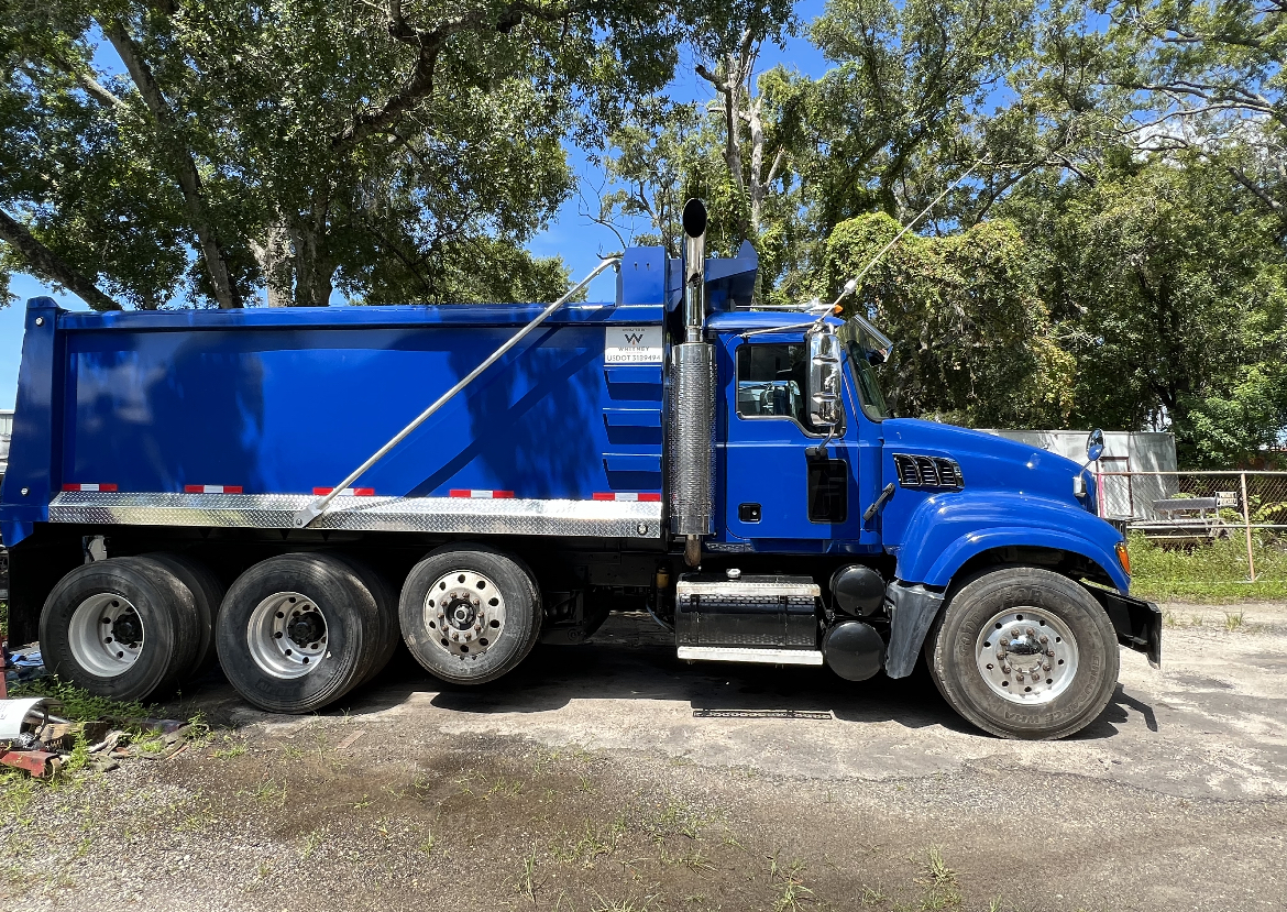

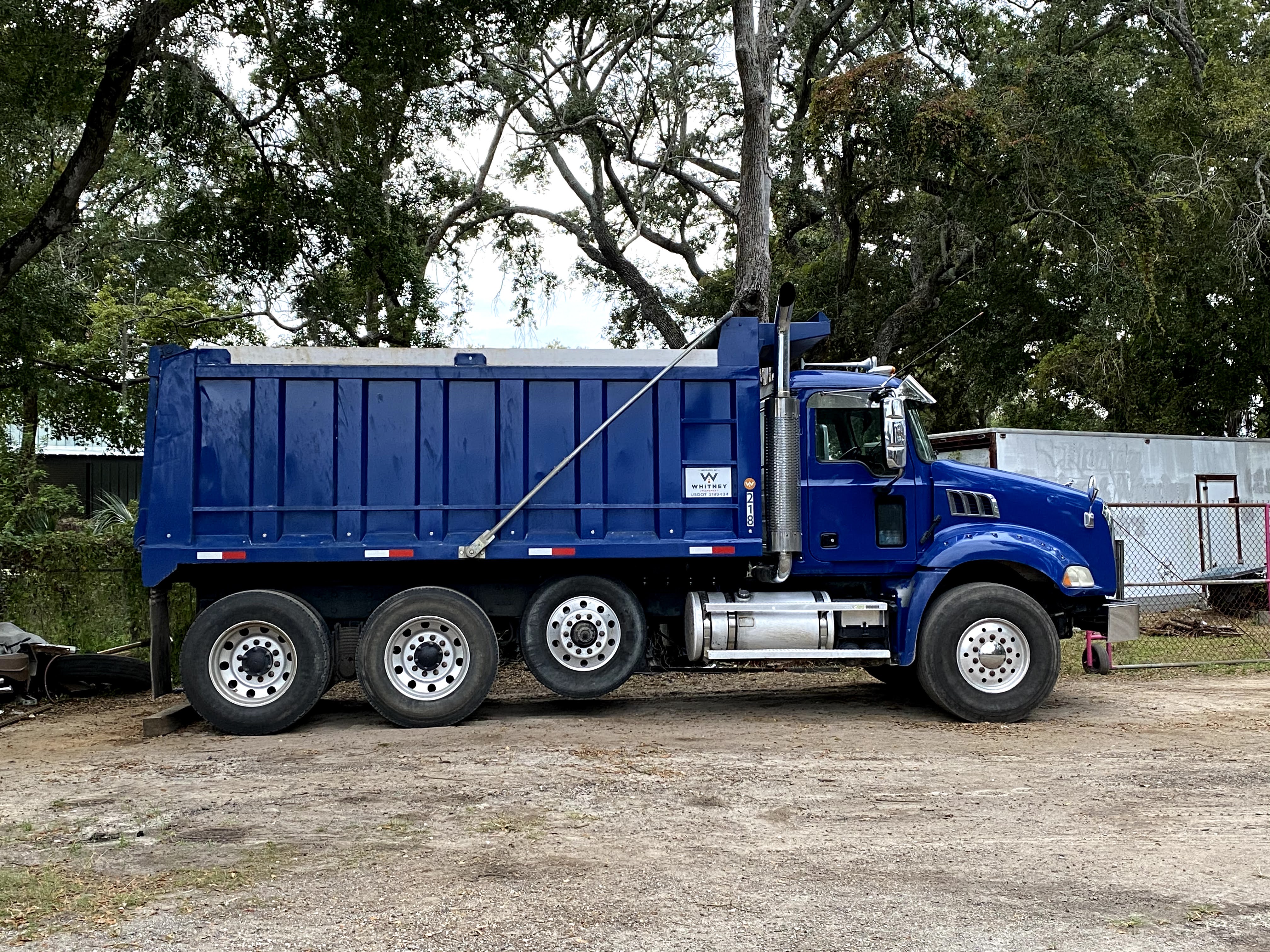

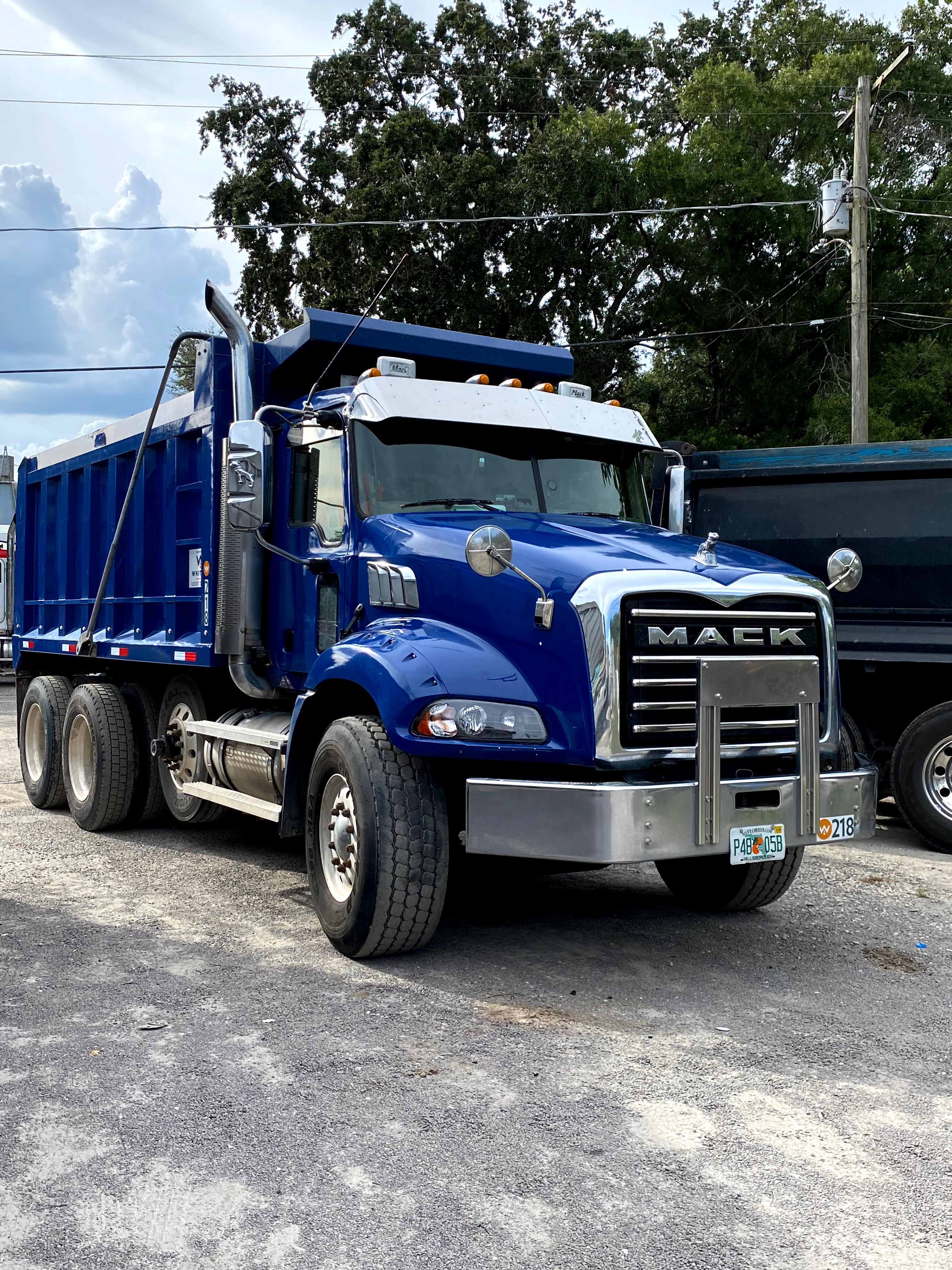

  10. Thanks for the response, I’ll look at those details this weekend. here are some pictures of the trucks
  11. All of my trucks do it, I don’t see many hired trucks with this issue. It’s worst when empty.
  12. I have several dump trucks (Granite E7 350/ EF 8LL/ 4.30 ratio/ Hendrickson suspension) and a couple of AI 400/ maxi torque T310/ 4.17 ratio/ camelback. I’m having trouble with my trucks getting stuck a lot, we are in Florida so the dirt here is sandy. When drivers go off road the trucks start bouncing as soon as it hits a soft spot and we watch other trucks go by without any issues. We have tried the mud and snow button (ATC) and the Off Road button, power divider. Tried driving in low gears, higher gears and the trucks still bounce like crazy like it’s trying to get traction but it can’t so all it does is hops until it gets traction again. I’ve asked drivers to just get pulled out by the dozer or loader as I’m afraid they will break something. I’m not sure what else to do so I’m coming on here to ask for your recommendations. What are we doing wrong? What can we do different to prevent the wheel hop or to get traction? Thanks
