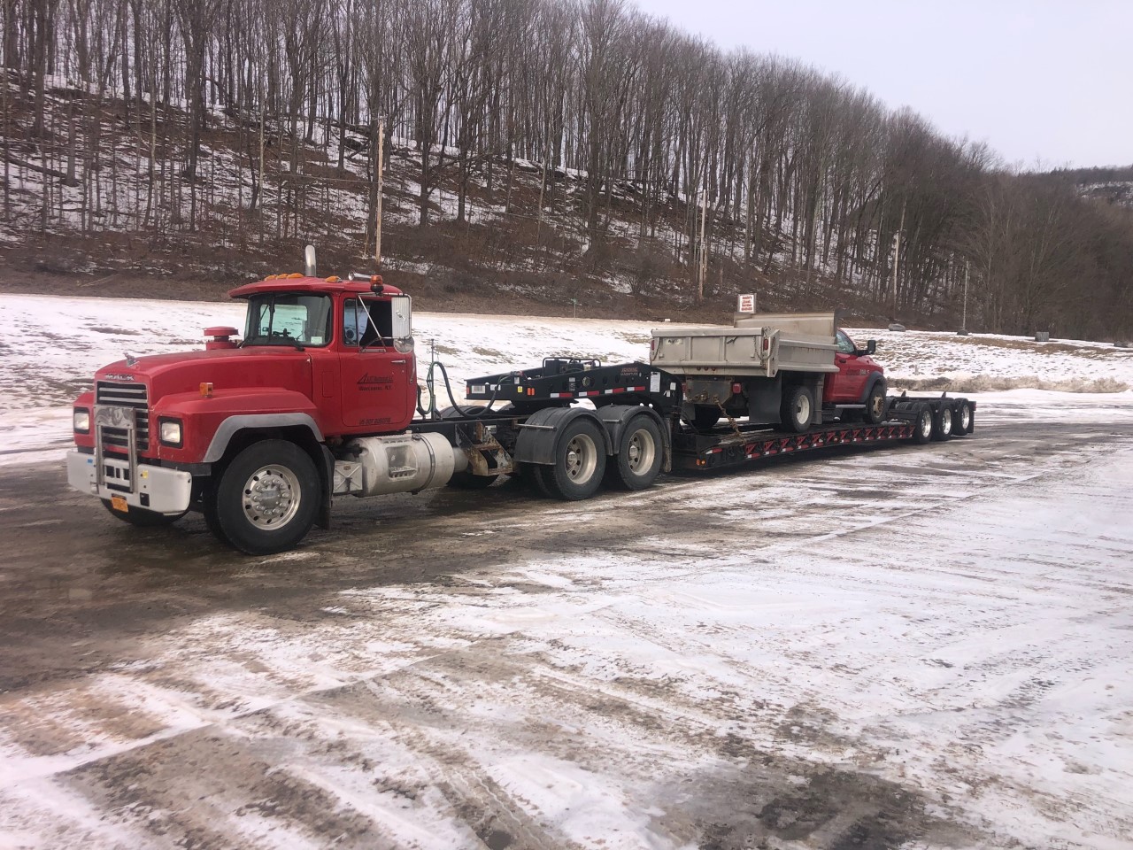

	Not much solar power this morning after last nights snow but plenty of Mack power. Truck and trailer get a FULL wash every time after running in the slop. 2000 RD 400 w/ stage 2 Rochester injectors 460 Turbo and ECM, Eaton 18. 2021 Fontaine Magnitude 55L.

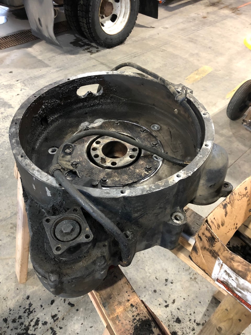

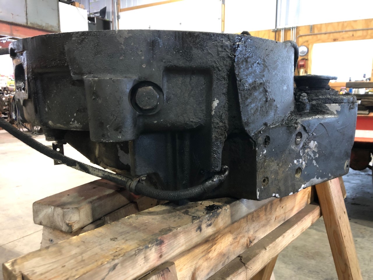

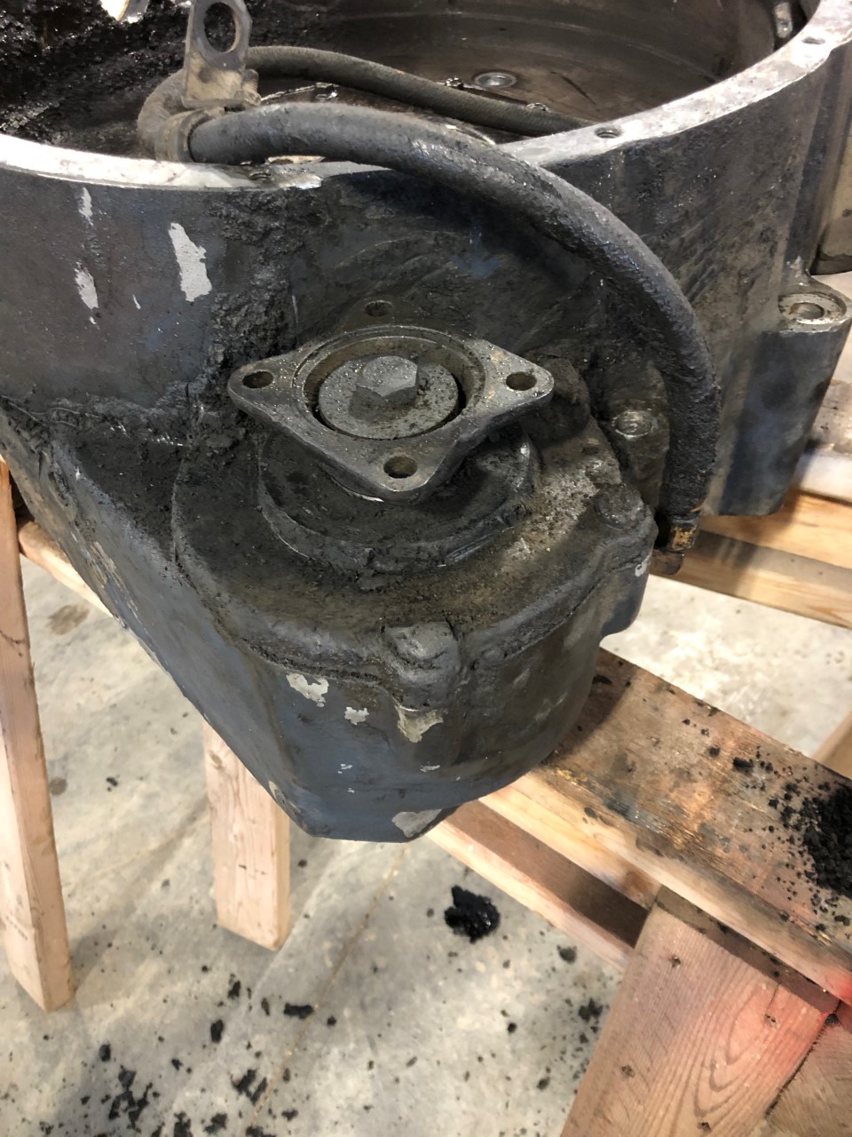

	I have done this a few times. Easy way is to get the vin of a similar truck that came from the factory with a 8ll, 13 or 18. Use that vin to verify and potentially source the correct transmission bell housing and or frame mounts for the Eaton going in. If I remember correctly the frame side mounts may be ok and the transmission bell housing mounts needs to be changed. You will need a bell housing for Mack that has the spot to bolt the mounts to. Drive shaft length will probably need to be modified. You may need a different top cover for the Eaton to get the shifting lever in the correct spot. You may need to make or modify clutch linkage and or brackets. Spedo sensor location on the tail shaft has worked. I think that covers the big stuff, may be a few other small things- reverse switch, trans cooling lines…

	Me too! New trans and the removal of the REPTO. The REPTO is kinda heavy- 3 good size gears plus several bearings and it took two oil lines. Aluminum housing but it all ads up. No doubt took HP to turn even if not connected to anything. Hope my oil pressure comes up a little, I was on the lower side when hot. I wanted the REPTO out the day I bought the truck. When the 9ll started to occasionally slip out of 3/7 gear I took the opportunity to get rid of it and slip in the 18. Turns out the clutch was in need and the rear main was leaking so I would of been in there soon anyway.
