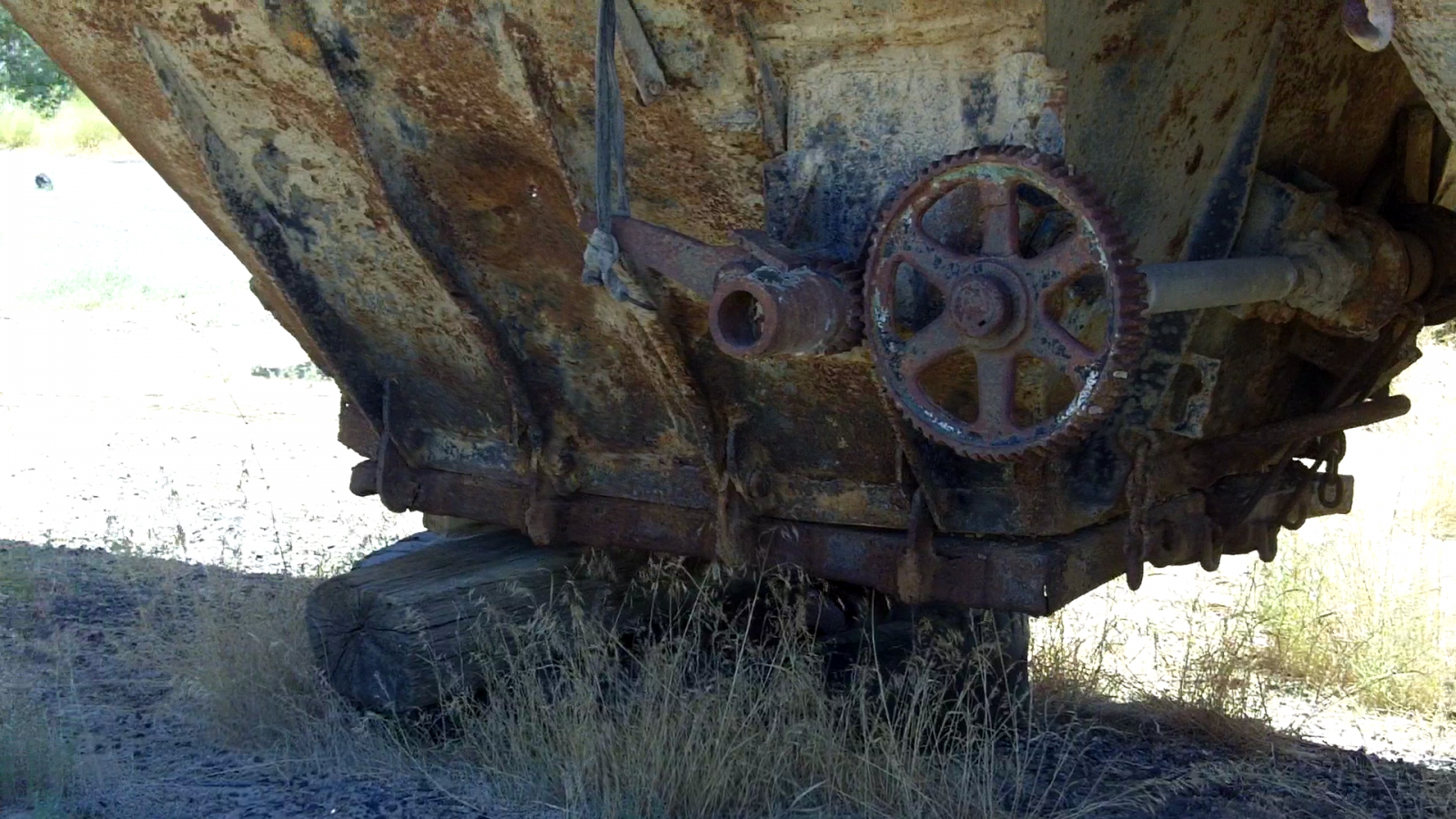

  3. HeavyGunner, Are your wife and mine sisters???? I have an old belly dump that came free with my B73, manual doors and all. Everyone tells me to scrap it to pay for parts for the truck, but I love vintage equipment. I'll see if I can find a few pics of the the non air doors. Ben

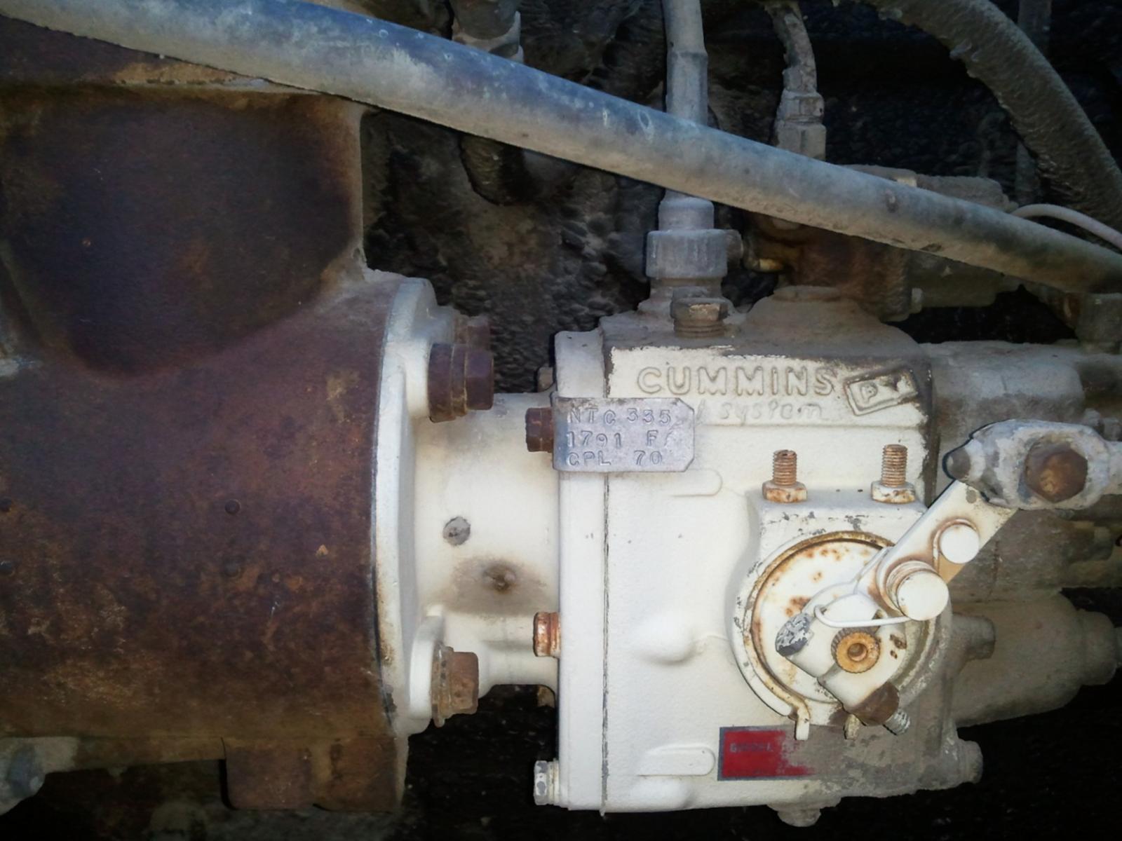

  5. I need some help positively identifing my engine please. My truck came with a 262 cummins from the factory in 1962. The guy I bought it from said it had been rebuilt about 15k miles ago. The tag on the pump now say 335. I am assuming that the pump was just turned up during the rebuild. The id tag on the engine is long since gone. Does anyone know where I can fing the serial number on the block? Thank you, Ben
  6. WAAHOO, its home. I ended up only paying $2000 in the end for the truck and trailer. Once I had it here I started looking the engine over and it appears I have a NTC 335. The tag on the pump says NTC 335 and I looked a few up on the net and they look like mine. Did the 73 come with 335's from the factory, or did someone swap it in? The 335 is the 855 cu in block correct? Any opinions on this engine, strengths and weaknesses? It also appears that these engines must have unit injectors? I have only been around newer Cummins, nothing this old. Thank you all, Ben (The newest B series owner)

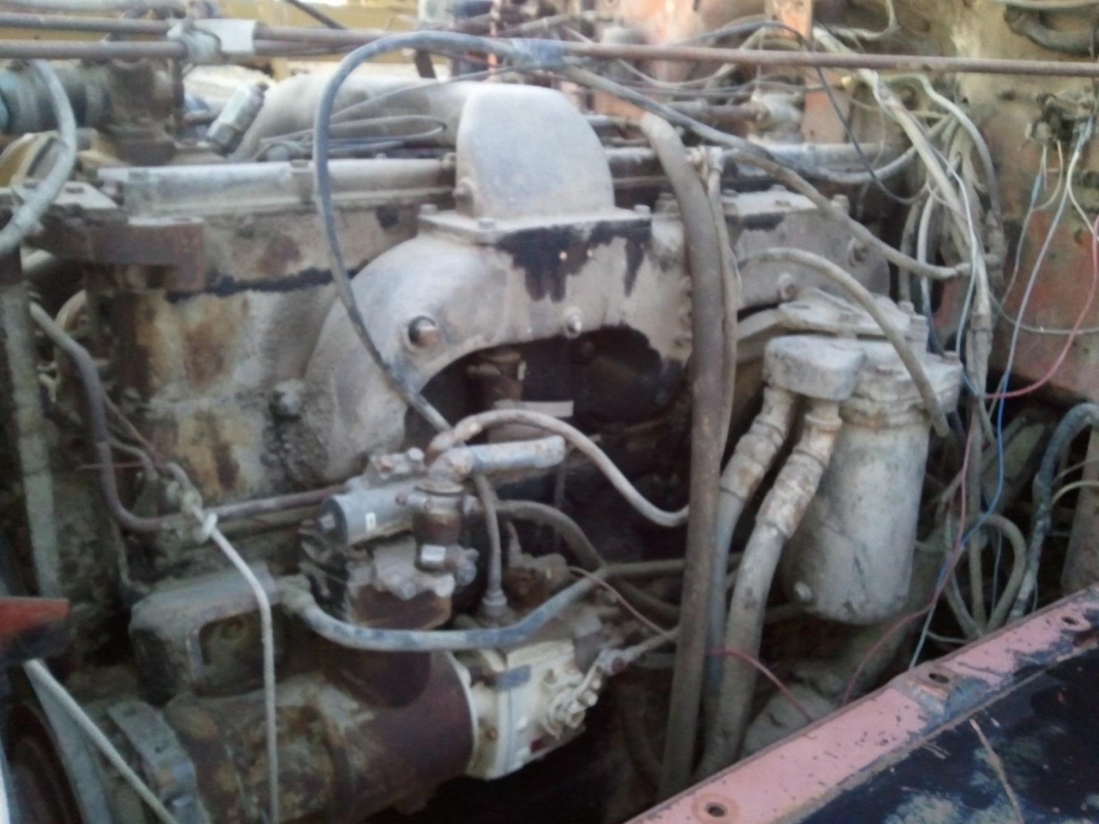

  7. I ended up getting the trailer home the other day. I knew the trailer was going to be rough, but it took way longer than I thought. I think I am going after the truck in the morning. As to the starting issue, I pulled the starter and took it to a local auto electric guy, and it spun like a champ. I must of had a bad connection when I was hooking straight to the batteries. I can't wait to get it home and start procrastinating!!! P.S. Does anyone here know much about the 262 Cummins? Ben

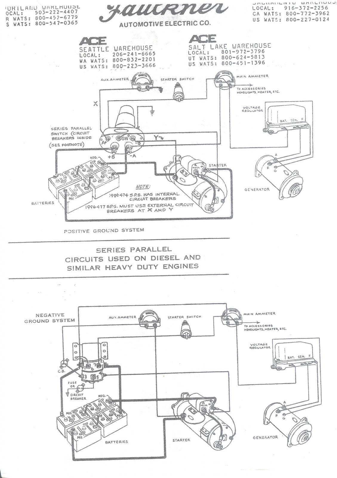

  11. Not nitpickin, just trying to understand the electrical. I want to get the thing started again and it is being difficult. It does have a series parallel switch, which combined with not knowing the polarity is screwing with me in understanding how to jump this thing. It does not have any batteries still hooked up. I am just a whipper snapper and wasn’t quite born when the '77 F model above was rolled off the line and have never been around a negative ground. Do I just hook the negative lead to the post on the starter solenoid and positive to the case(Minus all the leads to and from the SP switch for simplicity)? If I am attaching a battery charger, I still hook up the positive to positive correct? Sorry for the dumb questions, I just want to make sure I understand. I have the cash on hand and am thinking of keeping the trailer around for now. I have a late 50's Cat 14 motor grader that would look nice parked next to an old Mack and "vintage" belly dump. As for the sound, from what I can remember it sounded pretty sweet even though there is a big ugly muffler on the stack. It has a Jake that worked well enough to kill the engine. Thank you all for your advice and encouragement. Ben
  12. I thought the price wasn't to bad, but wanted to check. I went by today again to start it, and same thing as the last time. It would spin very very slow and every thing got hot. Do any of you know when they switched to a negative ground? Is there an easy way to tell if the batteries are long gone. The only place on the frame that is covered in baked on grease is from the top of the front axle to about two feet behind it. Can anyone give me a more precise location for the vin to check against the door tag? Thank you all for help, hopefully I will soon have my first Mack! Ben
