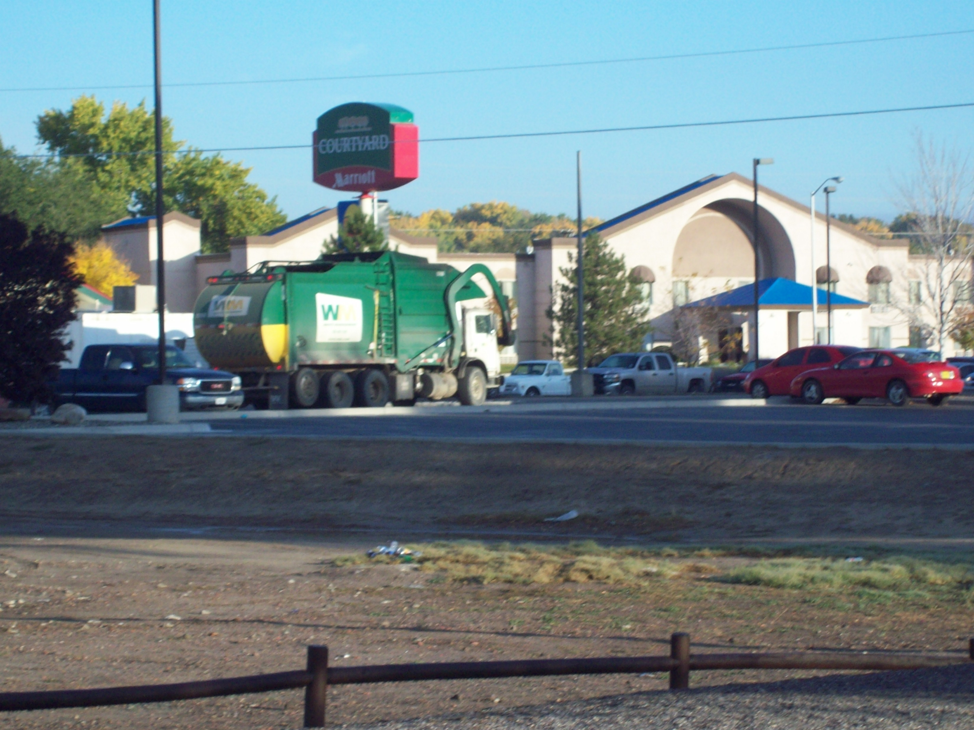

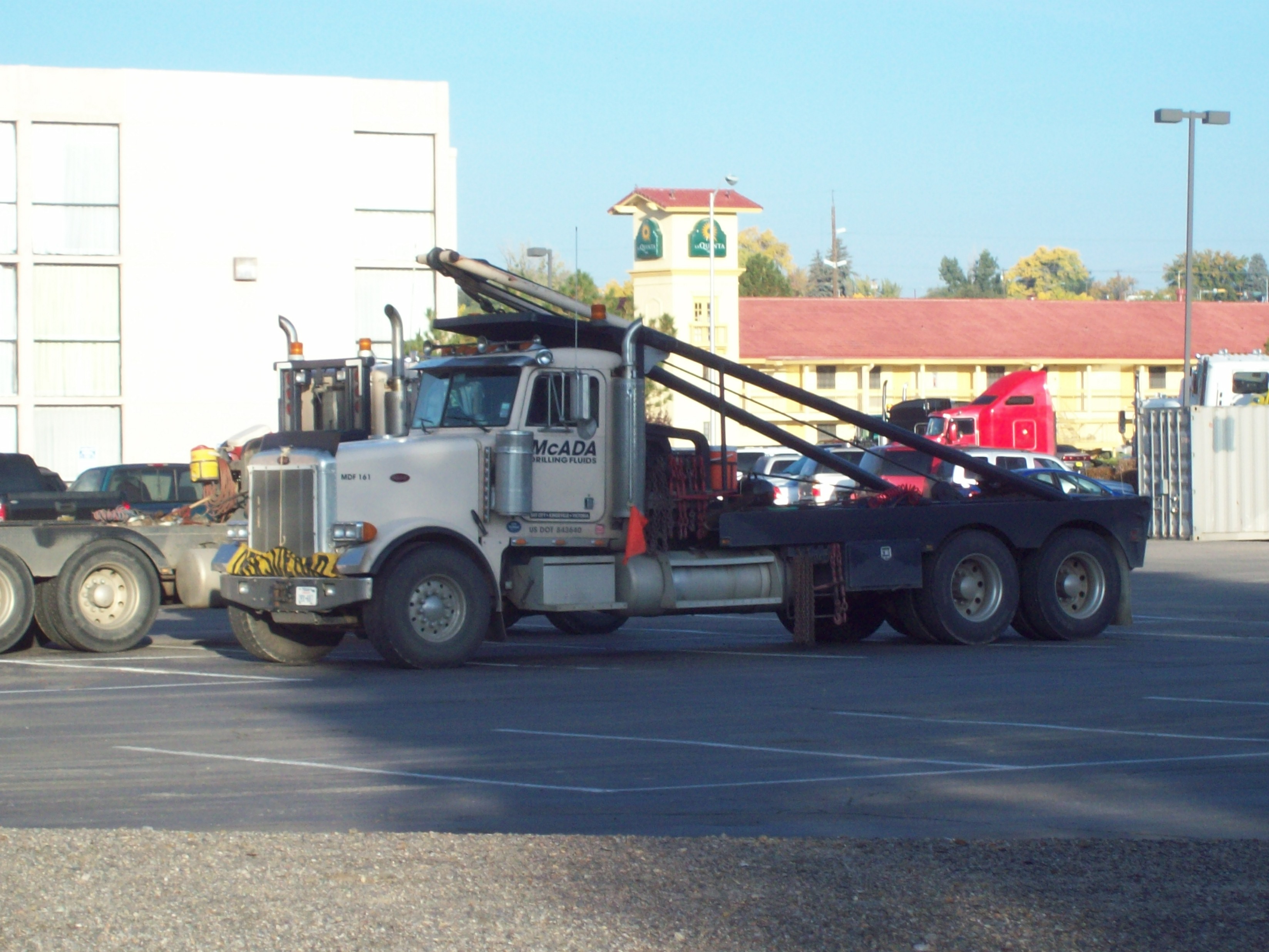

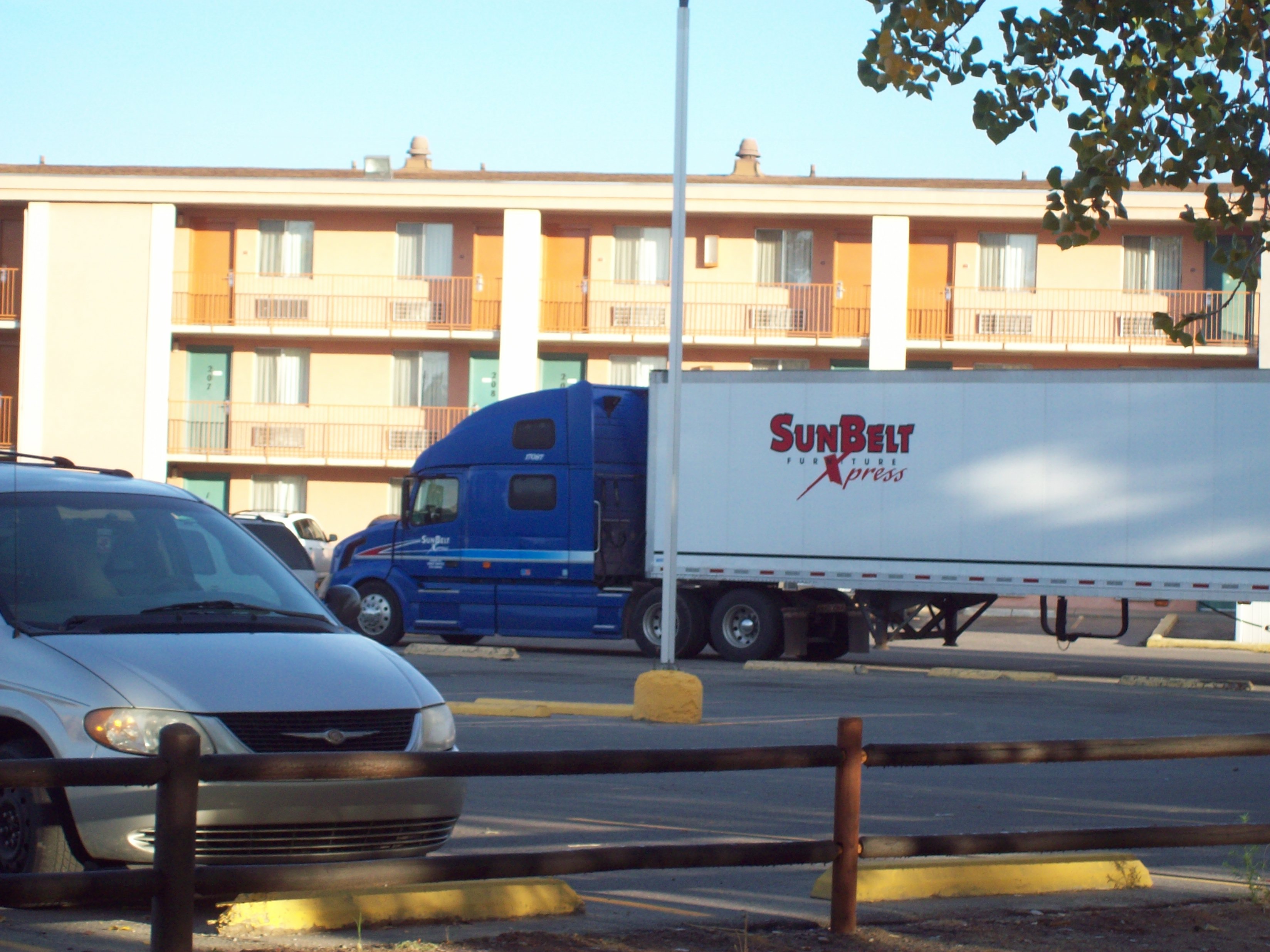

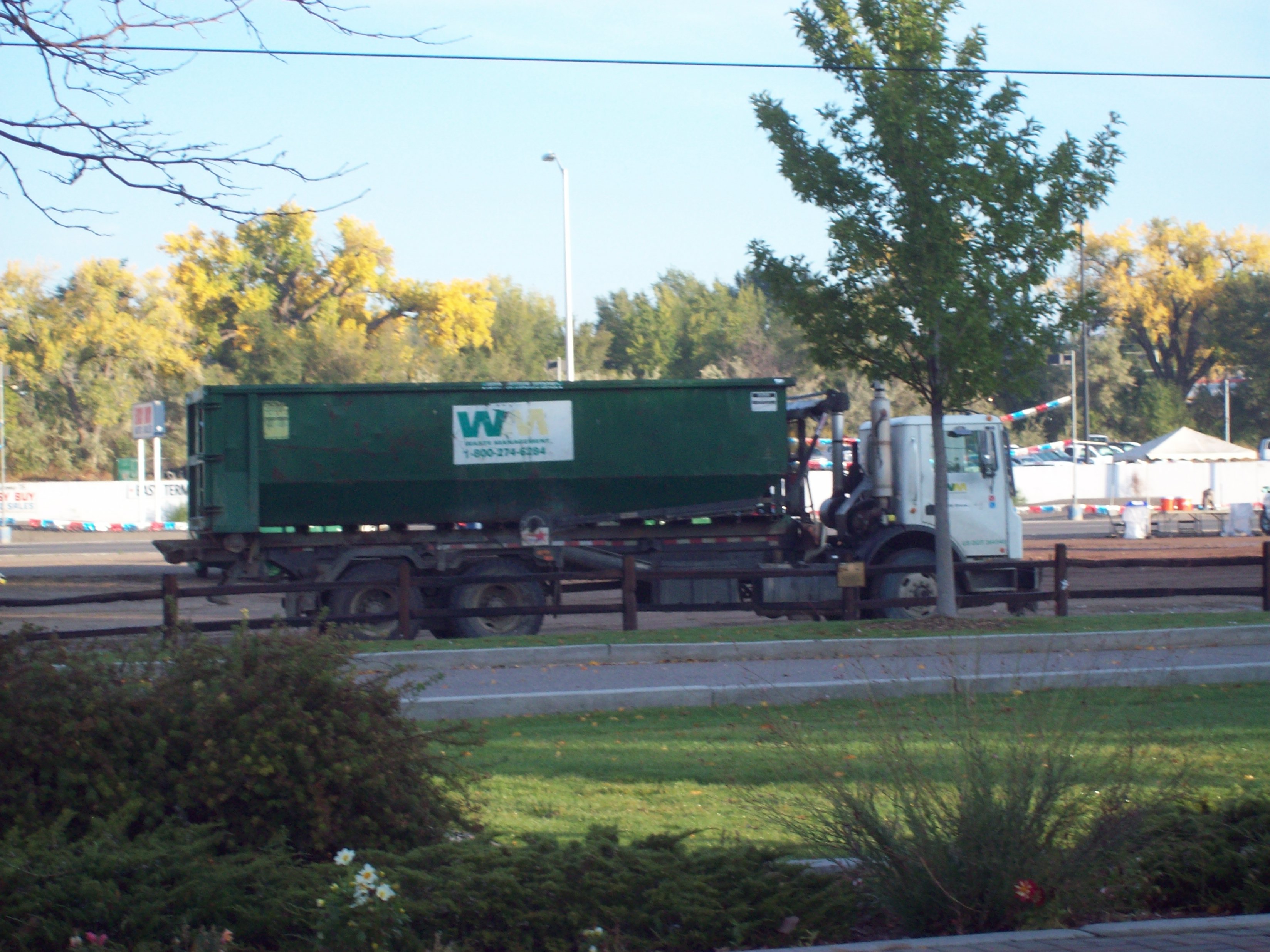

	I saw a few trucks this morning, nothing really spectacular. I did talk to a couple of transport drivers that were getting ready to leave with some new Freightliners. They had a couple of Cascadias, some business class trucks, and a vocational model or two. I also saw these: A couple of Waste Management trucks A Peterbilt rig up truck A Swift truck that WASN'T involved in some kind of accident (as of the time I took the picture)
