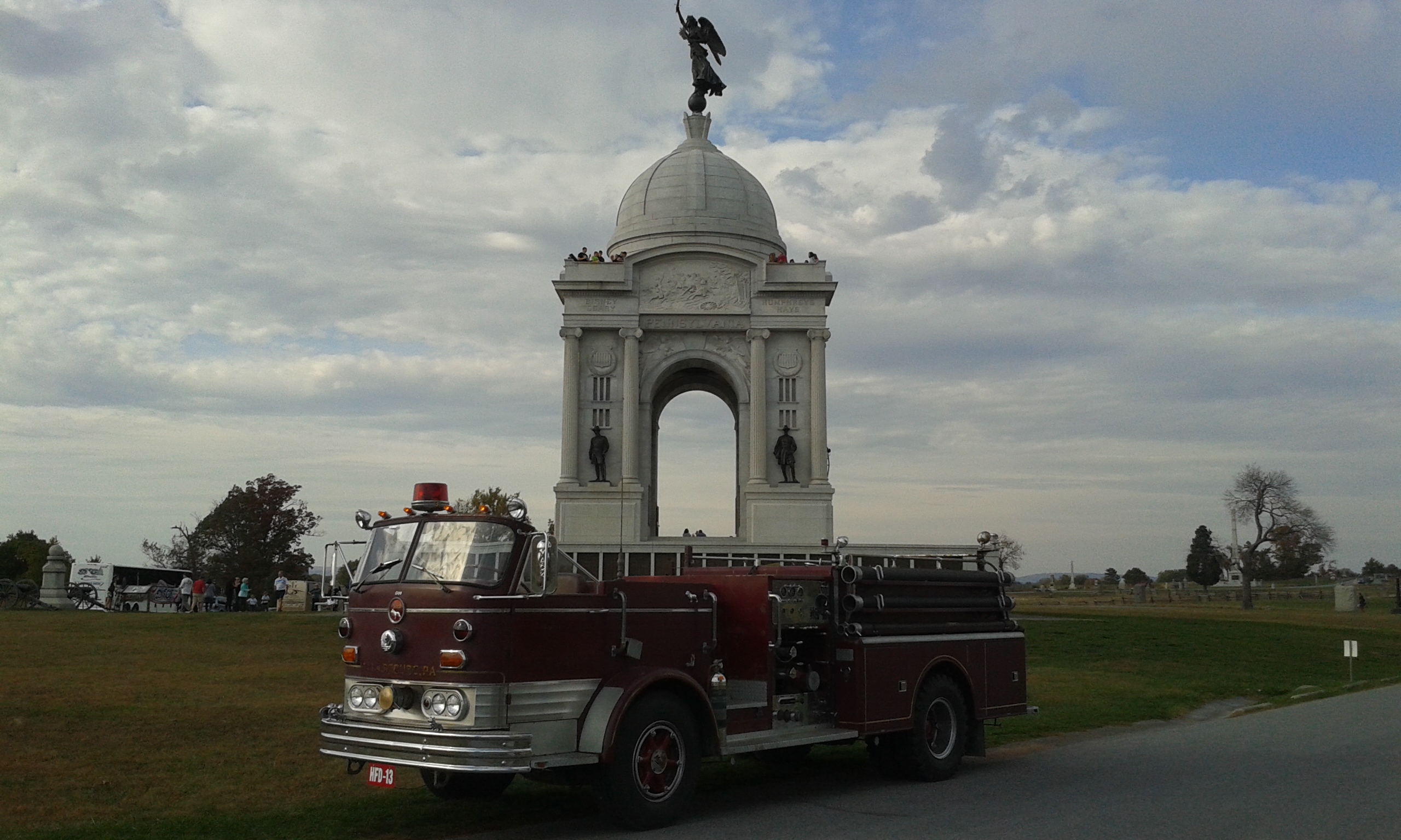

A little bit of progress from yesterday: New Victaulic clamp on the front intake piping Loaded some "new" hose that I acquired from the Bendersville Fire Co. 150' dead load 3", (2) 200' 1-3/4" attack lines, additional 50' of 3" in the compartment Shot of my little helper; he doesn't like to sit still very long!

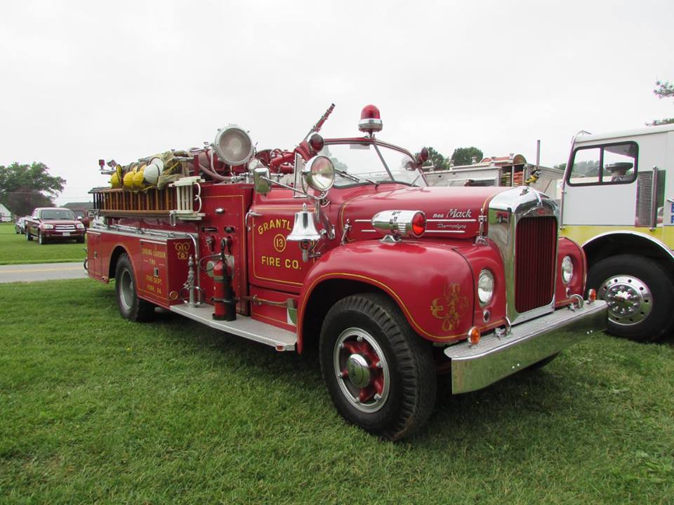

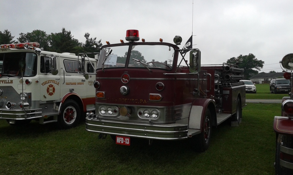

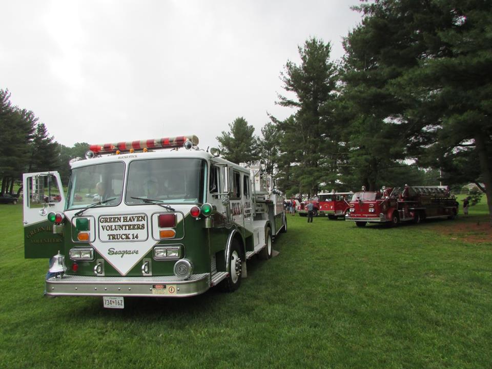

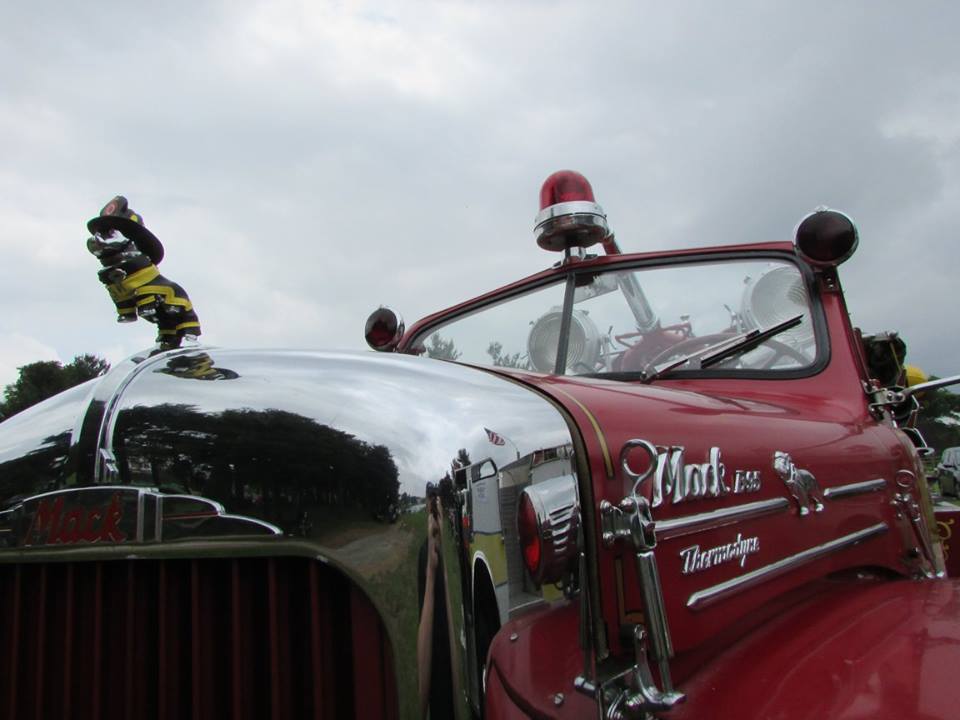

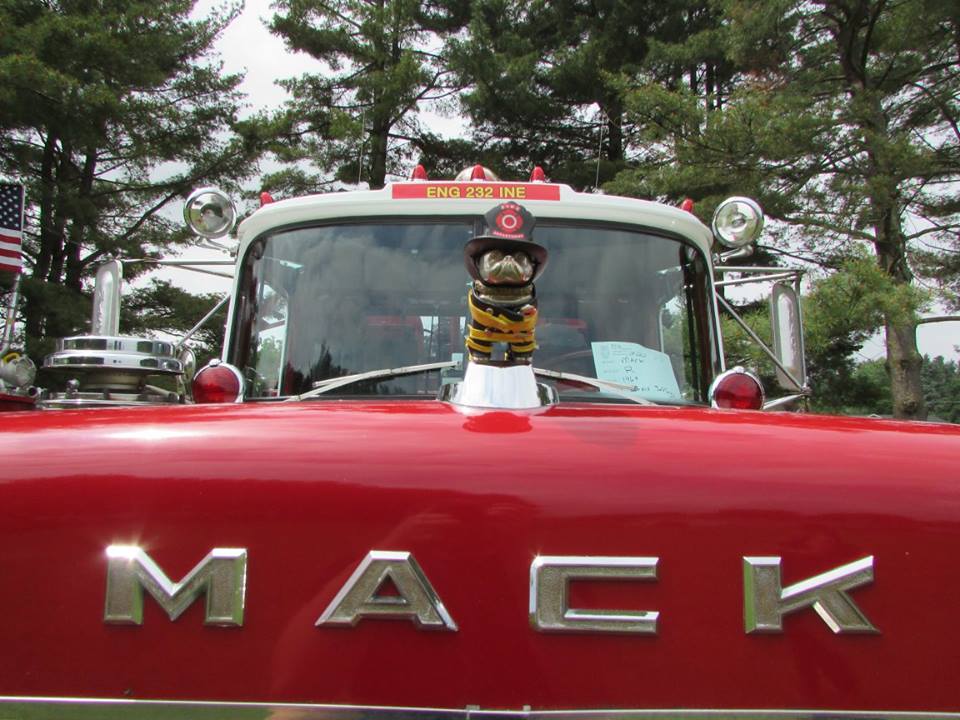

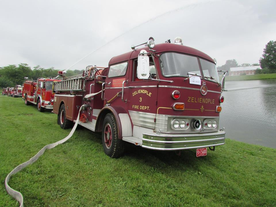

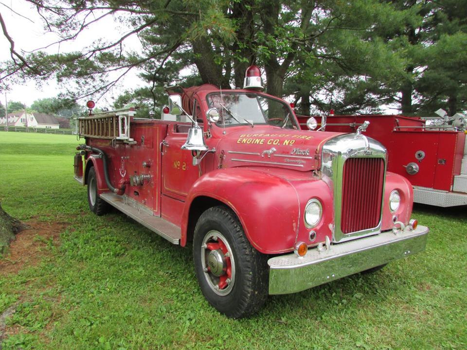

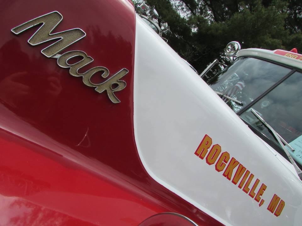

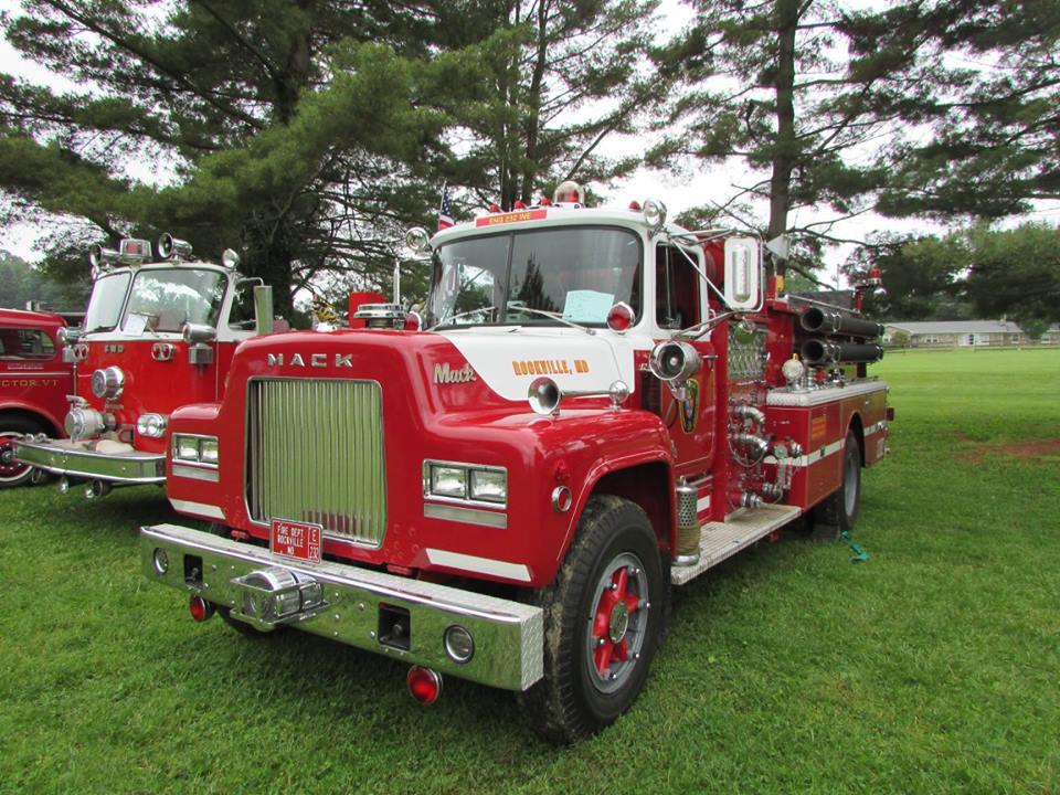

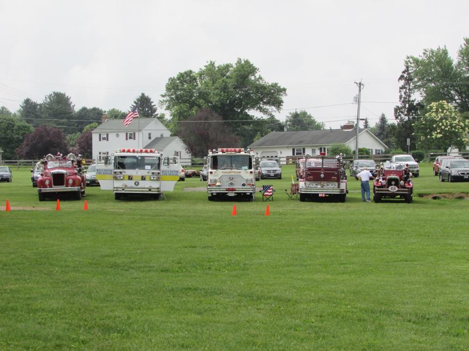

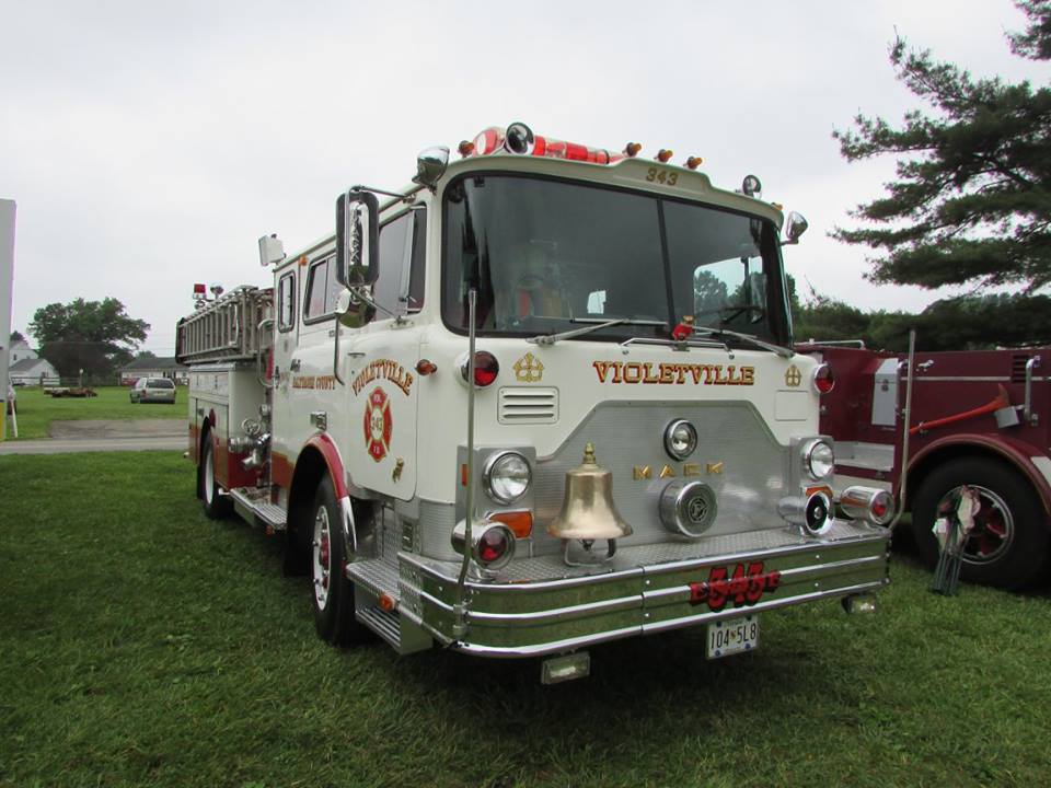

Macks and some of my other favorite shots from this year's Chesapeake Antique Fire Apparatus Association muster. There was a nice variety of manufacturers and model types this year! Mine, of course: Trying to un-stick a stuck tiller
