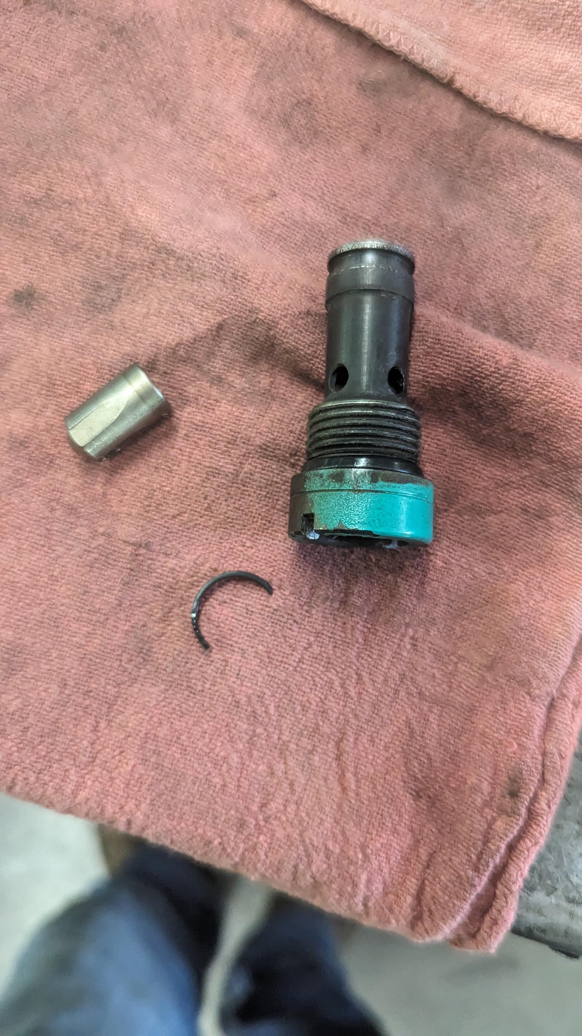

	E9 AMBAC V style injection pumpFlynpenguin replied to Flynpenguin's topic in Engine and Transmission I had a 1/2" drive draglink bit that I ground down slightly to fit. I had to take off the upper intake manifold and then lightly tapped it with an impact wrench. I tried by hand with a long ratchet, no go.
	E9 AMBAC V style injection pumpFlynpenguin replied to Flynpenguin's topic in Engine and Transmission Problem solved! Thanks to FJH I found the overflow valve on the back right side of the pump. Upon removal I discovered the o ring sealing the small end was bad. New o ring and now I build almost 20 psi with the hand pump. However I suspect the spring may be weak as max pressure when running is only 40 psi. Spec is for 38-50psi.
	I'm chasing down a low fuel pressure problem on my E9. The engine is hard starting. Idle fuel pressure is less than 5psi and the max fuel pressure is 20 psi. I think the issue lies in the overflow valve, or rather, the lack of one. My return line goes directly back to the tank without restriction from the injection pump. My dress is the stock overflow valve is no longer available, NTS in Edmonton shows out of stock. What are my options for a non-stock overflow valve?

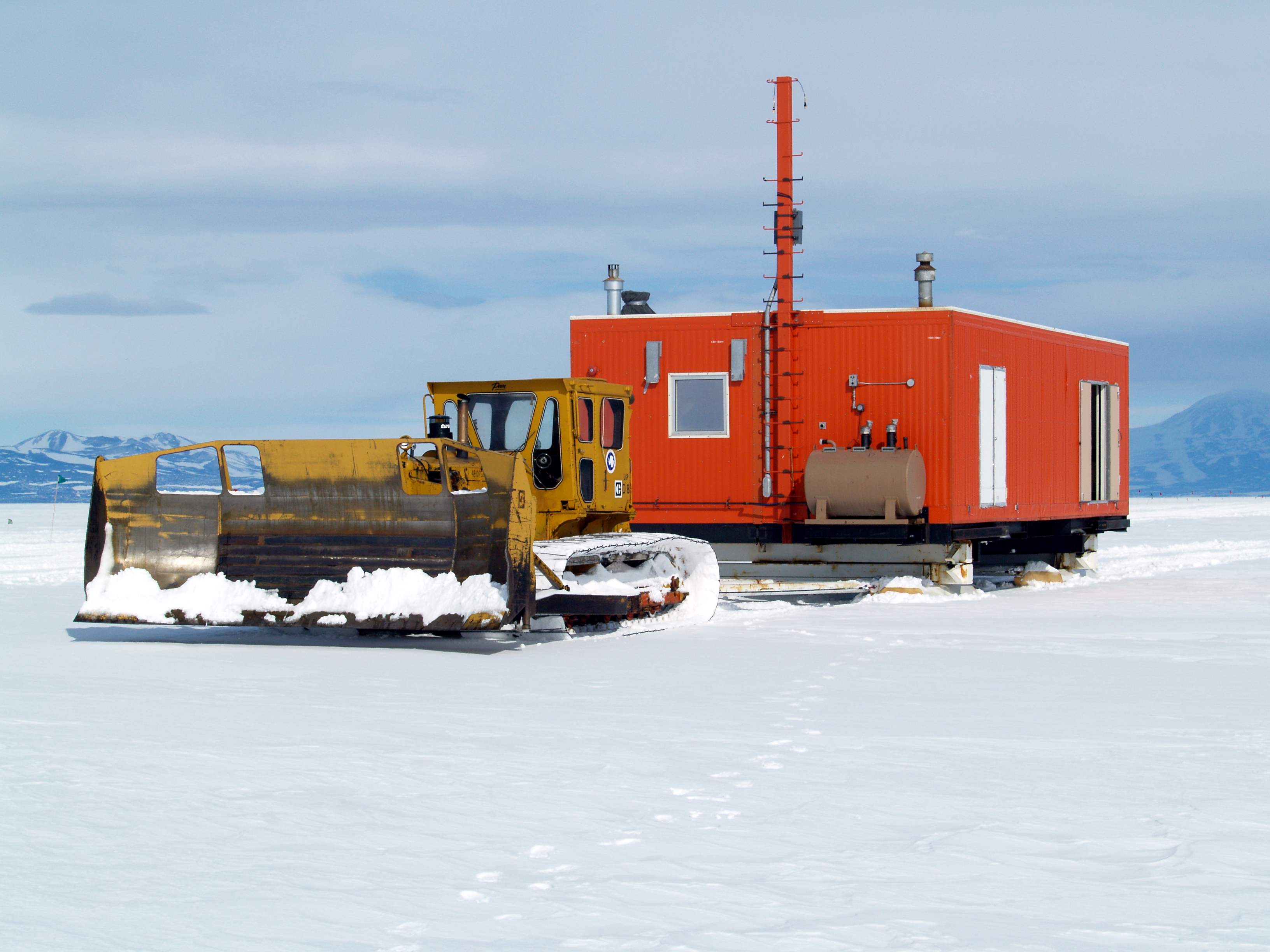

	Here are a couple of shots of my favorite dozer, a mid 50's LGP D8 14A. The new LGP D8R's are faster, push more snow, and are definitely more user friendly, but when it comes to pulling heavy loads over soft snow, nothing beats the old cats. Three remain out of the 50 or so built. Most were abandoned on the ice by the Seabees when the Navy operated the US Antarctic Research Program for the National Science Foundation. The Navy was notorious for leaving equipment where it sat when they were finished with it or when it broke down. Almost all of the tractors shipped back for disposal were scrapped, though there is one at the Seabees museum at Port Hueneme near Oxnard, Cal.
