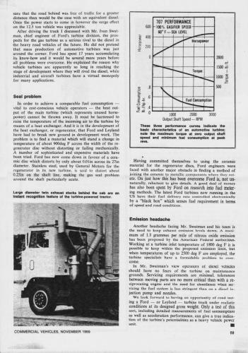

Turbine Trucks in the Future Commercial Motor / November 4, 1966 FORD OF AMERICA, convinced that the turbine engine will play an important part in trucks of the future, has announced a new 375 h.p. prototype research gas turbine engine designed specifically for a current truck model. Called the Model 707 Turbine, the new engine made its debut at this month's annual meeting of the American Trucking Association in Washington, and has been installed in a U.S.-spec Ford W-1000 heavy truck. Marketing of the 707 is not expected before the early 1970s and to advance the turbine design towards production stage, Ford has put a new gas turbine laboratory into operation at its Dearborn (Michigan) research and engineering centre. Nearly 15 years' work by Ford engineers went into the new engine, which, claims Ford, provides numerous technical and operational advantages. "For instance," says the company," compared with a conventional truck engine of equivalent h.p., the new 707 weighs one ton less and occupies considerably less space. It can pull nearly 37 tons at up to 70 m.p.h."
In 1966, Ford fitted a production W-1000 6x4 tractor with a low pressure 375 horsepower model A-707 gas turbine and demonstrated it in North America and Europe (the UK and Germany). Ford said they had “succeeded in overcoming the problems previously experienced in harnessing the gas turbine engine. The Ford A-707 engine is now in use in surface vehicles, land and water, in addition to industrial generator applications. It features a unique regenerative system which recaptures exhaust waste, a variable turbine nozzle and electronic controls”. In 1970, following 18 years of gas turbine research, Ford opened a gas turbine engine plant in Toledo, Ohio to build and sell turbine engines for heavy truck, bus, marine and industrial usage. But Ford closed the plant in 1973, after continuing issues of turbine heating, and a devastating flood that shuttered a single-source supplier’s only plant. (Ford got out of the turbine business just as Mack and GM were beginning to use new ceramic materials to create second generation gas turbines) Here’s an impressive Ford promotional video on the gas-turbine powered W-1000 COE. Video: http://www.streetfire.net/video/1970-ford-turbine-big-truckswmv_2414779.htm .

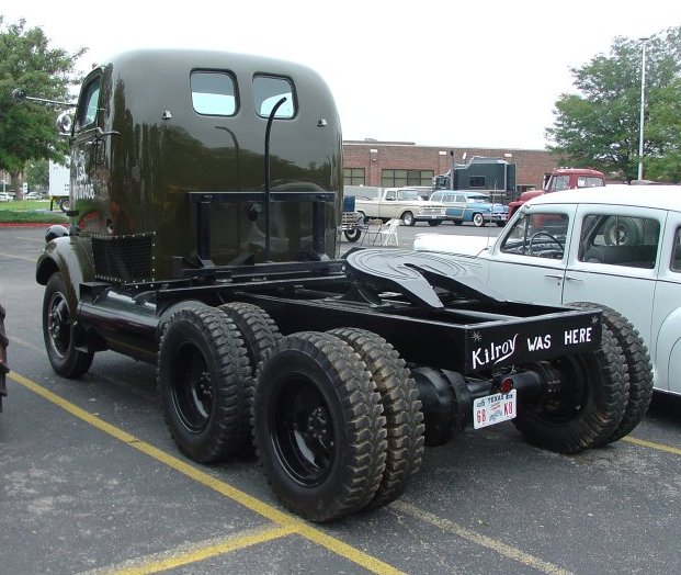

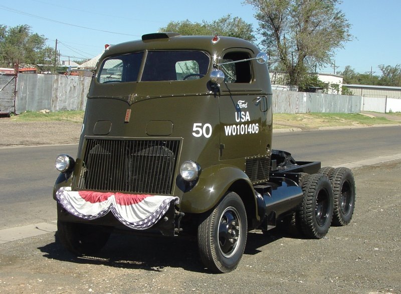

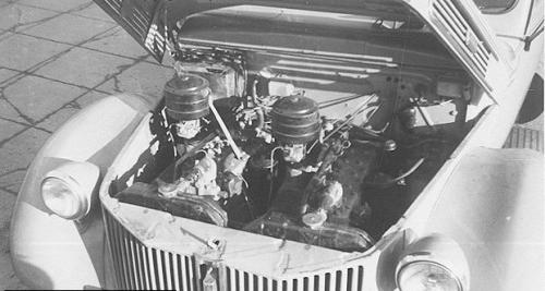

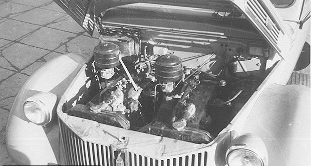

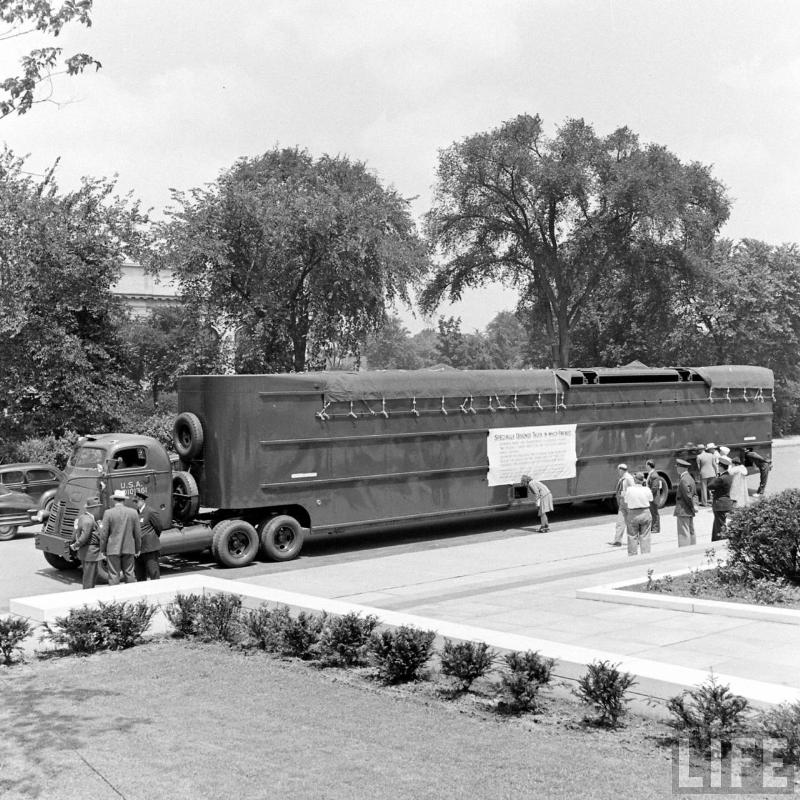

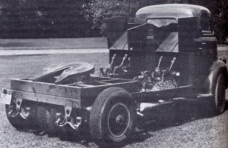

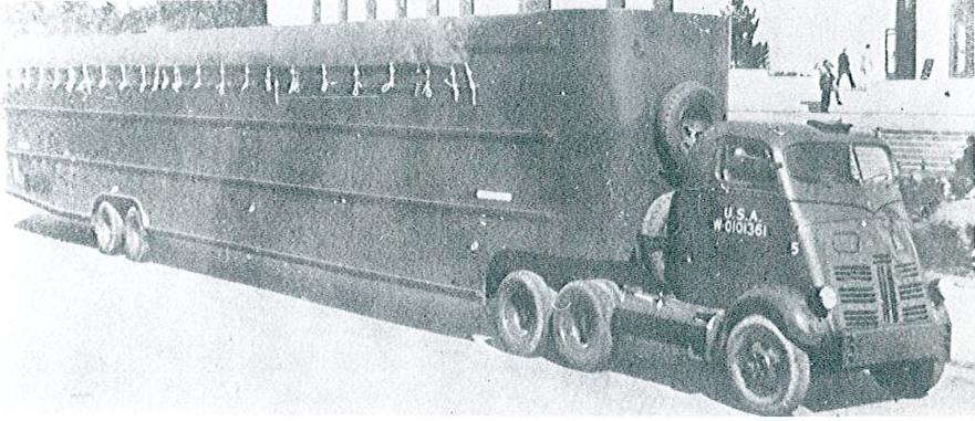

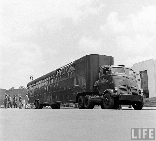

This goes back to World War II. In 1943, the Thorton Axle Company in cooperation with E&L Transport (of Dearborn, Michigan) produced just under 100 of these specialized T8 6x4 tractors, utilizing many Ford components, for pulling 63'6" long trailers loaded with B-24 heavy bomber fuselages and wing sub-assemblies. Ford was one of the war-time producers of B-24 "Liberator" bombers, in addition to Consolidated Aircraft (of San Diego, California) who'd designed it. The creation was branded "Thorco Dual Motors" and had two Ford (some say Mercury) 100 horsepower V-8 engines. The B-24 sub-assemblies were carried between Consolidated's California and Fort Worth plants, between Ford's Willow Run (Michigan) and Douglas' Tulsa plant and North American's Dallas plant (or something close to that). There's also mention of them hauling something between Loudonville, Ohio and Buffalo, New York. What was innovative about these truck is the two engines were installed on a roll-out sub-platform, for easy maintenance and replacement. One engine drove the front-rear axle, and the other drove the rear-rear axle. So to finally answer your question, if one engine blew up, the driver could disconnect the two transmission's paired linkage and limp in to a Ford dealer on the remaining engine. The ability to readily get parts and service from Ford's national dealer network was another reason they went with off-the-shelf Ford parts. These tractor-trailer combinations were 70-feet long and weighed about 50,000 pounds. The eighteen tires were all 8.25-20s and average cruising speed was 40 miles per hour.

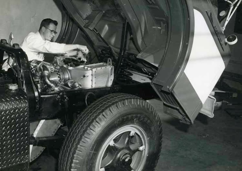

Ray Law – Ford of Canada General Sales Manager “Ford’s 600 horsepower gas turbine is the culmination of years of intensive research. The Model 705 engine is basically two turbines in one and represents the result of a search by computer of hundreds of theoretical designs for the one best able to deliver diesel-like fuel economy throughout the operating range. This supercharging approach results in a lightweight, compact engine containing smaller parts running at speeds up to 75,500 RPM. Air passages are considerably smaller than conventional turbines because Ford’s two-stage compression reduces air volume to one-sixteenth of its original volume. The use of small rotating parts, cast aluminum and thin-wall cast iron housings results in an engine weighing about one-third that of a diesel engine of comparable power, an important factor in economical truck operation because weight savings can often be translated into added payload revenue. Car motorist on the road with this truck would benefit too, by the fact that the turbine exhaust is odorless, clean, smoke-free and low in smog-causing unburned hydrocarbons. Another benefit from the turbine powerplant is the low level of sound produced by the engine. It is no louder than that of an automobile at 50 feet away. Because a turbine is most efficient when run steadily at full power, its best application is long-haul superhighway trucks which would travel non-stop for hours at a time. Because turbines are relatively vibration-free, the truck chassis can be made of lighter metal, and the weight savings can again be translated into more payload. Transmissions can be made simpler, and with fewer gears, because the turbine has greater torque at low speeds than a piston-type engine. Oil consumption is practically zero because the turbine has no crankcase and no oil contamination by “blow-by”. The gas turbine is air cooled and requires no coolant and radiator. Maintenance is simple. The Ford turbine is designed so individual components can be replaced without disassembling the engine. When complete replacement becomes necessary, the entire engine can be quickly removed from the truck.” Specifications - Ford Model 705 Gas Turbine Weight: 1,475 lb Shaft Horsepower: 560 @ 3,080 rpm Rated Horsepower: 600 @ 3,080 rpm Torque (ft.lb.): 955 @ 3,080 rpm 1,620 @ Stall Fuel Type: #2 diesel Burner Temperature: 1,750ºF Exhaust Temperature: 660 ºF

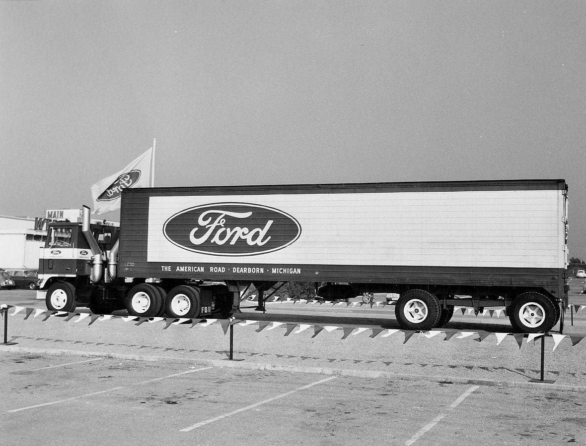

I’m certainly curious if “Big Red” still exists. The 1996 summer issue (Vol. 2, No. 3) of Ford Truckin' magazine states that “Big Red” was sold (or leased) to the owners of the Miss Bardahl Unlimited Hydroplane race team - minus the turbine motor (note the tow bar) - in the late 60's, and sold to Holman-Moody a few years later. The article has an interview with Jim Augenstein who was the Ford project manager and drove “Big Red”. He said Holman-Moody had sold it but didn’t identify the new owner. Indeed eyewitness accounts state that Ford dealer Holman-Moody of NASCAR fame purchased “Big Red” and stored it first in a hanger at Charlotte (North Carolina) airport, and then at a nearby facility at least thru 1973 (these buildings were torn down around 2005 to make way for a new runway). The picture below shows “Big Red” in the initial Charlotte airport hanger (no mention of the two custom 40-foot trailers). I also read that Holman-Moody advertised the truck for sale during the 1970s. Several publications have mentioned "Big Red" is languishing in poor condition at Ford’s Dearborn proving grounds. Did Ford repurchase the truck from Holman-Moody? Certainly, this truck is a rich treasure of America’s trucking history.

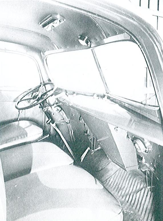

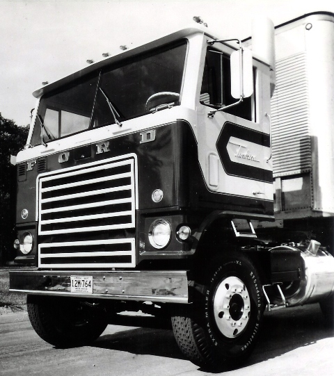

Featuring a “flat floor” design like many of today’s premium COEs, the cab’s interior was 7’ wide with over 6’3” of headroom. The interior was lightly pressurized, with aircraft-style swivel reading lamps. In the center of the rear cab wall was a large illuminated map of America’s planned super highway system for the 1970s. Designed not to distract the driver, a TV set located above the windshield had power-adjustable vertical slats blocking the driver’s view of the screen so that it was only viewable from the off-duty driver’s adjustable lounge chair, which itself could be converted into a bed.
The off-duty co-driver could walk around the spacious cabin and make use of the “crew support station”, which included a built-in refrigerator, food warmer, sink, and hot and cold liquid dispensers. A disappearing private toilet enclosure featured its own innovative electronic waste-incinerator.
To enter the cab, the driver actuated a single control handle recessed into the cab’s exterior behind a small door at ground level. The air cylinder-actuated door then automatically opened and an electric motor-driven retractable ladder extended downward from its horizontal storage position under the cab floor. Once inside, the ladder retracted again for enhanced aerodynamic efficiency. The driver sat behind a single pedestal-mounted instrument panel and steering wheel, with six gauges mounted above the panoramic tinted windshield to monitor turbine conditions. The contoured leather driver’s seat was power-adjustable fore and aft. Large foot pedals were mounted flush with the floor and included a foot rest (dead pedal). The driver actuated the 5-speed Allison automatic transmission via column-mounted controls. And of course, Big Red featured cruise control. Despite the futuristic design, Ford engineers strived to make all driver controls somewhat similar to those of conventional trucks. To meet the non-stop operating conditions planned for this truck, Ford provided revolutionary comfort features included a dual-zone thermostatically-controlled HVAC system.
Rare in 1964, both the 12,000 pound steer axle and 44,000 pound tandem bogie were air suspended. The drive axles were fitted with energy-efficient low-profile super single (duplex) tires. Drivers commented favorably on the ultra-smooth front and rear air-ride suspension, even when cruising at 70 to 80 mph. And extremely unusual for the time, the lightweight fiberglass-over-steel construction cab was mounted on a four-point suspension system (a feature not seen again in America until the Ford CL(T)-9000 in 1977, another cutting edge truck from Ford). Leaf springs at the front corners mounted fore and aft, and at the rear corners mounted laterally, so as to control cab pitch and sway, dampened road shock to reduce driver fatigue.
Impressed with Ford’s 300 horsepower gas turbine prototype of 1961, the U.S. Defense Department had contracted with Ford to develop a 600 horsepower version. Within two years of being awarded the joint Army-Navy contract, Ford engineers designed and built the model 705 gas turbine. Developed for use in many military applications (e.g. tanks, minesweepers, hydrofoils and power generation), the model 705 gas turbine was very compact in size, measuring 49” by 44” by 38” (L x W x H). The unique feature behind the model 705 turbine was supercharging, employed in two compression stages, a feature never before attempted by any manufacturer in gas turbine engines under 5,000 horsepower. This allowed for a lightweight, compact engine that used less air while delivering excellent fuel economy. The two compression stage design was like having two engines in one. The truck could operate with only half the engine running. Then when required, the driver could activate the second stage to power refrigeration, cabin comfort items or other requirements. At the push of a reset button, the full 600 hp would be available, directed to wherever the drive system required it. By 1964, at the same time Ford was courting the military’s turbine business, approximately half of the 41,000-mile Interstate Highway System was open for use. With it’s completion in sight, the U.S. Department of Commerce recommended the easing of length and load restrictions for commercial trucks. That decision motivated truck manufacturers to envision all-new truck designs for the 1970s and beyond. Ford’s answer was the breathtaking “Big Red”, a towering “tractor-trailer of tomorrow” test-bed for the 705 engine. With cutting edge aerodynamic styling and a plush cab designed for extended cross-country travel, “Big Red” allowed Ford to simultaneously test the gas turbine designs it was developing for the U.S. military while evaluating advanced heavy truck technologies for the coming decade and beyond. Ford engineers and designers were extremely serious about the “Big Red” concept, and viewed it as a fully operational working truck accurately reflecting the needs of the future. Designed to pull two 40-foot trailers at 70 miles per hour, a 270-gallon fuel capacity gave the truck a 600 mile range. “Big Red” was 13 feet tall and 8 feet wide. From the front bumper to the rear of the second trailer, the double-trailer combination measured 96 feet long. Big Red’s maximum rated gross combination weight rating was 170,000 pounds, an impressive figure in 1964. Though 13 feet tall, the aerodynamic shape of the cab and trailer resulted in 37 percent less wind resistance than conventional cab-over-engine tractor-trailer combinations of the period (An important factor given that 50 percent of the horsepower needed to move a tractor-trailer at highway speeds is required to overcome wind resistance). To optimize cab and trailer aerodynamics, Big Red’s cab was designed to be the same height as the trailer. The cab front is convex, and the cab sides are smooth with no protrusions. The rear of the cab was concave so that the trailer could be close-coupled to the truck. By minimizing the tractor-trailer gap, drag caused by crosswinds and turbulence was reduced for a more aerodynamic profile and greater fuel efficiency. Sitting eight feet above the highway behind a free-standing control console, the driver had unlimited visibility. Test drivers reported that the turbine power-plant was virtually noiseless, and produced an odorless, non-toxic exhaust (which was safely vented 14 feet above traffic). Years before brake regulations were created for heavy trucks, “Big Red” was built with three redundant brake systems. The brakes would pulse-lock automatically if the air pressure dropped below minimal levels.
Ford executive vice president Charles H. Patterson said “This truck is a concept vehicle from our product research office. It is a test-bed in which advanced engineering ideas are proved out in actual over-the-road operation”. While Patterson emphasized the Ford gas turbine truck is not planned for production, he said “it represents the thinking of our research engineers as to the best type of truck to make efficient use of the super highways and turnpikes of the future. For the first time, a truck has been designed with performance characteristics approaching those of passenger cars. This truck has the potential for economically hauling greater payloads than anything on the turnpikes today, and moving them farther and faster than present-day trucks”. Ford envisioned huge double-trailer combinations like the “Big Red” concept which would travel 24/7 for maximum operating economy, rarely leaving the interstates except for driver changes, switching trailers and refueling.
