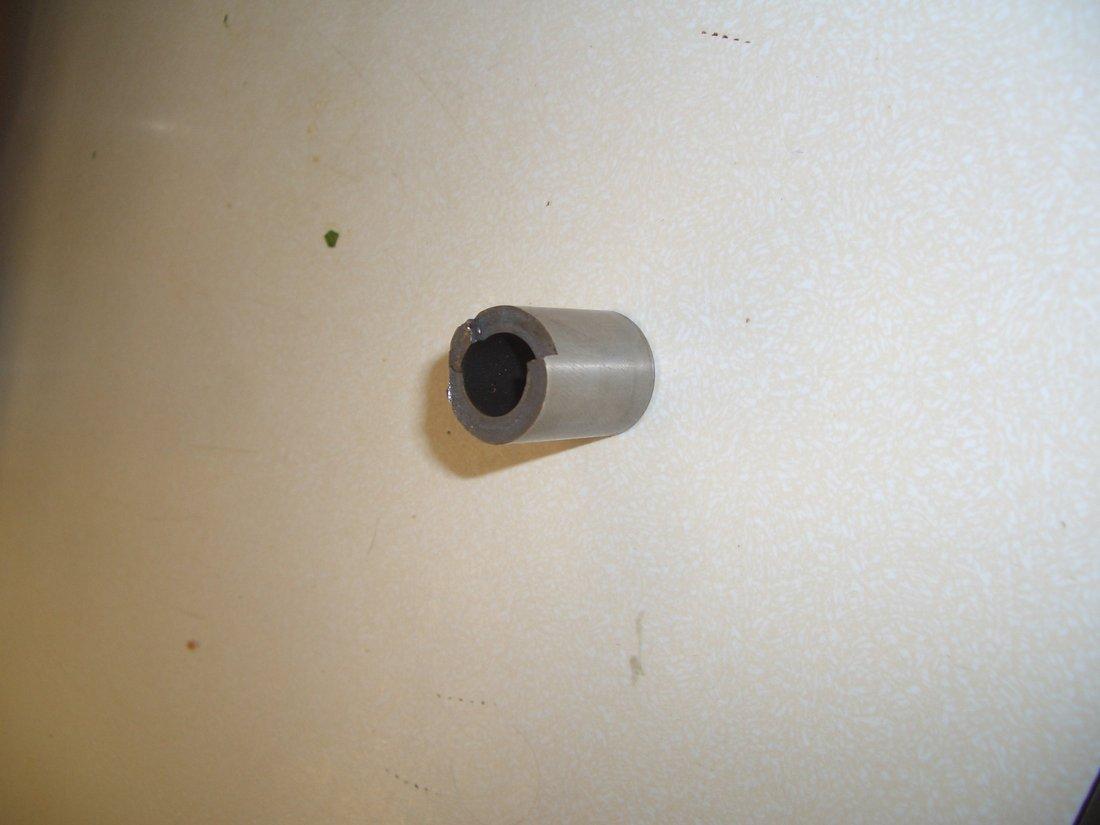

turning the shaft should push the cap off the body. Likely just stuck.
Nevermind, I thought I was looking at the steering box not the angle box.
1
The way I'm seeing it, there is a cotter pin hole near the vertical, so I doubt is screws in, but it might be serrated on the other end of the pin.
1
Anyway you could rig up a threaded rod through the hole on the left of the picture and make a jack-screw out of it to force the pin to the right?

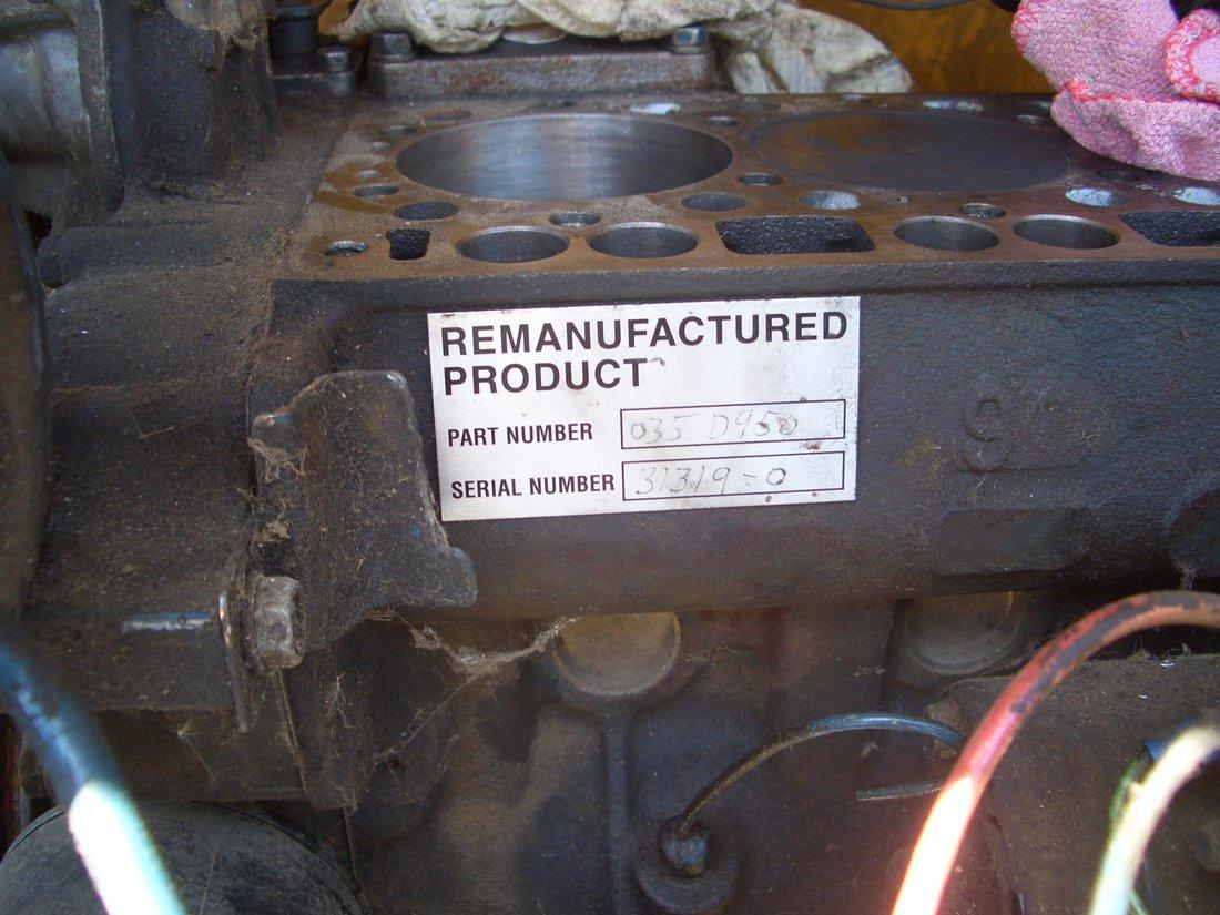

Engine knocking
in Engine and Transmission
Posted
In the states, you wouldn't need to, there would be some close by.
My Boss at the bus company once air freighted a Gardner short-block across the pond, I don't know what that cost him!
No idea, but might be worth looking for freight-forwarder, and find out what it would cost to ship to you and what the duties would be.
