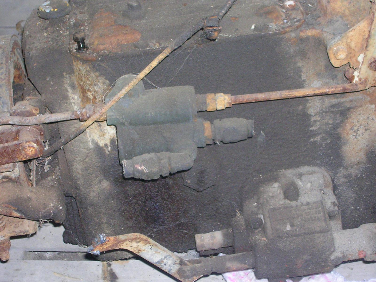

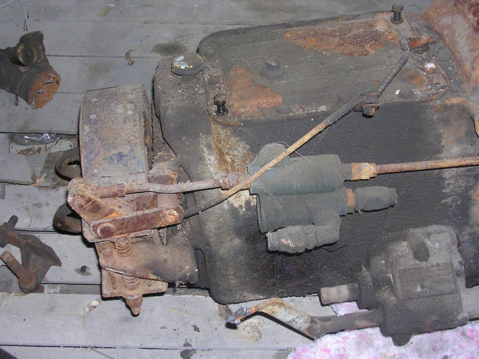

	So I acquired an EN377 and a five speed transmission for my A40. I already have a 10 speed out ot the original truck which I plan on reusing. In the rod going back for the parking brake linkage there looks to be a weld which did not surprise me, But I look at the 5 speed that I have and there is some sort of a valve with air lines which have been cut as the drivetrain was a cutout. The only guess I have is did they have a valve so when you pulled back on the e brake it applied the service brake as well as the driveshaft brake? I think pictures will help so here goes. Thank you John
