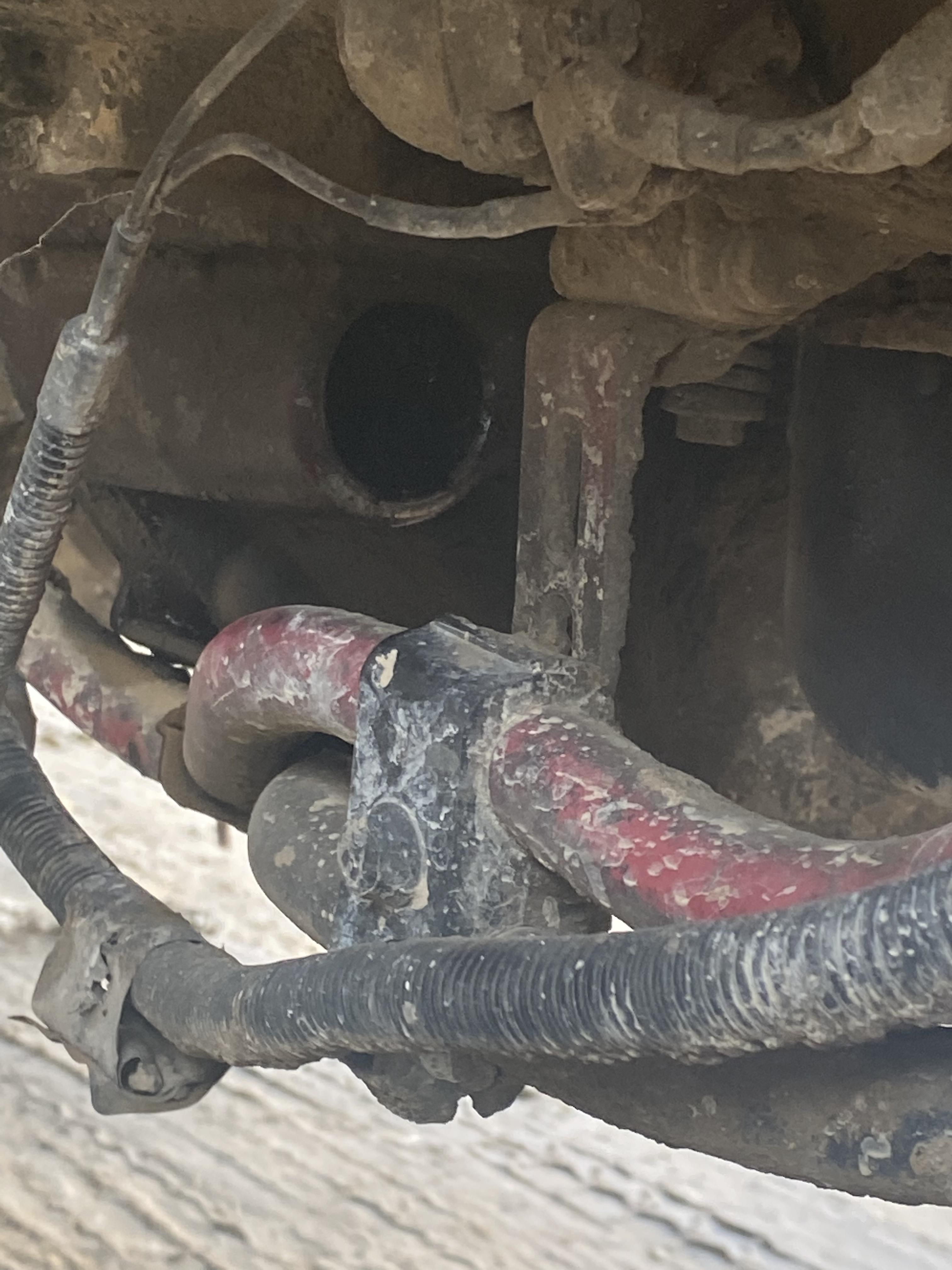

  24. Oh ok yes it doesn’t have a plug on it and it is leaking thru their it seems like a slow leak will keep and eye on it . And possible wash the undercarriage to see if it’s coming from somewhere else. thanks mack pro
  25. I don’t think it’s a breather but I believe oil is coming out from their not a lot just a little and runs down to where the trans and engine meet .
