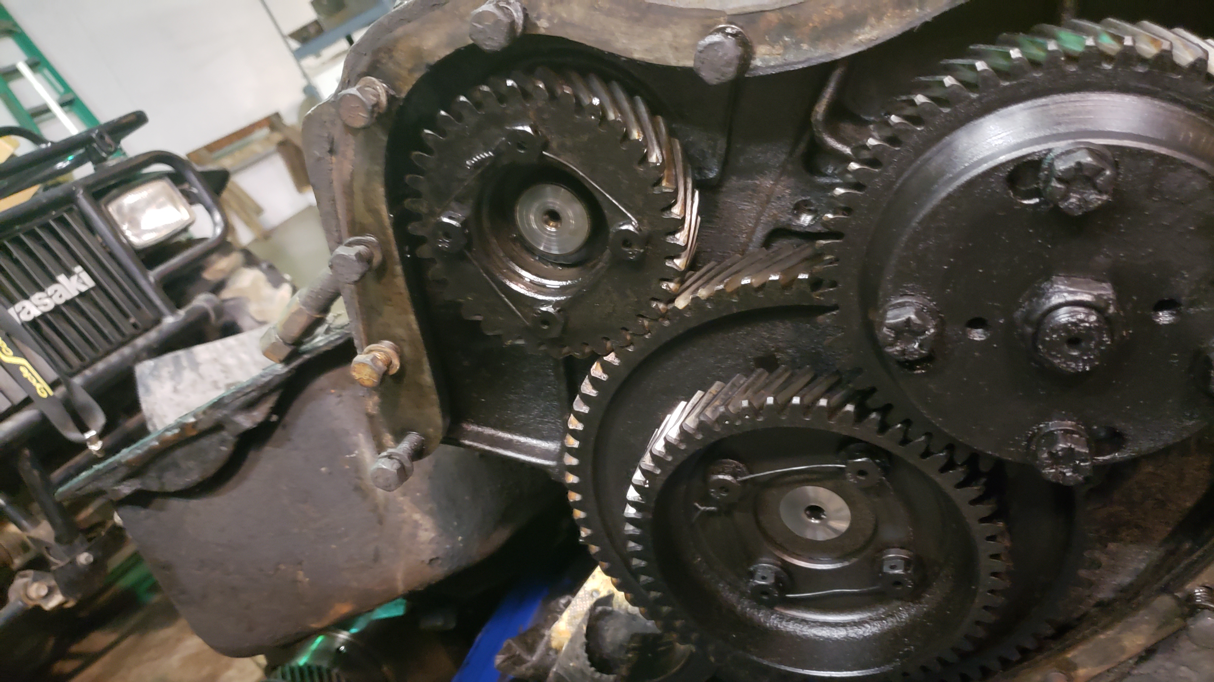

  3. Its an endt673. That I got out. Just need to remove the intermediate shaft.

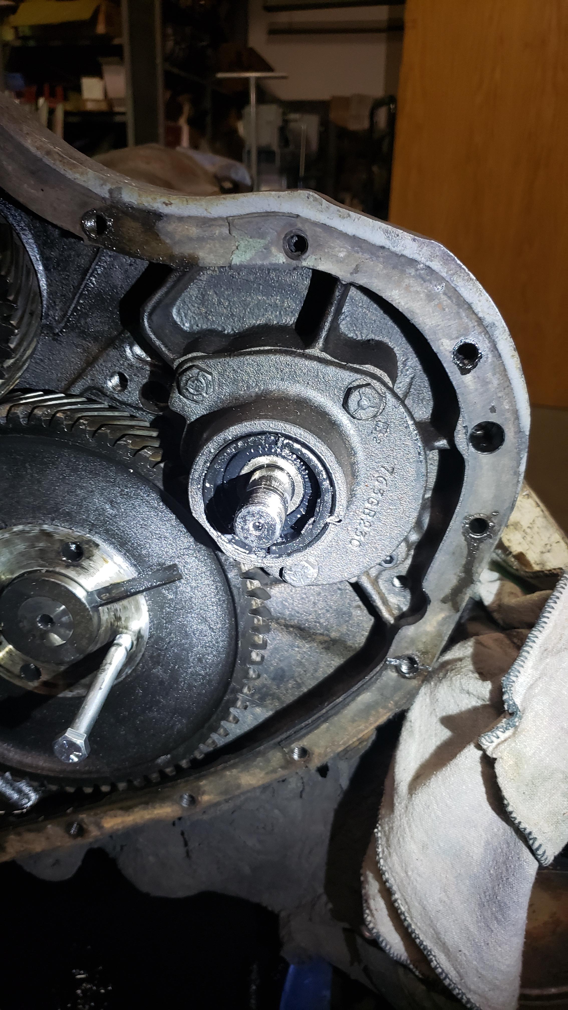

  4. I'm looking to remove the drive assembly from the block. The pump is already removed. It looks like an axle nut socket, but was wondering if there is a specific part number to reference the tool. I did not see one in the manual.
  5. I found the info on removing the Aux shaft in the manual. Still looking for info on the tool to remove the injection pump.
  6. Can anyone tell me the process of removing an auxiliary shaft on an ENDT673. Also, what tool is used to remove the bearing for the injection pump in the attached picture? Thanks for all the help!

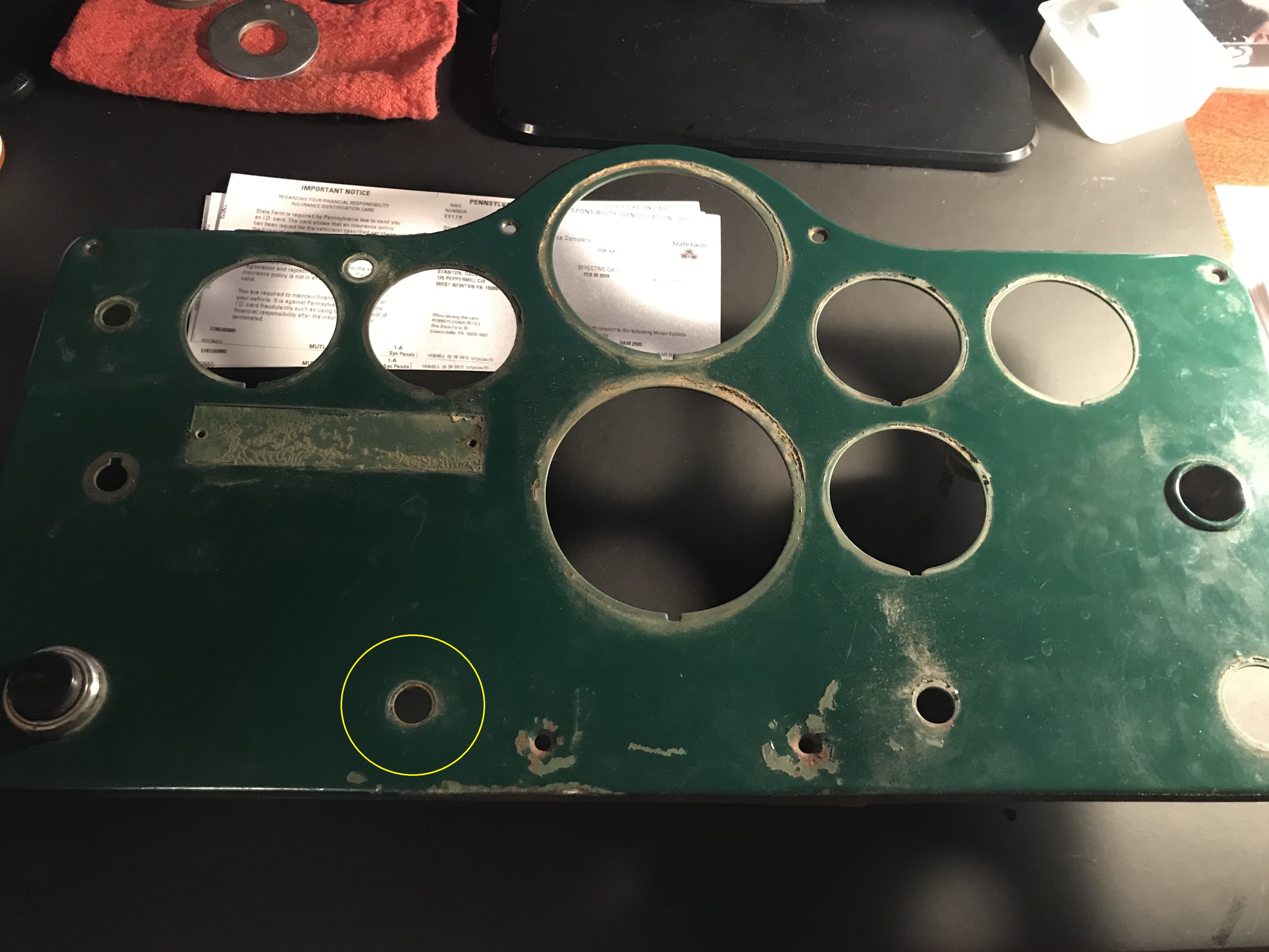

  9. A switch on the left side of my dash was replaced with a toggle switch, but I saw that some like mine had an extra hole with a knob I couldn't identify. I found out through researching various pictures of B series that there was a defroster switch in that hole. I will get the information from the Mack Museum to find out more about the switch. Not 100% sure it originally came on my truck. Even if it didn't, I will pass the knowledge onto others. It is my goal to return my truck with some minor upgrades to as close to original as possible. Always fun to learn something new.

  11. I am looking into replacing a switch for the defroster circuit on a B series. I know the original switch was a 1 ohm 3 position switch, but need to see a circuit diagram to find a suitable replacement. Does anyone know where I can find one for the defroster circuit?
  12. Oh I should mention I currently have: Headlight Switch Marker Light Switch Heater Switch
  13. So I am in the process of restoring the dash on my 58' B Model. I had all the original switches on my truck and what I thought was a toggle switch someone added. After searching the internet, I've come to the conclusion that the hole is original, but the toggle switch was not. I have not been able to read what the switch actually is in the pictures that I found. The only thing I can think of is for the defrosters. Can anyone shed light on what switch was in the hole circled in yellow?

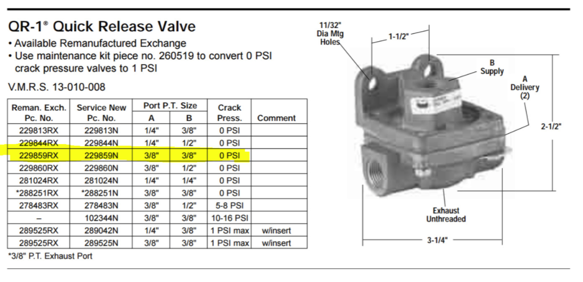

  14. Thanks. I was able to find a replacement for it. It took some time, but the chart below may be helpful to someone else. I used the 229844N for my truck, the yellow was just highlighted on the website I found this.
