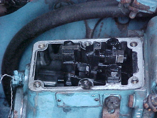

  17. It is definately governor related, my EM6-300 did the same thing until I installed the fuel rack "patch" kit to stop the bouncing at highway speeds. All it consists of is a very light spring and a roll pin in the fuel rack. Jeff
  18. Turning the fuel up can get into your wallet, 3 flats netted me about 3/4 MPG less on a 2000 mile trip last week. But I will say that the dog pulls much better now. Jeff
  19. Looking good, usually my light at the end of the tunnel is the oncoming train Jeff
  20. :bmod1: Thanks Trent. I don't think I'll really have a problem with EGTs or boost, seeing as to how I'm only pulling a 16K 5er. I don't want to soot the trailer up, so I will only turn it up until I see some light smoke. Jeff
  21. Hi all, I'm looking to turn a little more fuel to SuperDawg. Right now it is at factory specs with a EM6300R, the seal hadn't been broken. I want just a little more pulling power. This pump is one that I'm not familiar with. American Bosch, what to do for a little more fuel, no more RPMs. Thanks for any help. Jeff
