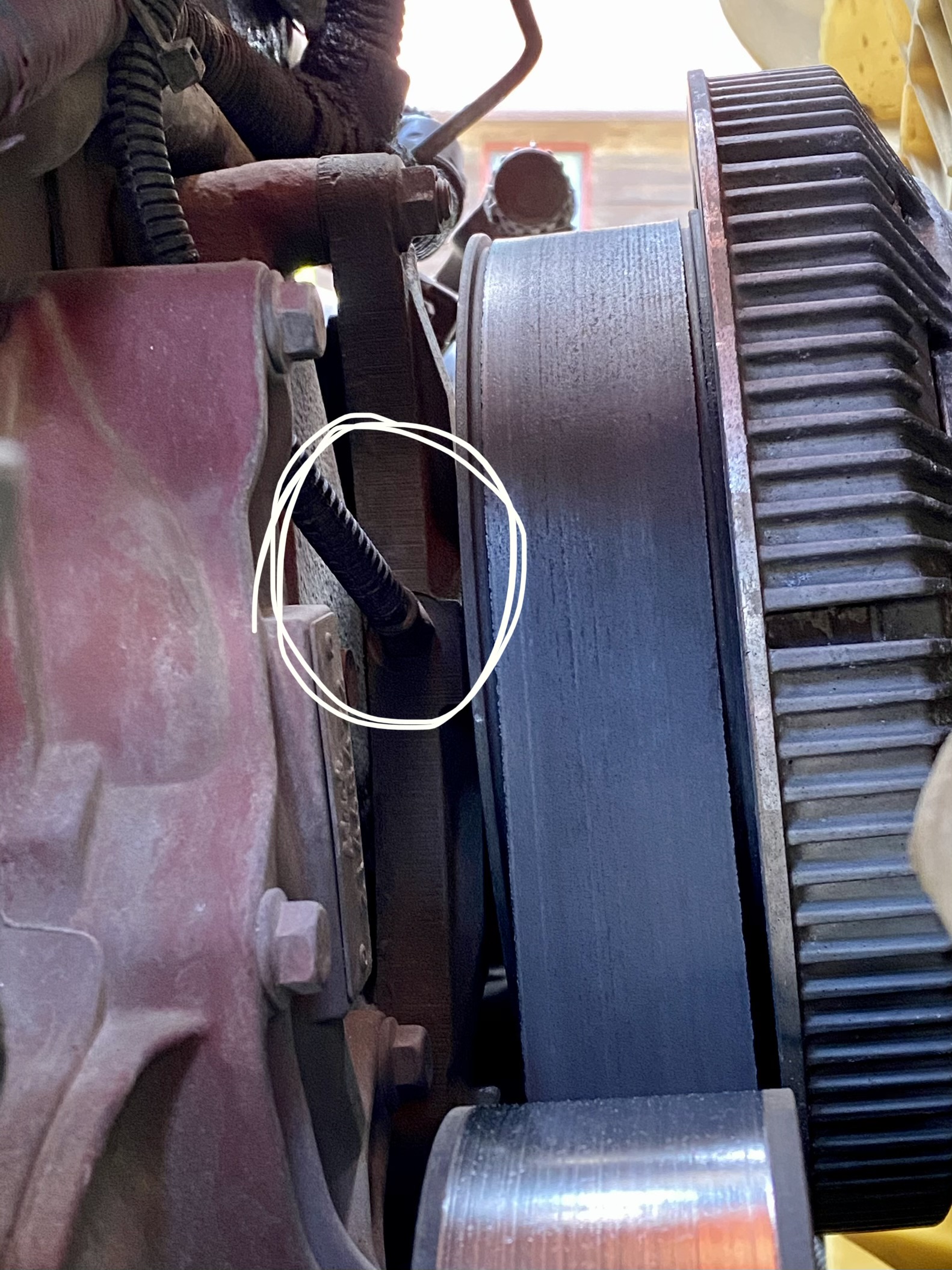

  3. Friend of mine bought a 2012 CXU an he said fan was locked up. He sent me a picture bc I told him I had a electric clutch at the shop. Well this thing isn’t electric, I’m assuming it’s oil.
