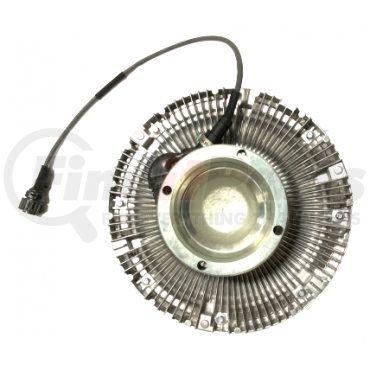

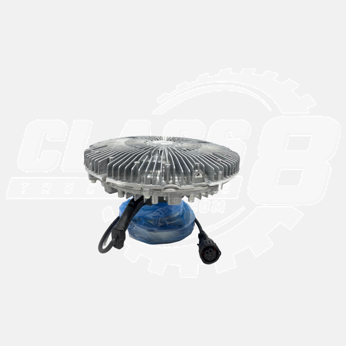

  21. I have two T310 transmission with different part numbers. One is a 11KB105Y and the other is a 11KB75Y. Guess what I’m asking does anyone know what the difference is between the two? Thanks

  23. No it plugs right up. The top one is the new one they gave me, the bottom is what was on it. That bottom one has a long hard plastic stem that goes up to a bracket to keep it from moving side to side. Well the new one doesn’t have it so there nothing to keep it from spinning around.
  24. Yeah I check, I looked an the plug is round for the mp8. I looked up part number an it shows it’s for mp8.
