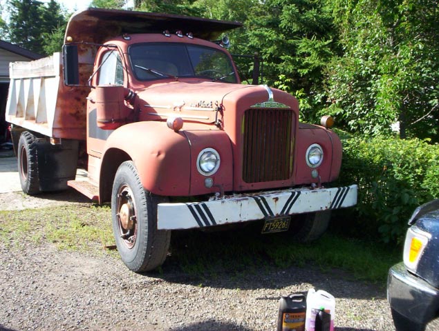

  1. OH this is special...I removed side covers on 401 gas engine to find that the lifter on #4 has fallen out/over...I can feel it up in there,,seems loose, it's laying sideways but can't seem to lift it out..my guess is somehow it broke..That's enough excitement for me! I will either sell this truck or put a liner in the dump box and use it for a hot tub!
  2. Thanks,,I will fog,,pour transmission oil down cylinders and tap at valves through plug holes.. I really don't want to remove head. Fortunately a blizzard rolled through today so I did not start removing head. OT I have been delivering some Mack Pinnacles with Volvo engines and 18 speed automatics,,,the epitamy of laziness for the driver but they work really well,,usually grossing 130k with A-trains
  3. Thanks guys,,yes #1 is at the rad,,,next to number 2,,,seems the problem is stuck intake valves on #2,3,4 and 5,,,looks like the head has to come off,,,tried freeing up # 2 through the side cover but it is really stiff and the rest will be nearly impossible to get any leverage on,,can't believe how much prying pressure to get ér down,,,We had the truck running last summer and pretty dissappointing to see this mess... This whole problem started with pouring gas down carb to start engine,,,,later found carb plugged,,the gas washed all the oil off valves leaving it to rust over the winter,,,Ya ,,,whoa is me
  4. I cannot get 401 Maxidyne gas engine started although timing is correct,,new points etc,,and with the way it is misfiring and will not start it has been suggested possibly #1 cylinder is not at the radiator but is located at the firewall. Does anyone know if this is the case?
