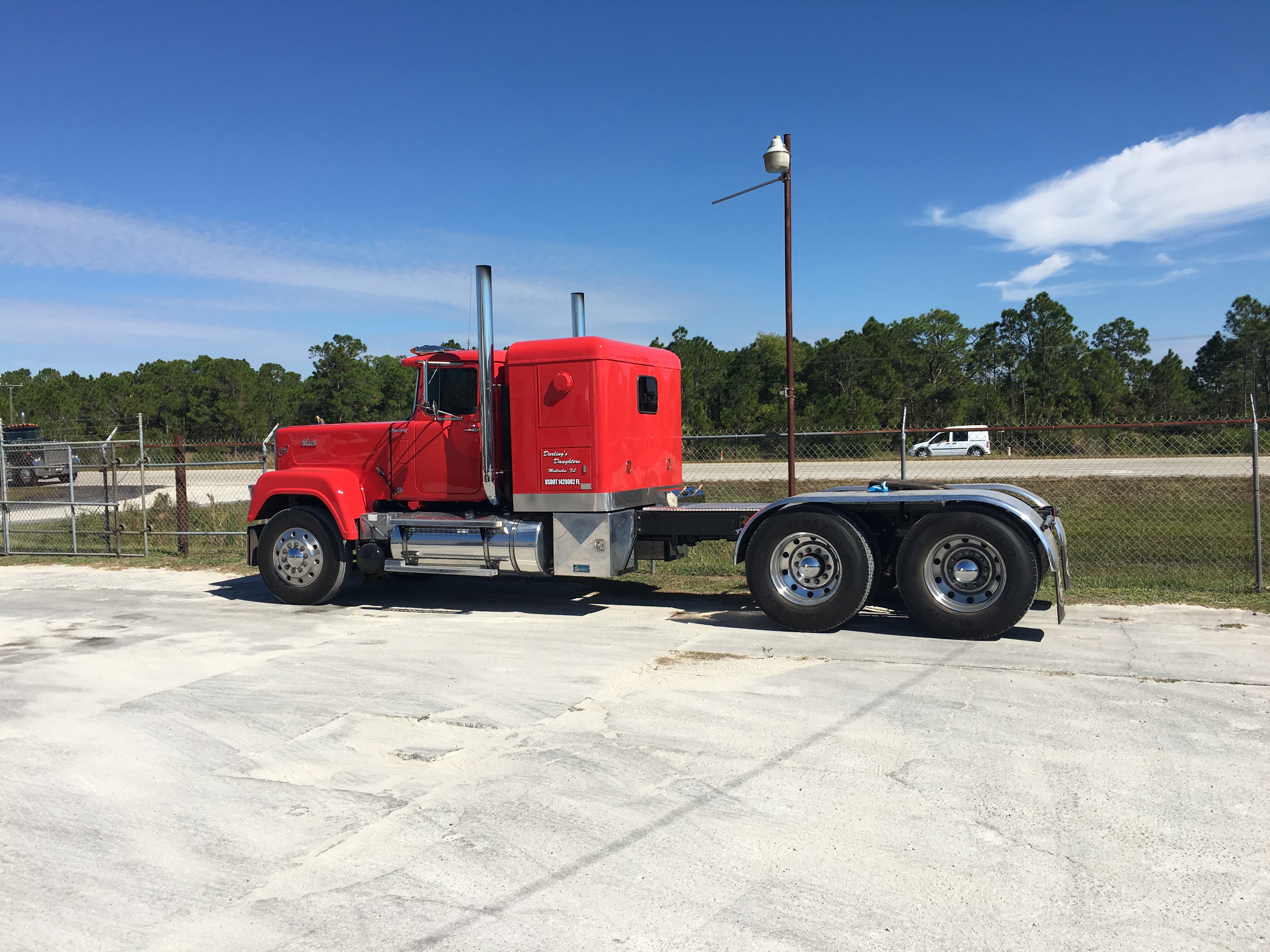

  1. 1989 Mack mh613 Mack e6 350 4 valve engine fuller 9 speed on Mack 4.17 rears with bud wheels. Has pto but I haven't used it so can't verify it works. I bought the truck as a project truck but I'm going to go a different route. $7500 takes it. Contact me if interested 239-410-1662 located in punta gorda FL

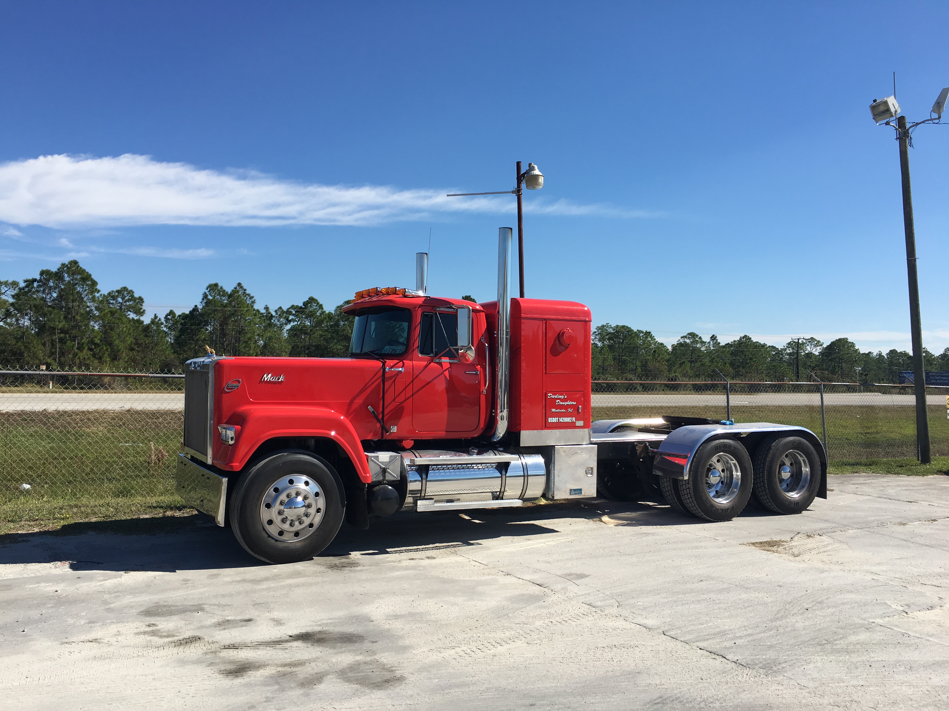

  2. My 1986 that I just finished restoring for 6 months. Actually bought this truck from a member on the forum. I included what she started put looking like.
