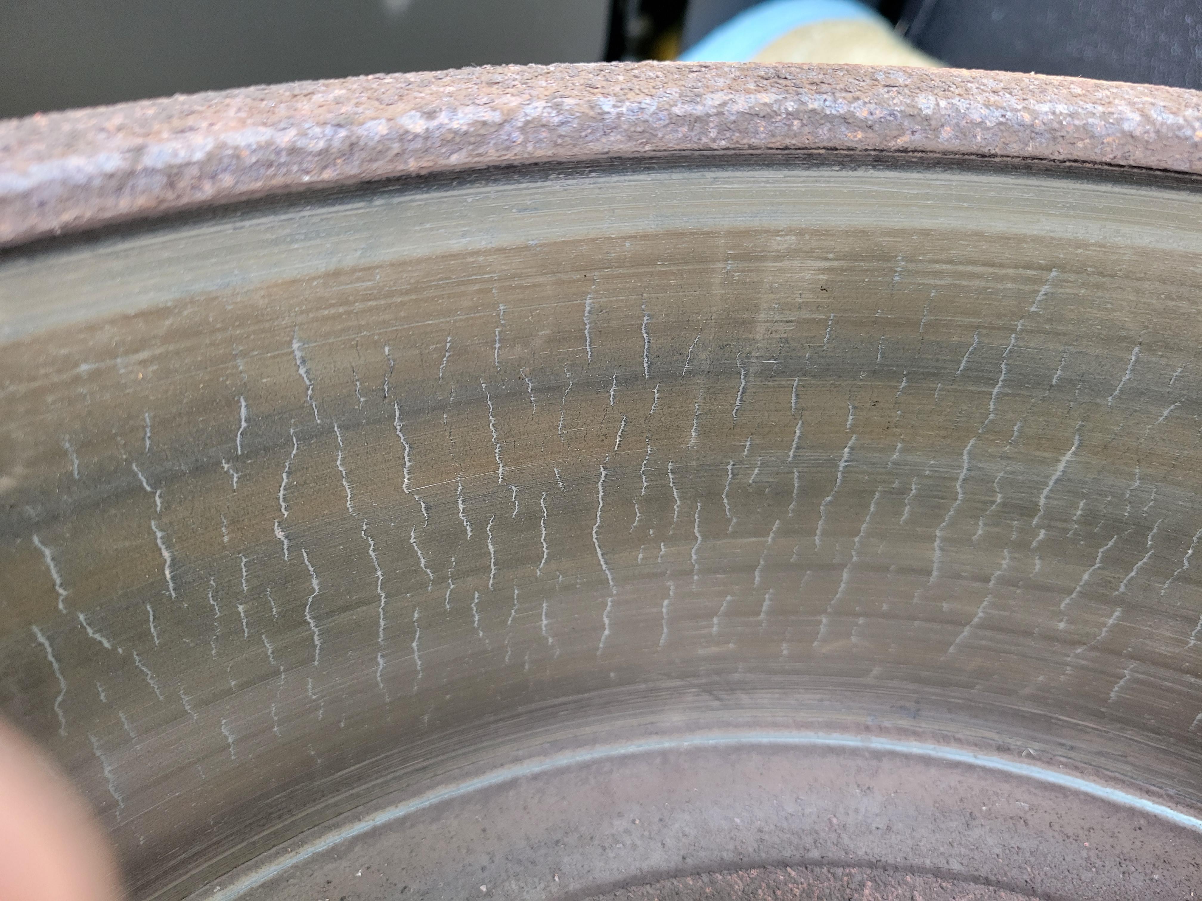

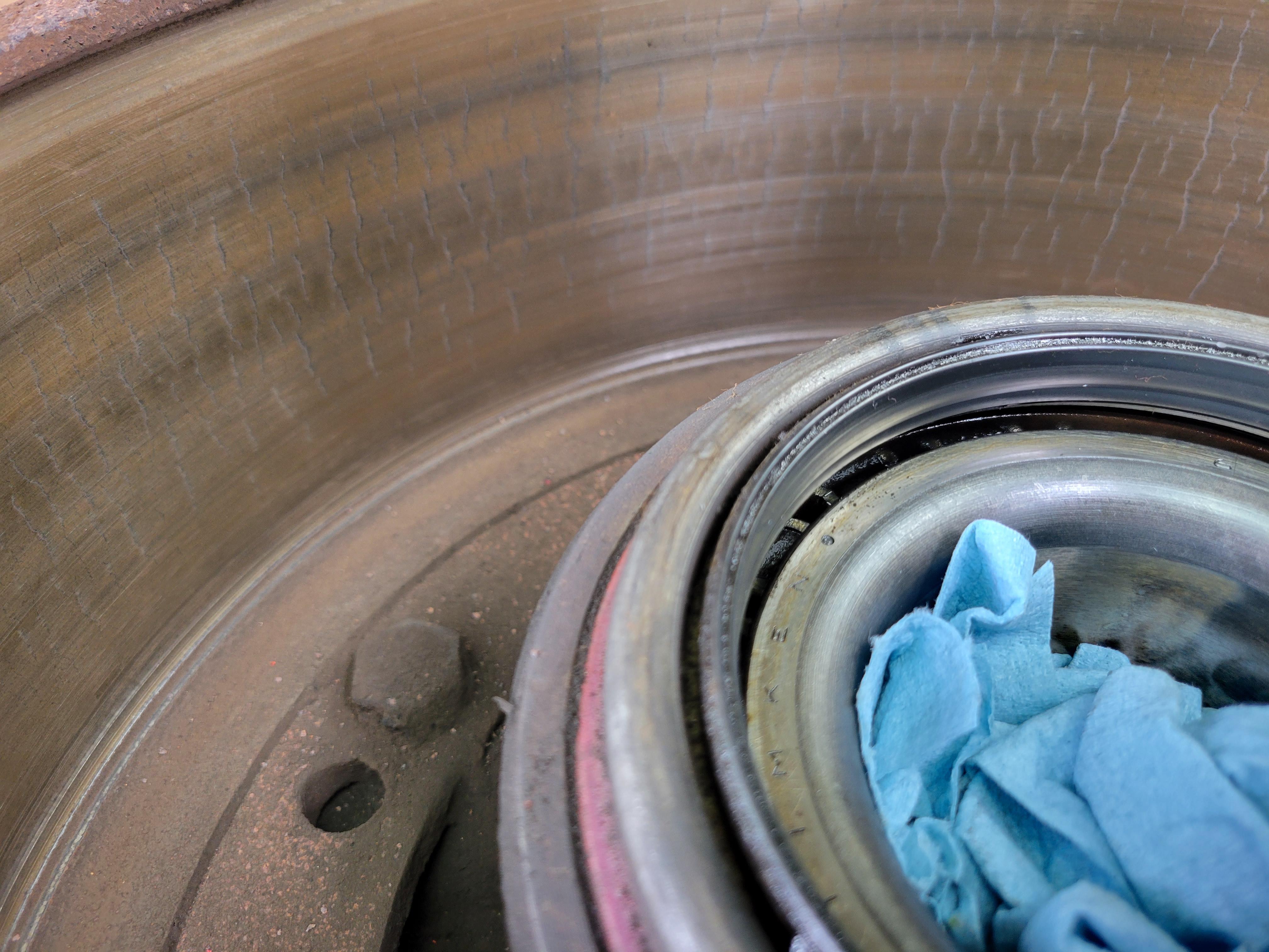

  1. In the attached pictures I have these hairline cracks in both front brake drums. They are still smooth, but regardless have the cracks.. is this critical or are they okay to continue to use? The truck is an antique and is driven about 10-15 times yearly.

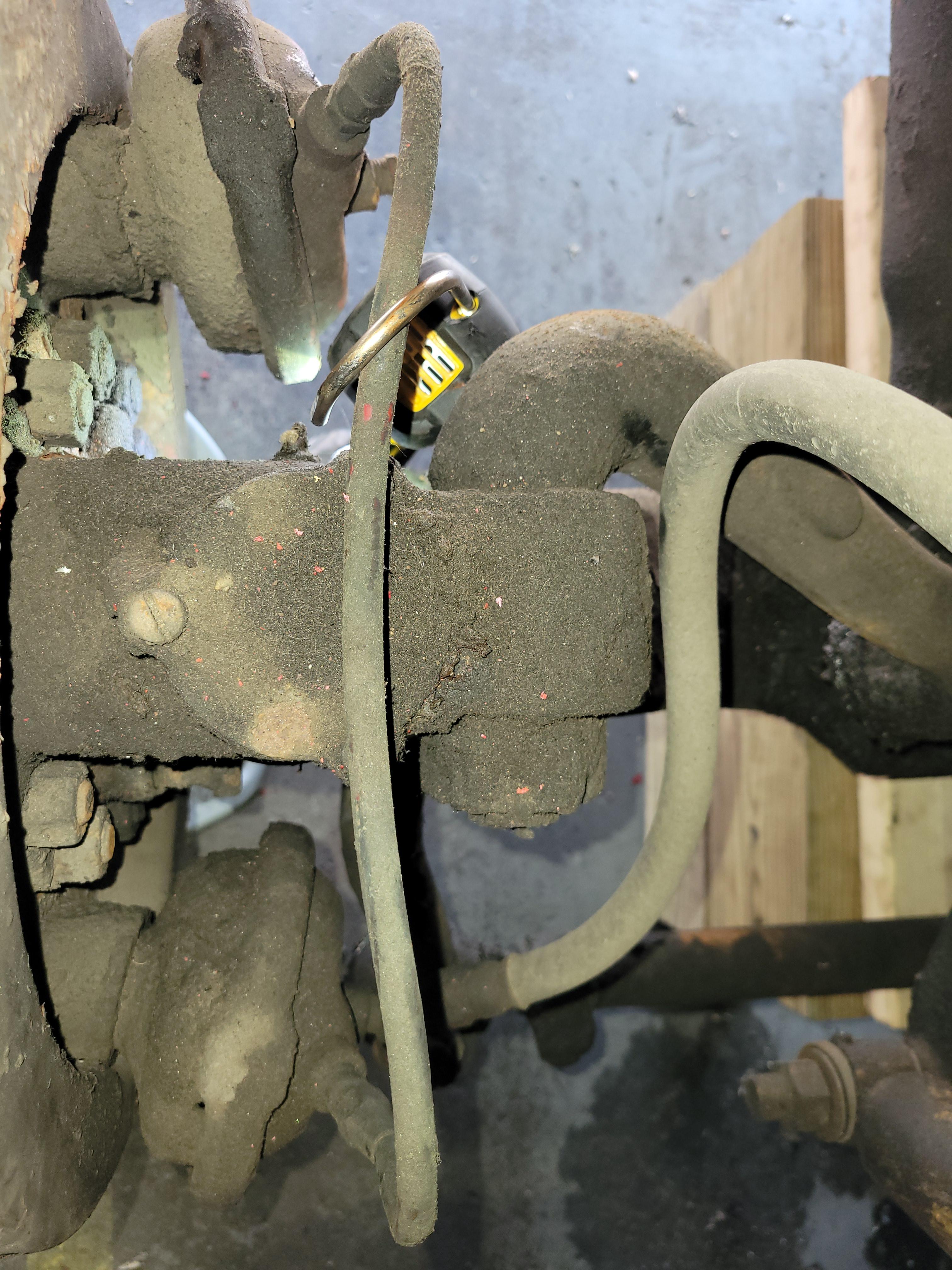

  2. Thanks! How do you back it off? Is there a bolt or??
  3. So the problem is I don't even see a slack adjuster...
  4. Thanks. The front brakes are "free" and the wheel spins. Do I still need to back off the brakes? That might be where I'm screwing it up. If so how do I back them off??
