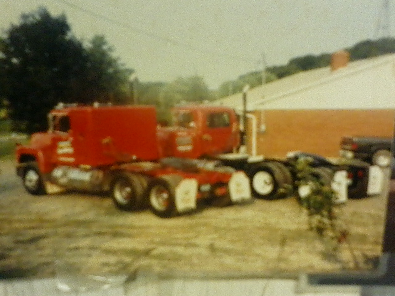

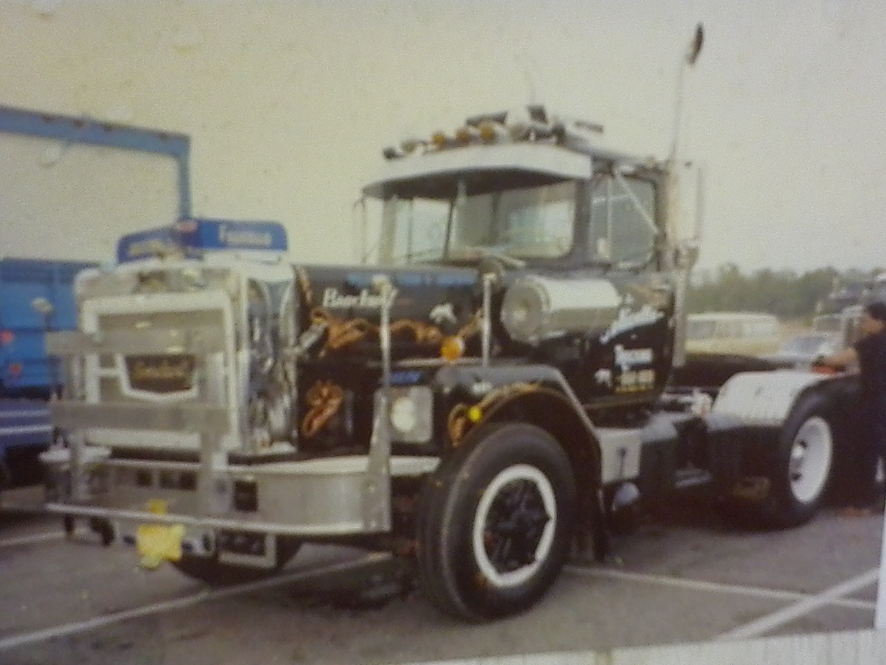

I love the Brockways(360,361,761 and the best762)cat and v-12 total package. Some pics of are old rides.

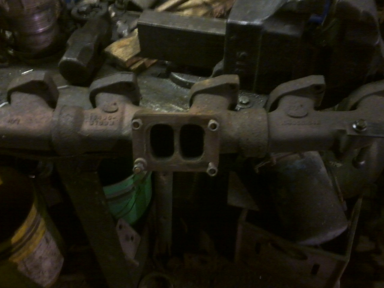

I have a Exhaust Manifold and a Thermostat housing for a M series cabover{garbage truck style}. The manifold may work on a superliner. Part # is 104GC5184M. Housing # is493GB417P2(termostat hou.) I also have a inlet manifold for a RD,CH E-TECH motor equipped. Also have the water pump and housing for the cabover.

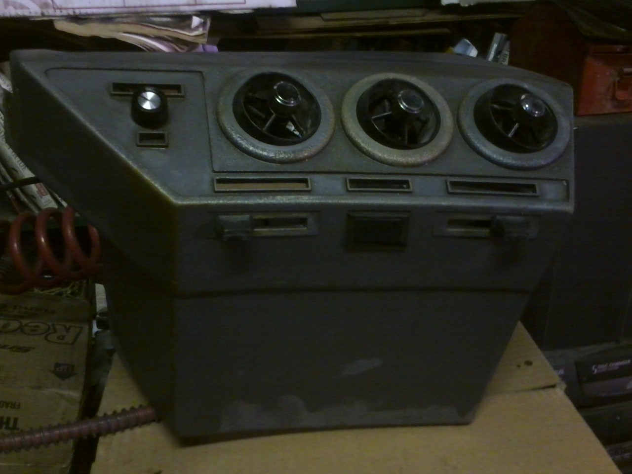

Red Dot cover out of R/Superliner, has 3 round top vents, 2 round on right side, 1 round on left. Color is dark grey,fan switch,2 sliding nobs. i will post some pics tomorrow. has only 1 small crack in one of the mounting holes. Nice used piece I don't know if these are available anymore. I remember they weren't cheap! Make offer.

Yeah me too, a least I have photos and memories of cleaning that truck every weekend for 4 bucks and lunch ha ha, we waxed the paint right off that long, long hood!
yes you were. he sold the 360 somewhere north, I think it was at Cortland painted blue rede frame.
blue/gold when new. then we painted black, nennie painted it green. Truck was bought new buy my uncle Duke, sold to Uncle John, then to Uncle Joe,then to Rossie construction,caught fire, sold back to Uncle Joe. He totally repainted nose and we instaled all new interior,dash,grill,hood,chrome,glass,and lights. guess it was a dash fire. All new parts were bought from thomas LTD in Lancaster,PA. Ran it a couple of years then he sold it to Nennie. Joe also owned the U360 1693cat that he sold to central construction, they painted green{black when joe owned it}.
