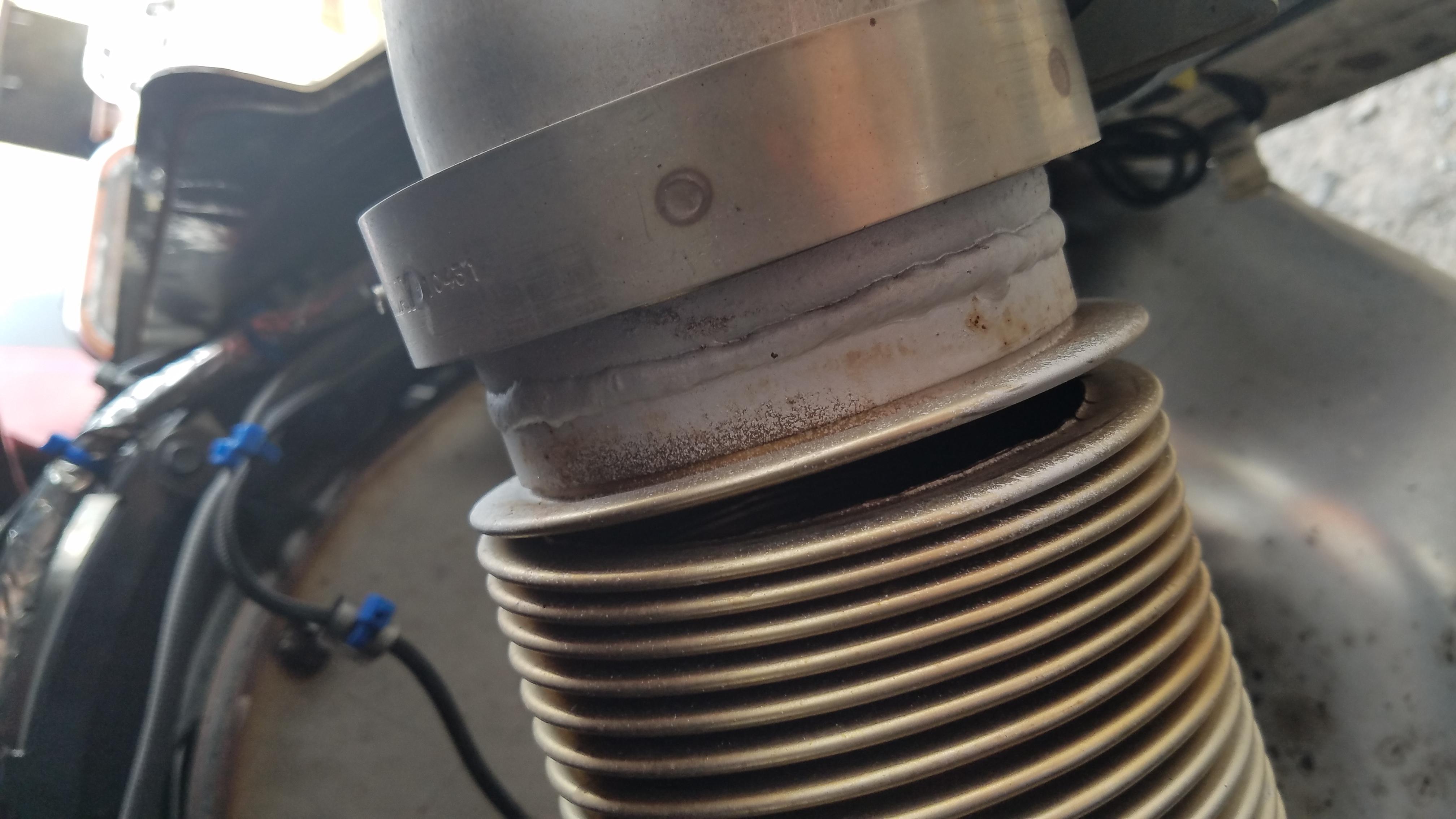

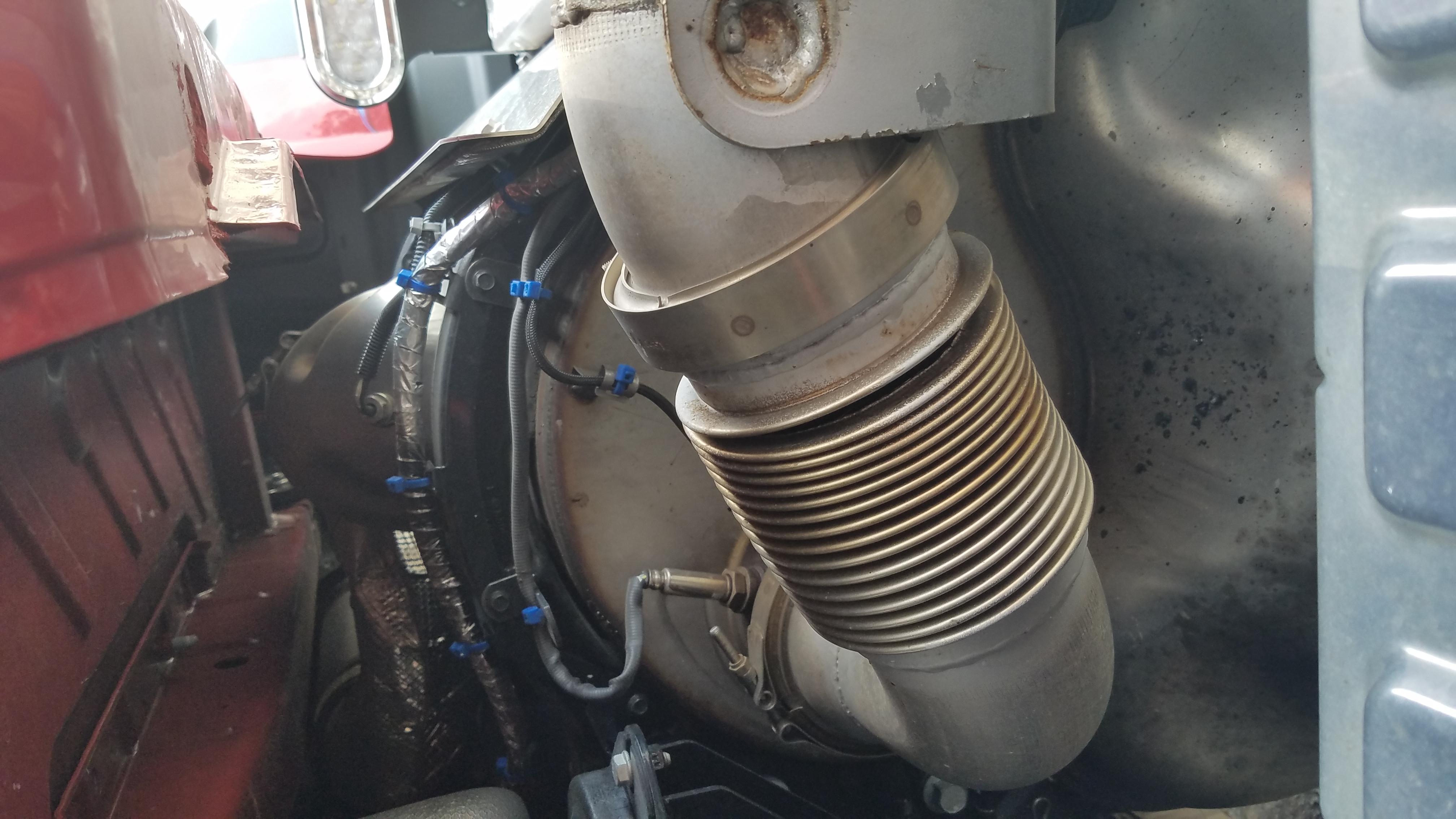

  5. I think I know the answer but want see what you guys think. I have a small leak at the second clamp after the turbo,on the pipe that has t he fuel doser on it. Seems truck won't passive regen no more can this be the reason why ? 2019 granite
