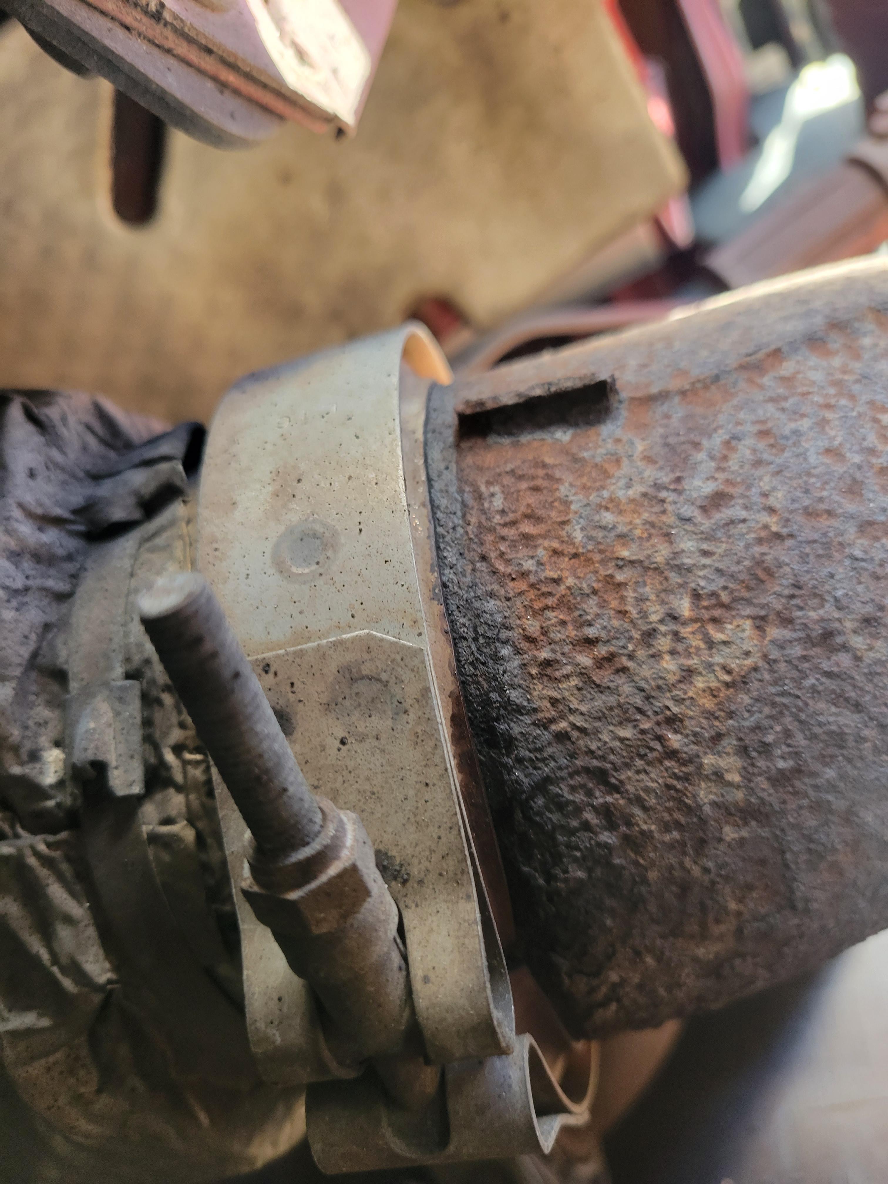

  2. Saw it this. Morning leaking tried tightening clamp was tight is there an o ring or something? And I assume I have to drain antifreeze, stock pic is upside down

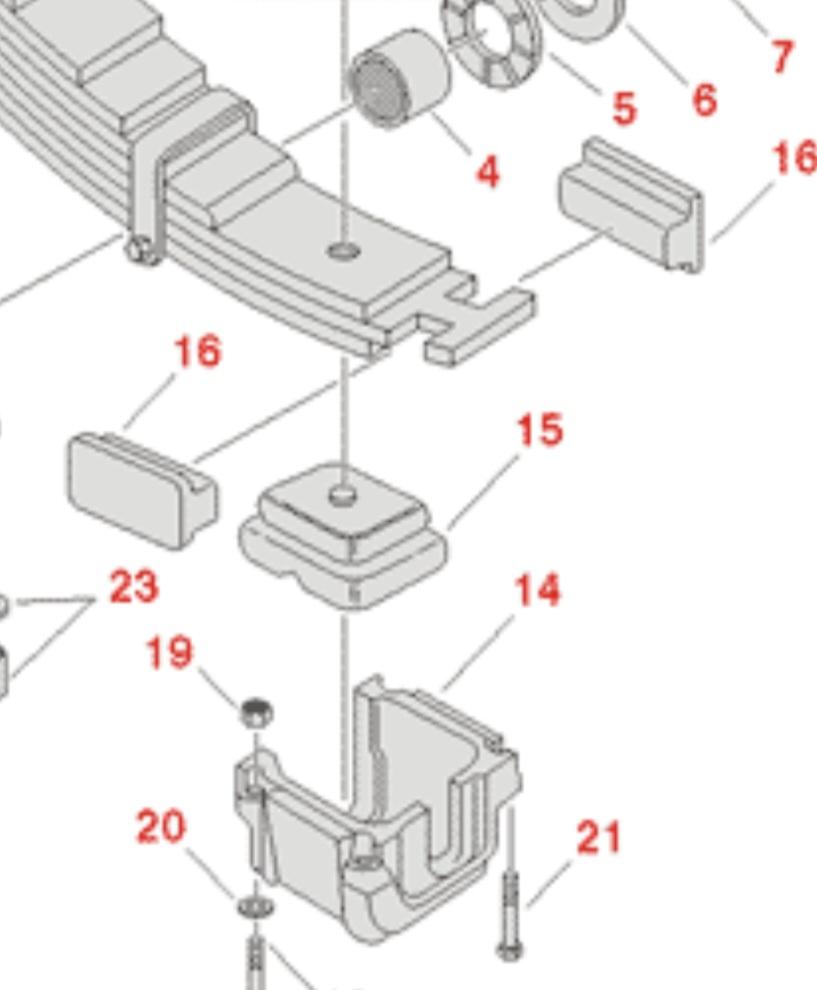

  6. When the truck needs to do the spring pads do I need to put the spacers back ? Number 16 in picture. Those things make the truck play jingle bells since it was new

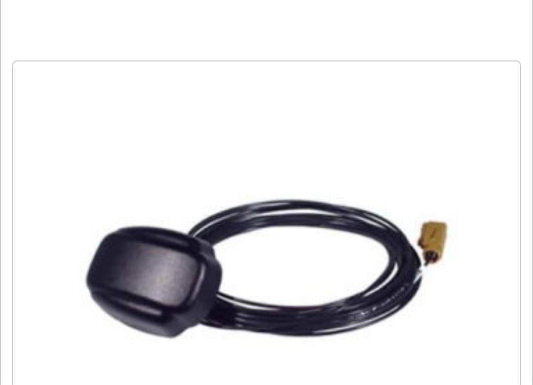

  9. Yes that's what it is. Problem is it's 1 wire no conections from the roof down the pillar thru the dash to the radio. How hard is it to get the headliner down ?
  10. never mind figured.it out xm antenna
  11. Does anyone know what the little roof mounted antenna is for its like 1inch by 2 inch more towards the back. Seems cover broke . See if I can get pictures when back at the truck

  14. I did a aftertreament test with ptt while doing I saw what appeared to be a leak around the same spot where I. Changed the gasket on the defuser. I ordered a new pipe. Gonna change both pipes defuser and bellow pipe . Had to order it

  23. Just an update i changed the 9 dollar gasket an put a new clamp on it . Dpf soot level stayed the same all day while paving. Went home on the turnpike and passive regen brought down soot level. Only way I saw leak was during a forced regen hope this helps someone
