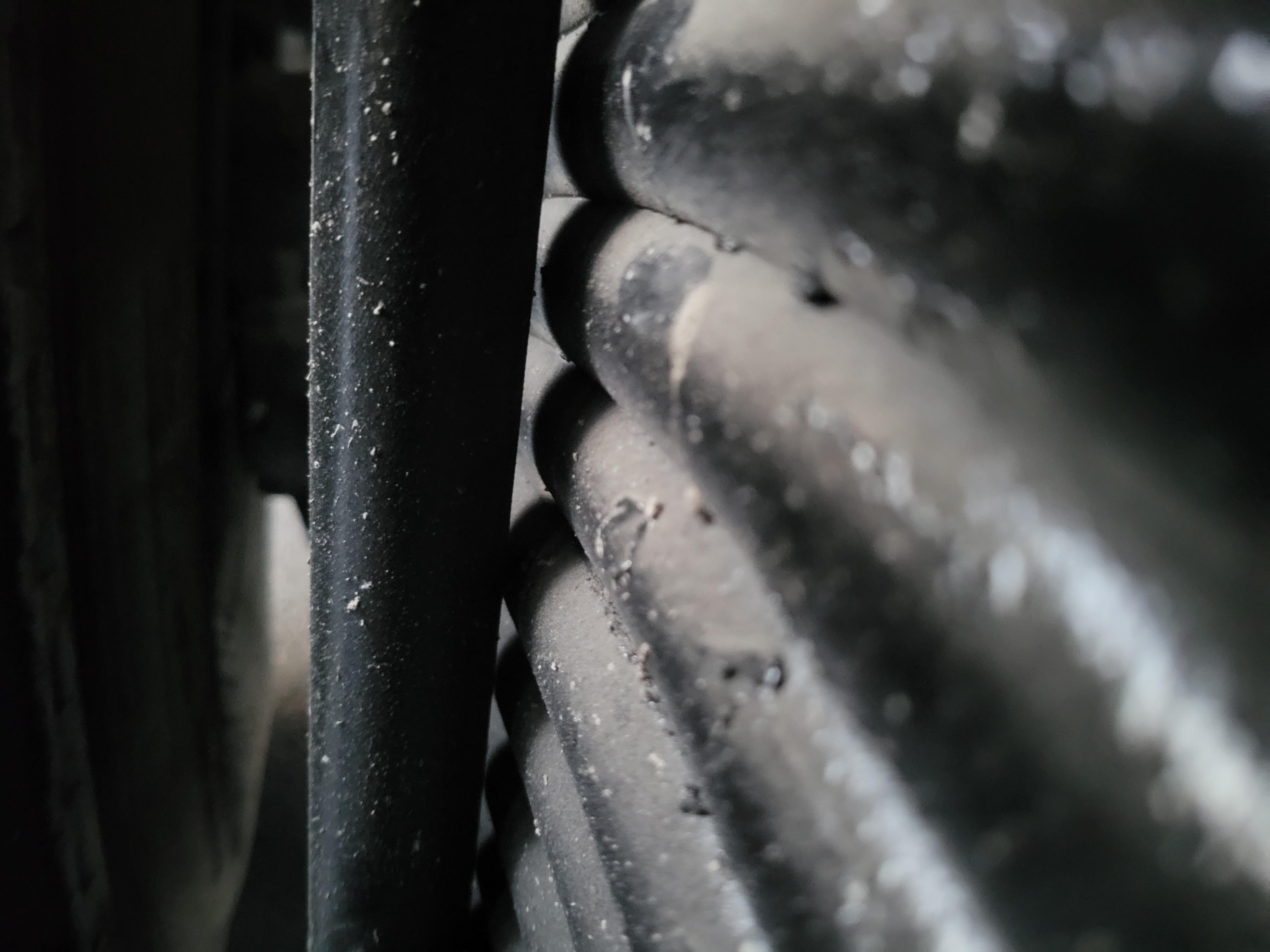

  6. Yeah I thought of that also maybe a shut off valve , seat is a stock seat replaced about a year ago. I tuged on the line I see nothing moving under the cab is why I asked
  7. Yeah I sprayed everything with bubble soap I could see, in the morning seat is down
  8. 19 granite does anyone know how the air line runs to the seat, goes into the plastic behind the seat trying to find a leak i cant hear

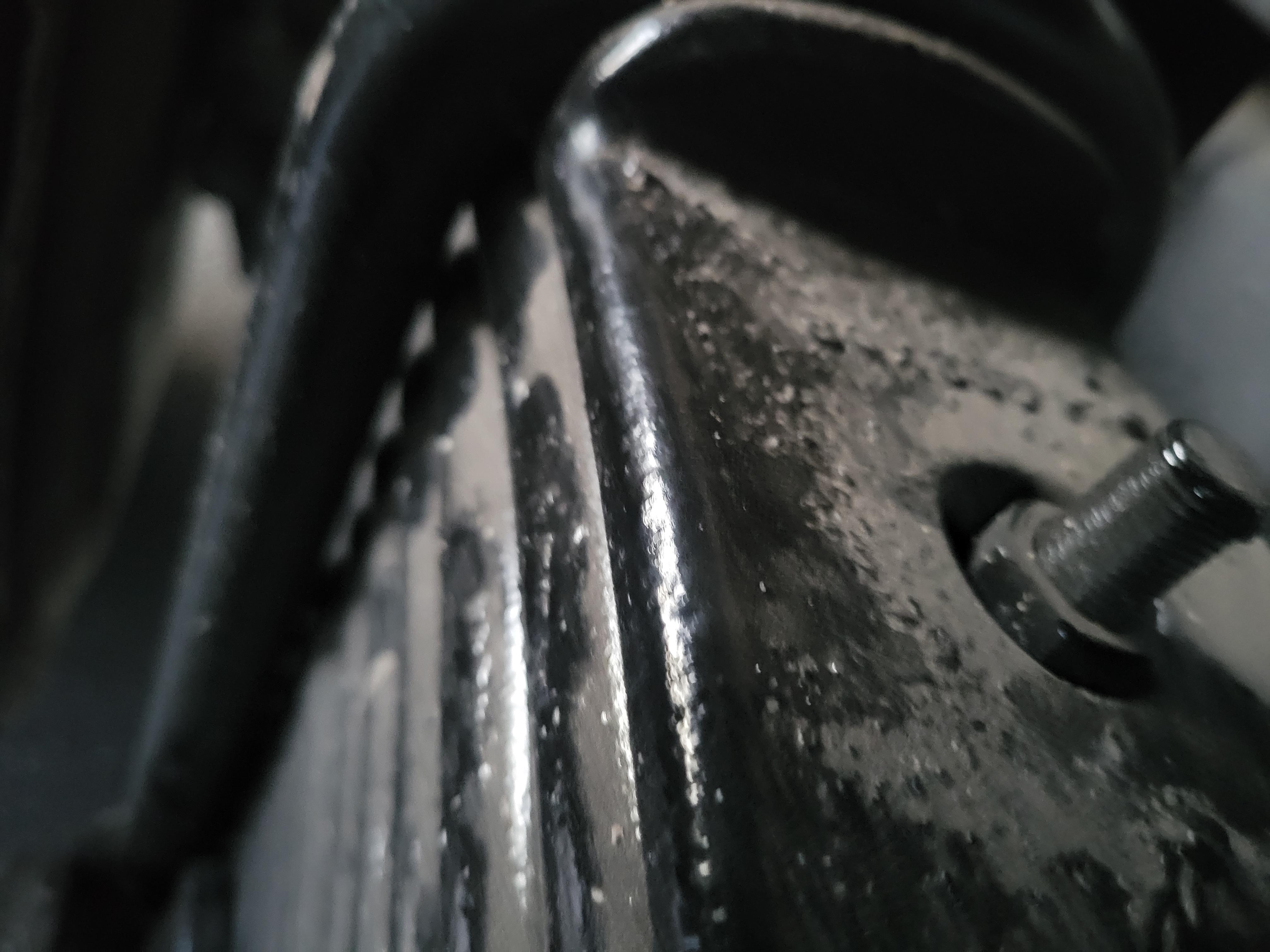

  9. Finally got it installed, $ 3200 , they had to drill the holes in the frame

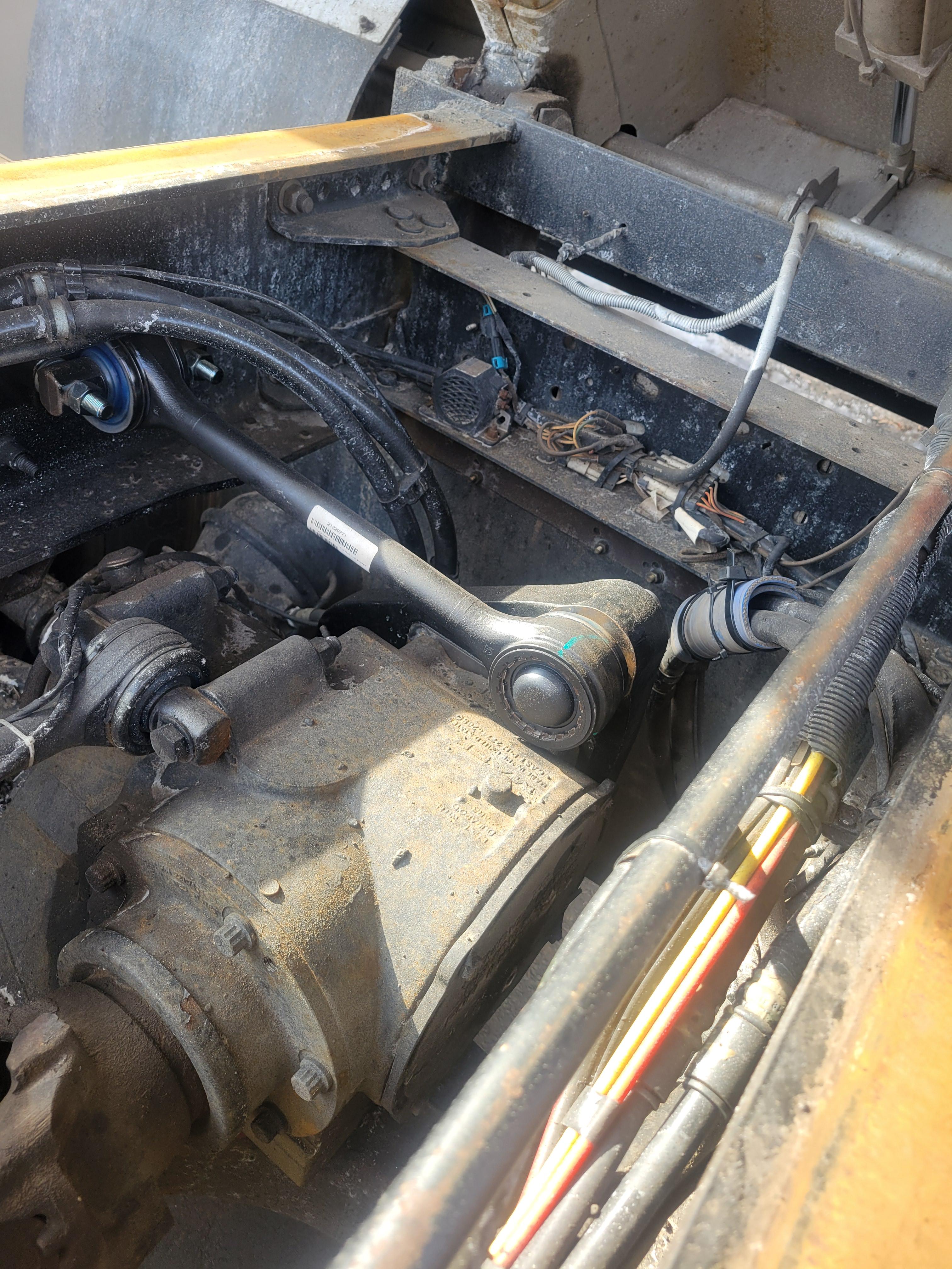

  10. I'm finally getting the transverse torque rod put on mack is ordering parts and will let me know when to bring it in quoted 3200 bucks

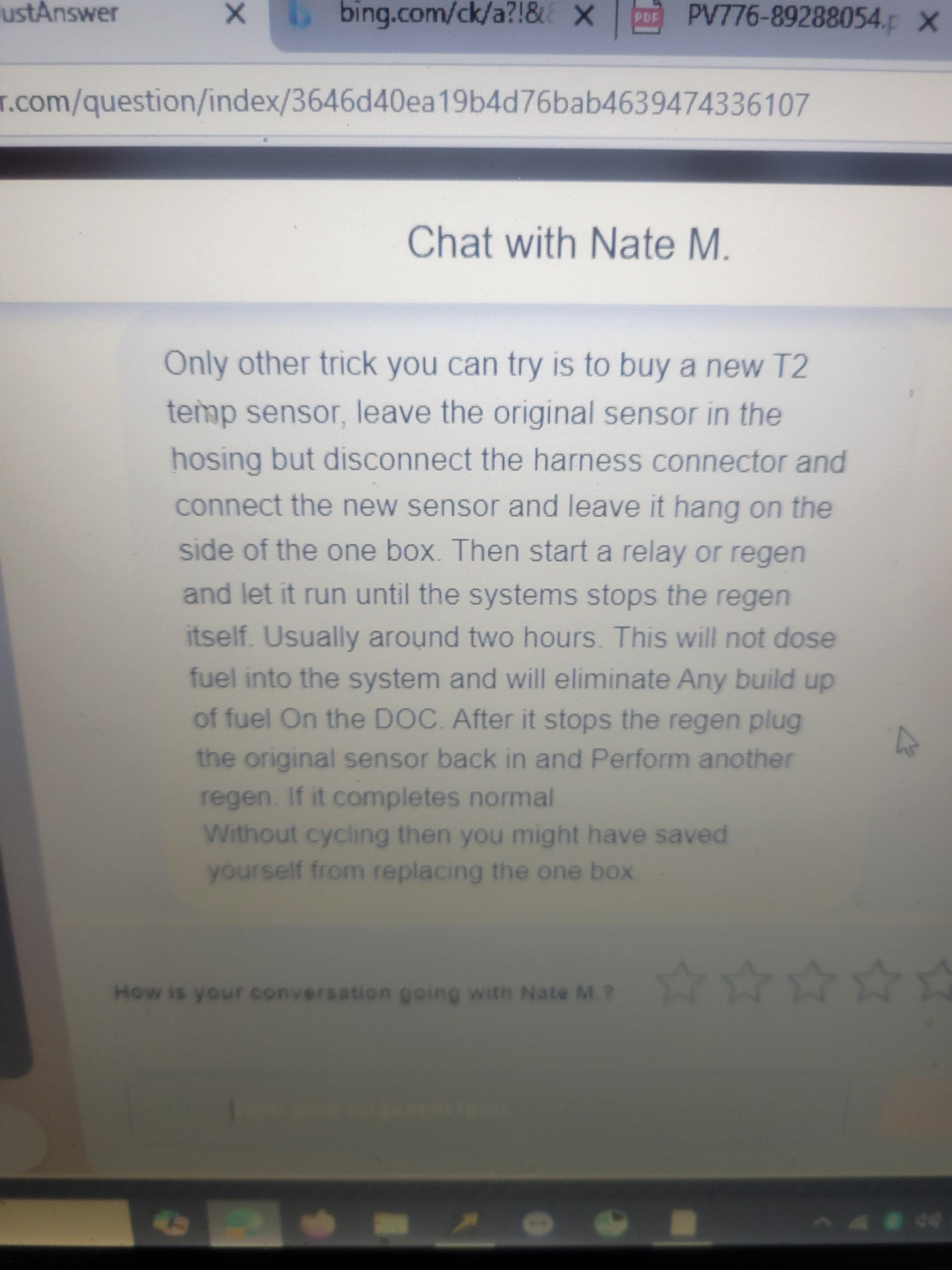

  11. vinny933
    Regen
    I was on a chat with a tech he seems to think it's the doc, he said I could try this trick

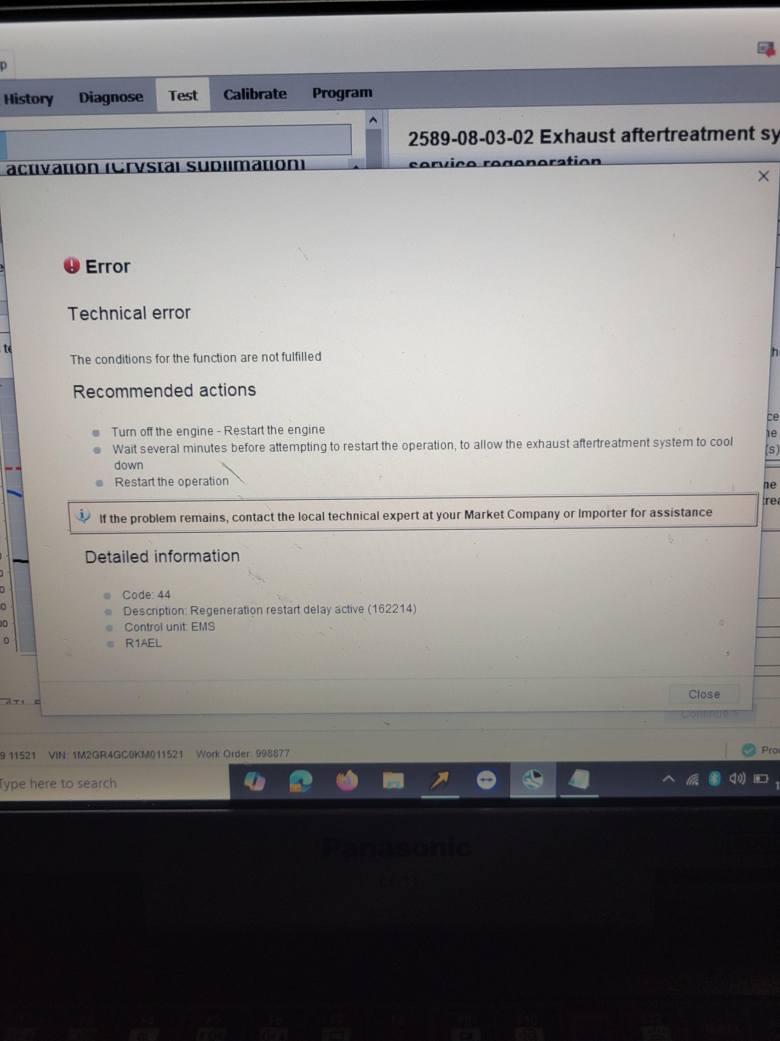

  12. vinny933
    Regen
    Well there was some patches, tried it again today after a little bit at 99% same error. All it's missing it seems is cool down message, soot level reset and all seems fine. I also changed 7th injector. I'm gonna call diesel laptops see if it's them or I need to go to a dealer

  14. vinny933
    Regen
    From what I can google seems like a tech tool problem
  15. vinny933
    Regen
    Forgot to add after I unplugged the computer it said low power
