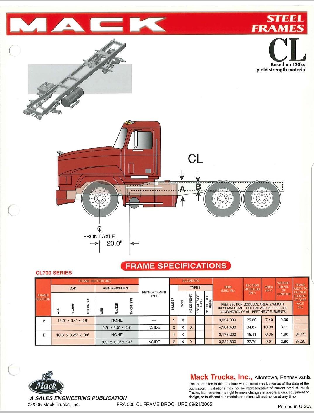

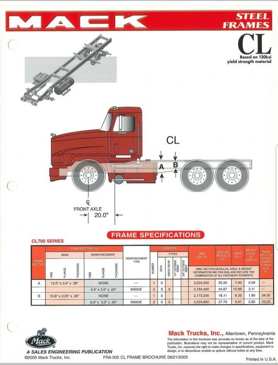

  1. This is the information I received from my dealer
  2. If anyone has available the frame ratings on a CL700 frame? Or a build sheet etc that would be most helpful. Thanks
