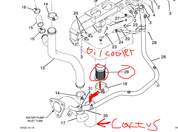

If it is anything like the screens in Cummins engines, they are there to be easily and cheaply replaced, to protect parts downstream that are hard and expensive to replace if plugged with debris.  Remove or defeat at your own risk.
Is it in the EGR cooler line?

The screen on these is under the oil cooler, it runs down towards the bypass hose I call the cactus. I'll paste a screenshot:
