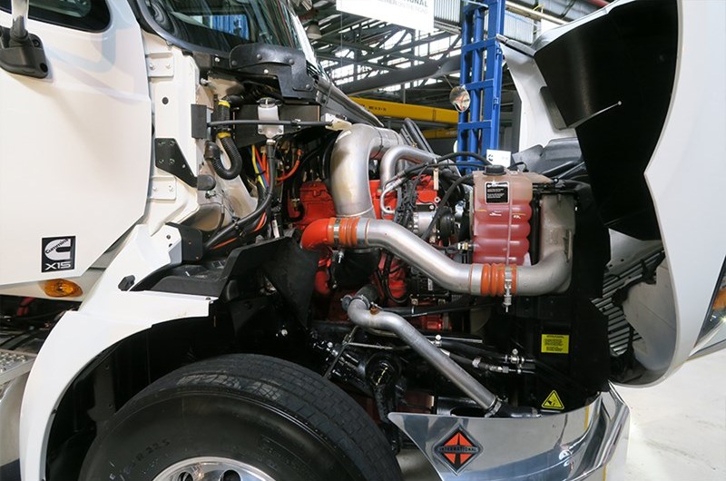

All vehicles will be powered by the latest E5 Cummins X15 SCR engine producing 550hp (410kW) and 1850 lb ft (2,508 Nm) of torque.
It features high pressure injection and the Cummins Emissions Solutions (CES) system to comfortably meet Euro5 emissions requirements.
Cooling is through an ‘Over and Under’ system with CAC above radiator and Horton Drivemaster air operated two-speed fan drive, ensuring optimum performance in hot Australian conditions.
Coupled to the engine is a choice of either an Eaton 18-speed manual with the Eaton UltraShift Plus 18-speed automated manual is optional.

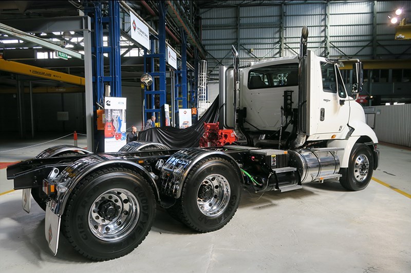

Power to the rear Meritor tandem axles is via a Dana Spicer SPL driveshaft and traction is aided by power divider lock and cross locks on both rear drive axles.
Up front, the models use Meritor MFS axles with aluminium alloy hubs for reduced tare weight while suspension is three-leaf parabolic taperleaf with 6,500kg capacity.
Rear suspension comes courtesy of a Hendrickson Primaax-EX Air Tandem set-up with 20,900kg capacity.

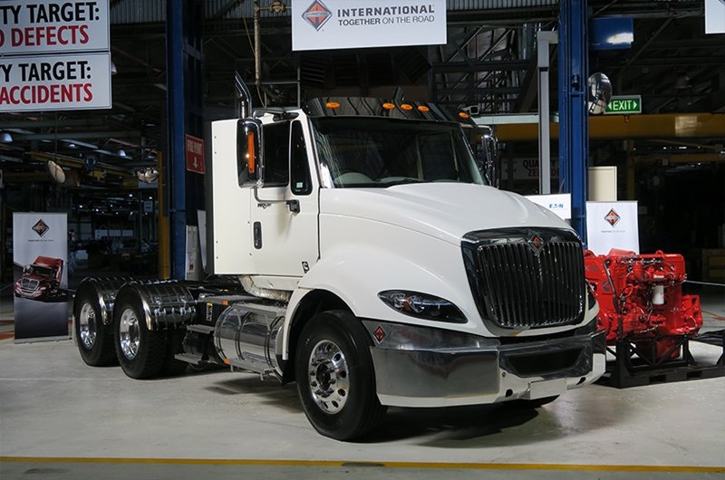

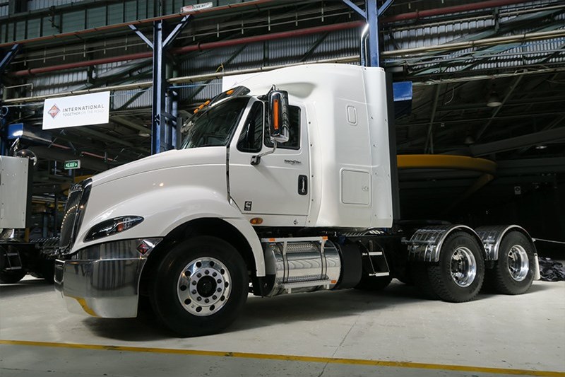

The day cab comes with a 4.3 metre wheel base "which allows you to meet that critical dimension of 5.4 metres from the bumper to the centre of the fifth wheel".
Bumper to back of cab lengths are 112 inches, 138 inches and 141 inches.
The sleeper cab inner-spring mattress is 2170x700mm.
The tipper wheel base is 5 metres and both are said to be suitable for performance based standards.
Gross vehicle mass and gross combination mass are 24.5 tonnes and 90 tonnes respectively.
