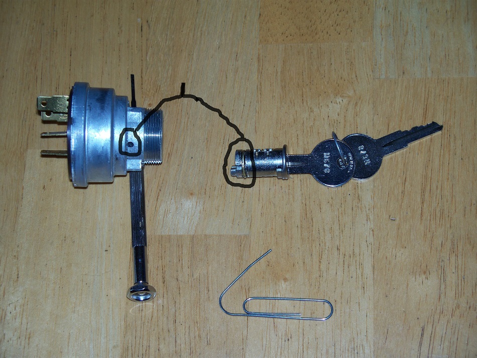

Thought about it and remembered I had a switch on the shelf.
The switch will have to come out of the dash.  It took me several tries to do it sitting at the bench so I think in the truck would be a pain.  So, after messing with it for a few minutes, this is what worked for me.  Hopefully, your switch looks like this Mack 1MR3172P2.
Using a paper clip or mini screwdriver, insert straightened end into hole in the switch body while the key is in the accessory position and push in toward the cylinder.  There is a spring loaded brass collar that needs to be compressed.  If the brass collar is fully depressed, it will allow you to gently pry with a mini screwdriver the cylinder out of the switch body.
Jim
