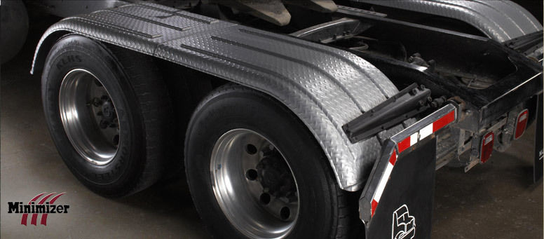

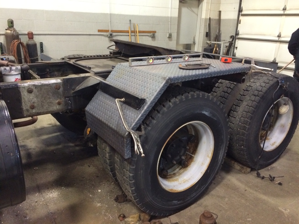

I like this kind of diamond plate look. What ever style I end up with will most likely be fabricated as I don't want chrome or plastic and those seem to be the only options to purchase. In building a set what kind of clearances should there be to avoid tire rub?
What are the advantages and drawback of each type (1/4 fender, 1/2 fender, full fender) and what type trailers are generally used with each?

We usually run half fenders on our trucks. They will pretty much keep stuff off the cab, even pulling a lowboy. We would run full fenders but our drivers just tear them up, they are bad enough on the 1/2.
1/4 fenders are about worthless.
