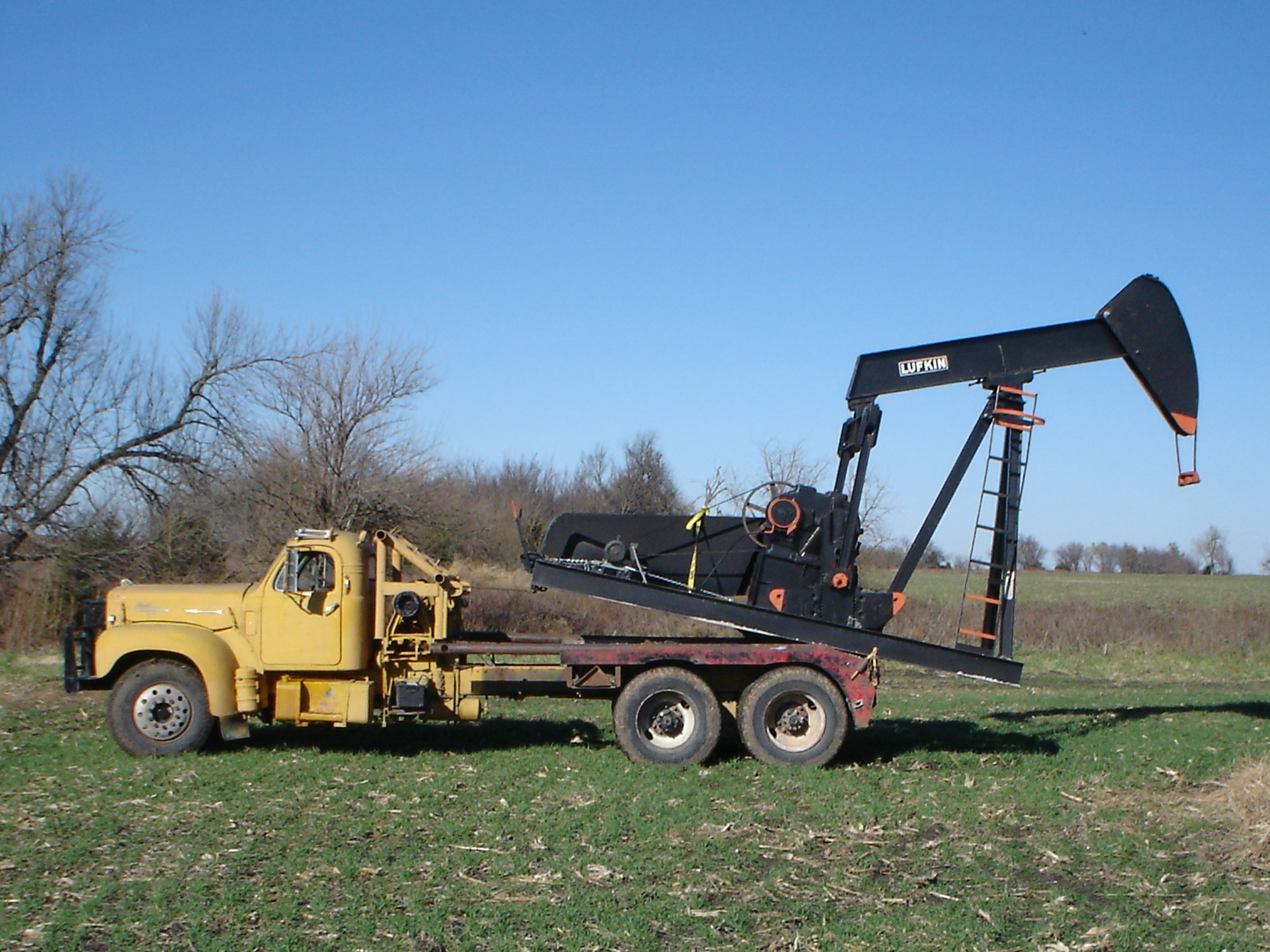

post-1319-1172706810_thumb.jpgpost-1319-1172706810_thumb.jpgHi guys yes another new B model fan I bought this 1965 b73.
when I got it it ran but needed alot of work it was rigged as a winch truck at tulsa mack tulsa ok In the floorboard was a parallel switch which until I found this site I had not a clue what it was.
I rewired the truck like my 85 R mod. It is equiped with a cummins motor the only numbers I could find on the plate was hand stamped 265 ? Is that hp or engine # it does have a turbo and exterior injector lineson the left side of motor. It starts fine.
Was it 12/24 do I need to put the par switch back in? :wacko::wacko:
If it has an S/P switch, but it isnt hooked up don't worry. The S/P switch took 2 banks of 12 volt batteries and put them in series for 24 volt starting. The whole rest of the trucks wiring is 12 volt so no worries if it was converted to 12 volt start.
