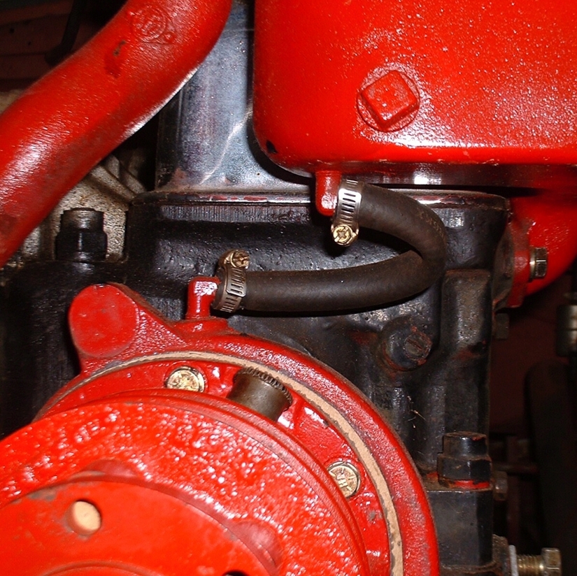

on my '47 LS-85 with a 707 that 1/8 inch line from the water pump to the thermostat housing is called a water pump to water manifold bleeder. j.j. :thumb:

I think I may have told you wrong on where the line goes.
If it is what twostick described above I do have that line on my engine but it is rubber, on down the radiator line coming out of the pump is what I thought you were asking about and it is what I described to you as being plugged.
I will take a picture of it when I get back home after work.
David
Is this the line you are asking about? If then it is what Twostick told you.

Thanks for the help. I have been away not near a computer. My line is metal not rubber. Surely it must be plugged. What is its purpose? Your pic is correct.

I am not exactly sure what it does but it is some sort of pressure relief line, I am thinking for when the system is shut of from the radiator maybe.
