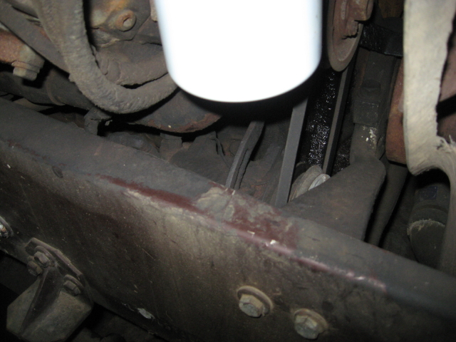

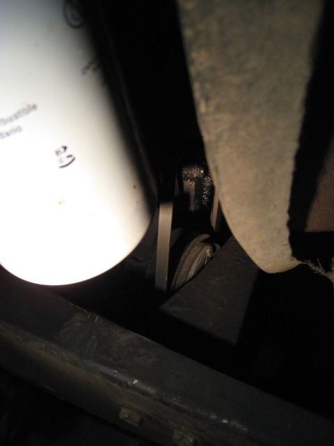

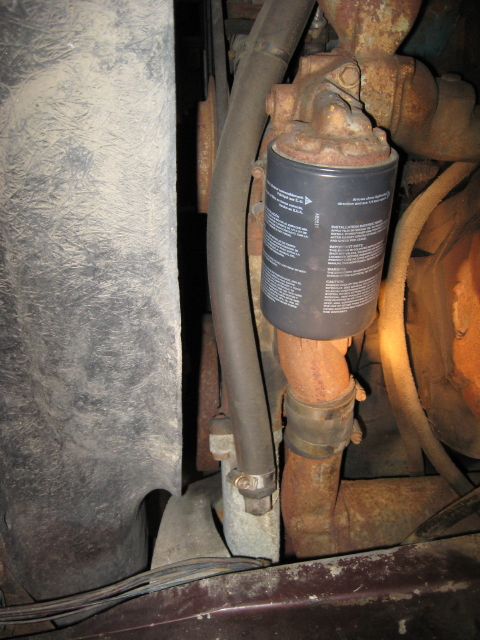

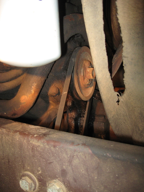

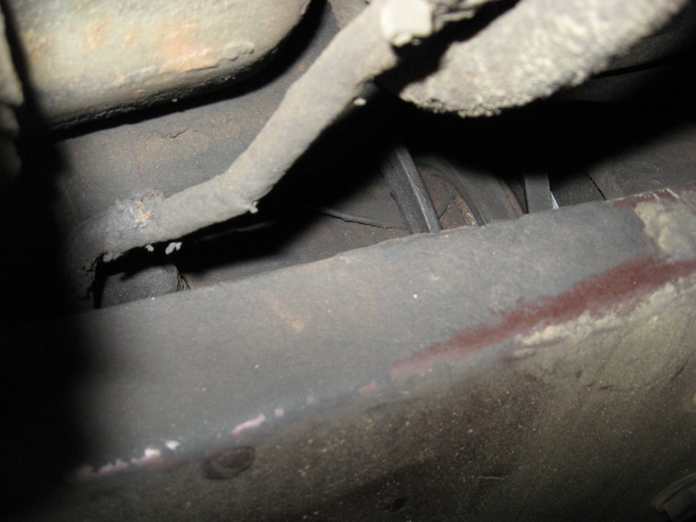

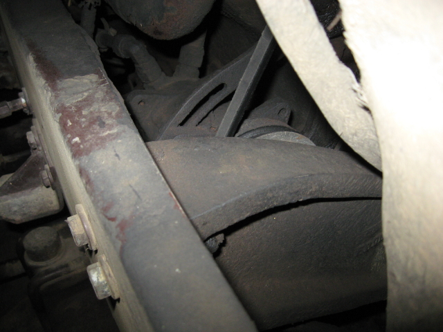

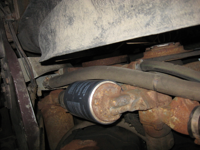

Hi Grant, I told you wrong on the A/C drive. The 866 engine drives the compressor from the auxilary shaft on the rt. front of the engine. I confused trucks......
Here are a few photos. Also the heater hoses pickup on the discharge, and inlet housing of the water pump. You can see this in the photos also.
Rob
Rob
