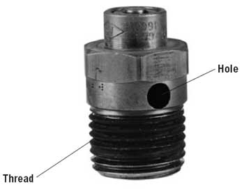

You are looking for one of these on one or more of your air tanks. But your real problem is still the air governor. Even if the relief valve is working, your air governor is not, you still should be carrying no more than 120-130# air pressure.
The pressure relief valve should only relieve the pressure when it gets into the 150 psi range, which it sounds like maybe it is working.

Ok thanks for the info. Did not see it until I just came in from installing the relief valve which of course from your explanation did no good, which it didnt. I will look for the part that you have pictured, but where would the governer be. I am thinking I might see it under the cab, could that be where it is? If so, I dont know how I am going to get to it.
