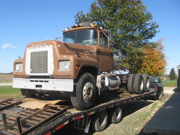

After one and a half years arguing back and forth with the Illinois Secretary of State bonded title division, I finally have a title for my 74 RL797LST. This is the truck I cut the roof from almost a year ago and was proceeding rather nicely until this ordeal was evident to be a drawn out affair. I then stopped work, backed the truck into a corner, removed the batteries and let it sit in place.
Now maybe I can get it wrapped up. This one is just going to be an average repaint with no restoration type work taking place. Once I rebuild some of the inner roof supporting structure and put a new skin on, it can go outside as the truck is still complete.

Hi Mark, this is my third 700 series truck and it has an ENDT866 engine with a Mack TRDL107 transmission, with Rockwell SQHD rears. Nothing really wrong with the truck itself except that it has wedge brakes on the front and rear. They work perfect and were rebuilt just before I received the truck. The roof was rotted off of it from sitting under pine trees derelict for many years.
This truck was a California truck all it's life and was a transfer dump unit. I've spoken with the original owner who used it in that capacity for many years. It was traded in on a different truck so really hasn't worked in a lot of years. Subsequent owners scrapped it in California, (on paper) without anything actually happening to the truck. My understanding is California offered a premium payment for getting the older "less efficient and heaven forbid, "dirty"" trucks off the roads. It was purchased by a gent in Minnesota with plans for a restoration but seven years later I found it via a friend. After my acquisition, the troubles started; California informed Illinois the truck was scrapped, Illinois wanted to issue a junking certificate rather than a title. After many photos, enlistment of outside sources for appaisal value, inspections by state police, and numerous other obstacles, they issued a title with the exception it could never be titled again in California.
