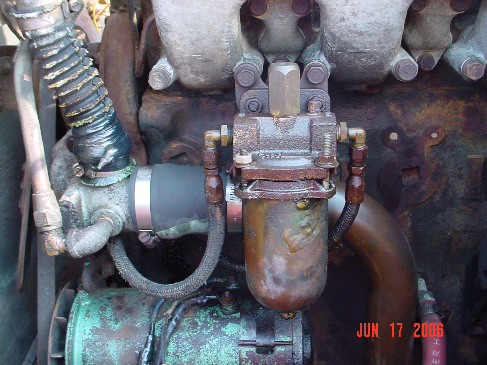

The large diameter filter has 2 large lines coming in from the bottom. There is a second smaller Purolator filter with a bronze screen and wiper that has 2 small lines feeding it. Attached is a pic of the smaller filter. This one I was able to clean up and solder the outer canister where it was cracked. Trying to find a new oring for the canister seal now.
