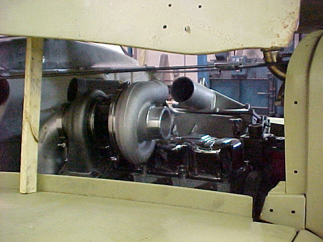

  2. Hey y'all, Thanks for the compliments, I don't post a lot but I do appreciate the support. I have to custom make all of the exhaust from the turbo back because I moved the engine back 2 inches and am using a different manifold to mount the turbo, therefore no store bought stuff will work. I have a question about muffler location. I mocked up the exhaust this morning and in my infinite wisdom I thought it would be nice to tuck the exhaust and muffler a little tighter to the cab. I'm quite sure that originally the exhaust needs to be out far enough to help clear a trailer. Is this right? But it also seems too far for a truck that may never have a trailer behind it. Other than burning the paint (it's not that close) are there any objections that I might be unaware of? Does it look weird? Any and all opinions welcome. Thanks again, Jim Thelen Assembly dept. mgr. PAI Industries

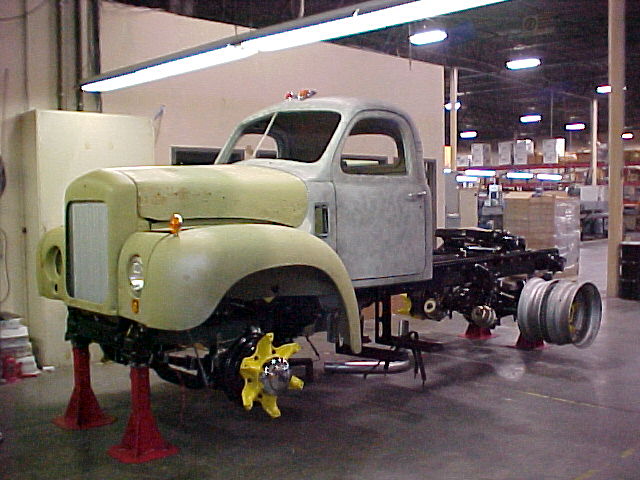

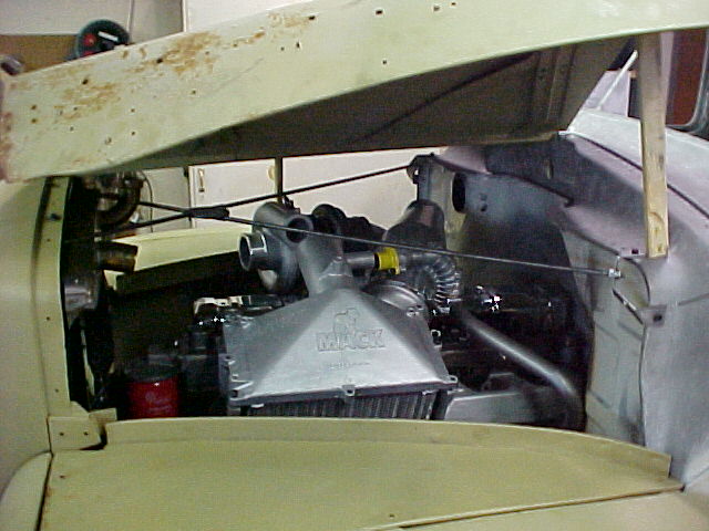

  4. Hey everyone, It has been 4 years since I started this project so I guess I better step it up, although at the same time I do have my daily duties here in Manufacturing. I told the powers to be that I can have it finished by Christmas 09. Ought to be interesting to say the least. Here are a couple more pics for the album. I do have the brakes done (plumbed like a CH) and the EMC6-250 is under the hood and everything fits pretty good. The front sheet metal will be going to the body shop next week for straightening/priming and I'm planning on final paint around middle of May. I'll try to keep my album updated with pics when I have some worth showing. See ya, Jim
  5. AHHHHHHH the B-model project. Well it's coming along ever so slowly but it is progressing. Moving the engine back for the A/C pulley created a clutch linkage problem that I thought was going to be a permanent nightmare. As it turned out though it was quite a simple problem to overcome so that's taken care of and I'm moving along, I'll keep ya posted. Thanks for asking Rob, Jim
